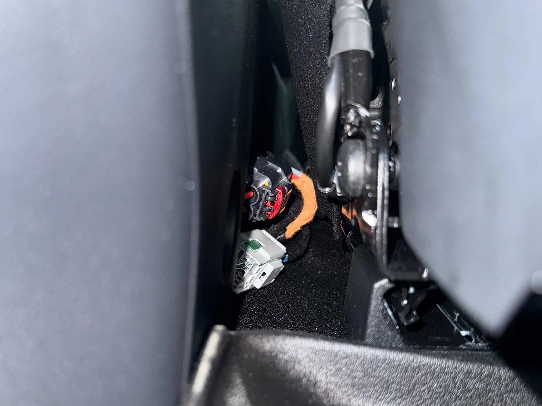

Thank you !!!! I'll check that cup holder area next. I did find two harnesses really close to the center console by the passenger seat, i'll put something in there to isolate those if i can get my fat hand in there lol
