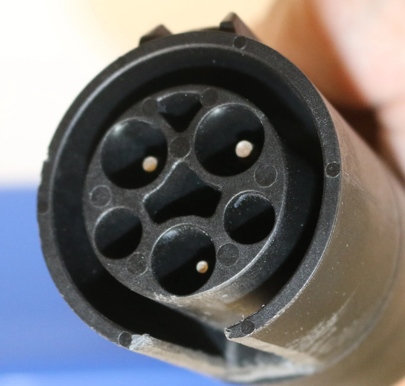

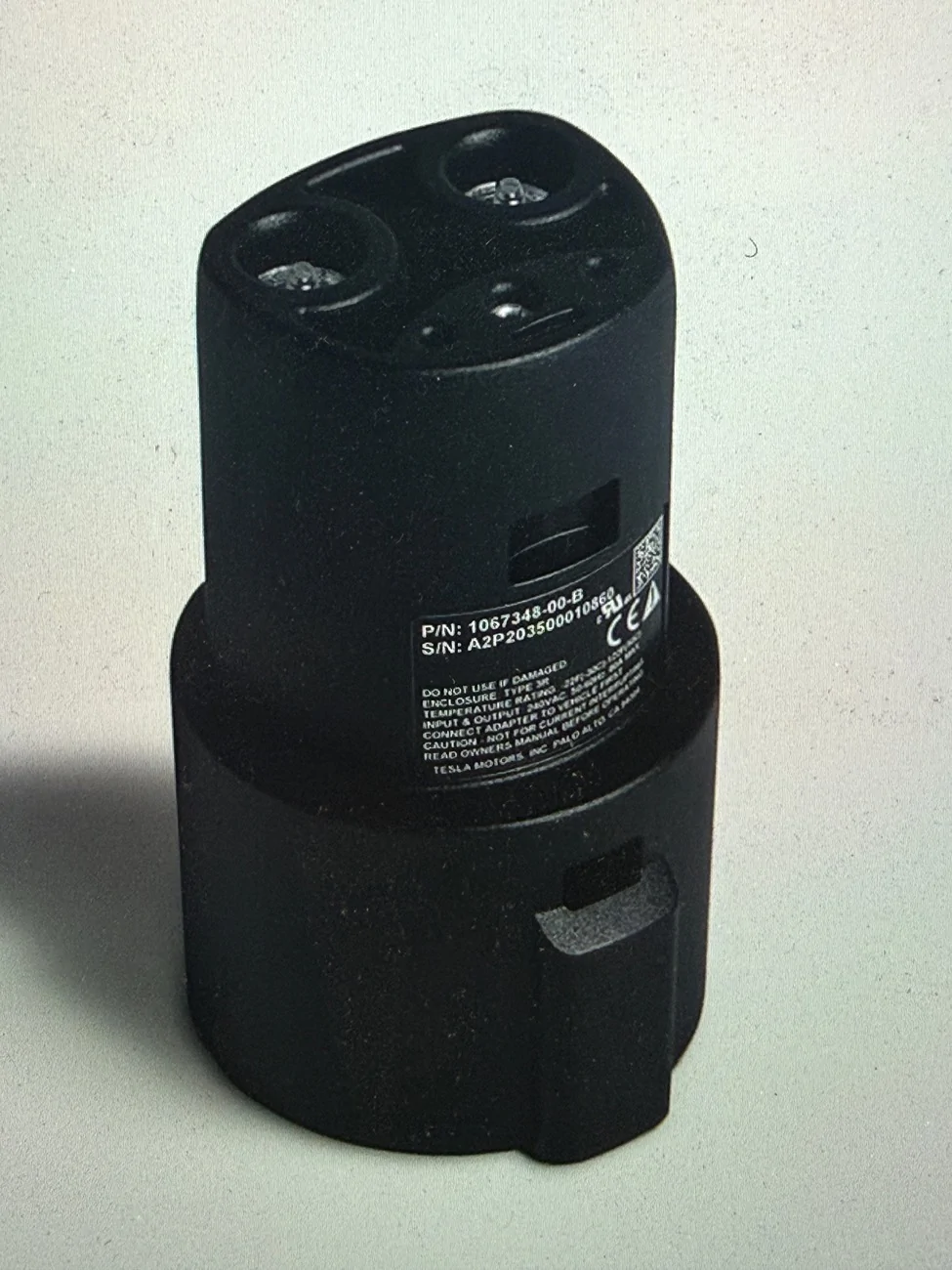

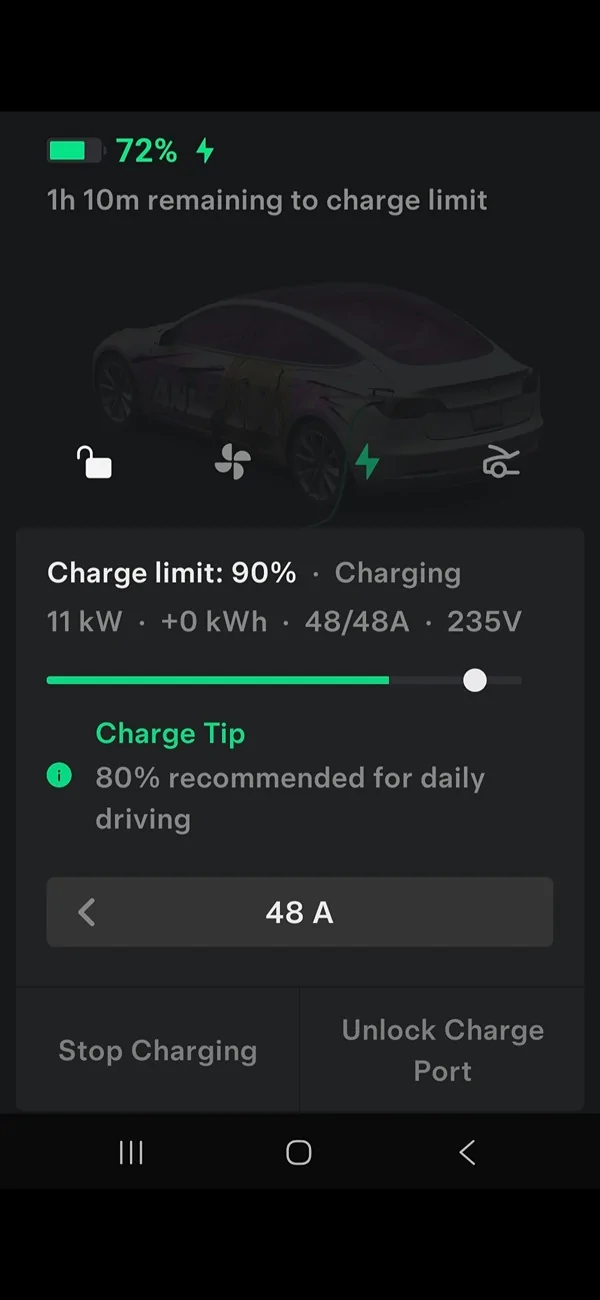

I know you said that you didn’t want any hacks but this isn’t really a hack. I just purchased a Tesla brand J1772 to NACS adapter and notched the bottom so it would fit my FCSP CCS plug. It only takes a couple of minutes with a dremel tool. Works like a charm and doesn’t reduce the integrity of the adapter at all. Food for thought.

My brother in law has a model x and I just plugged in like I would my truck and it charged like normal. No alterations to the software as far as I know. If Teslas can use a J1772 to Nacs without software changes then this notched adapter works the same way. The DC pins of the CCS plug don’t come in to play

No. The CCS option is only needed if you want to DC fast charge the Tesla at a CCS1 charger.
The FSCP uses a CCS1 plug, but otherwise it's performing J1772 AC charging, and Teslas have always supported that protocol. But that CCS1 plug prevents the NACS-to-J1772 adapter from fitting without an "adjustment" like shown here.

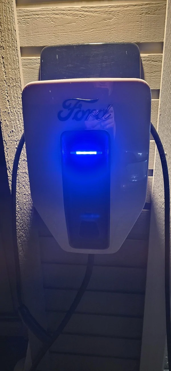

I got an AZ J1772 to J1772 extension cord and notched it so it would fit the CCS1 so I could use the FCSP to charge any J1772 ported vehicle - tested it on my 2012 Nissan Leaf works perfectly.
Any J1772 vehicle will (should) negotiate/communicate with the EVSE (FCSP) using the J1772 protocol. Some vejicles apparently want you to use only THEIR EVSE (I think Mercedes is the one?).
Modifying something in a way that is not authorized by the manufacturer is the literal definition of a hack.
I understand what you're saying, but taking a saw to the adapter is definitely the definition of a hack :)

Removing a chunk of plastic that is preventing an adapter from being used on a poorly designed plug is I suppose a ā€œhack.ā€ I would call it an engineering correction. 😊
