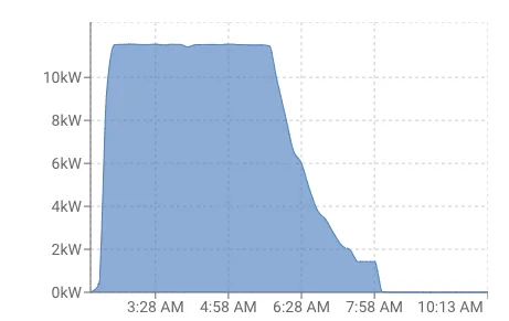

This is the charge curve from a recent Lightning charge on my ChargePoint Home Flex at 48A. Note that it slows down the charge rate as it reached max state of charge (in this case 100% since we were taking it for a ride that morning).
