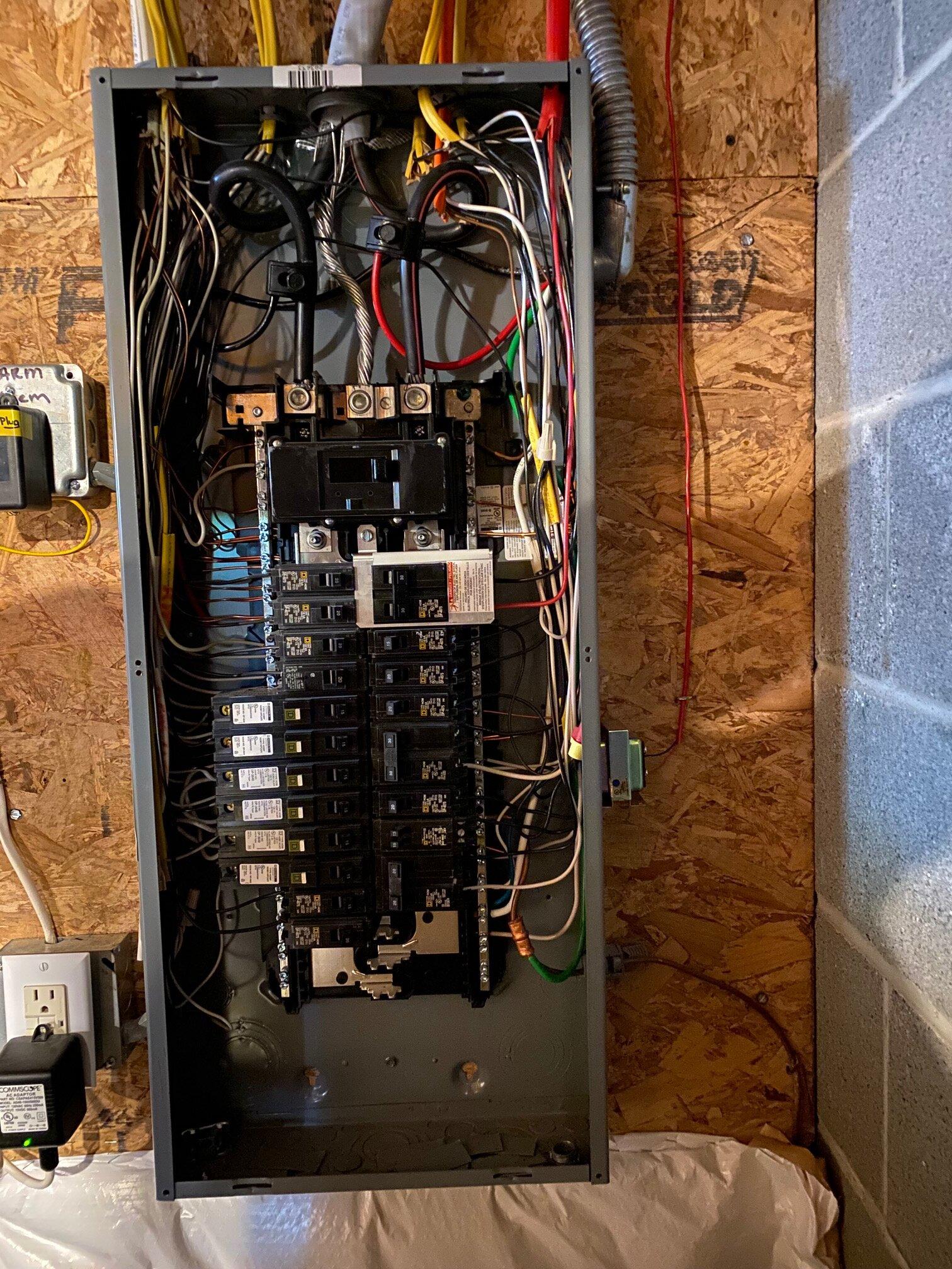

So I would like to know what most of the SR Lightning owners are doing or planning; if they intend to power their homes with the truck. I am trying to keep this as simple and cheap as possible and create a solution that will power my home from any potential external source such as a generator, battery array and of course the truck. My thoughts at present are a generator interlock kit on my 200 Amp service with a dual pole 60 amp breaker, install an outdoor rated box on my homes exterior with a Nema twist lock L14-30p connection and get a decent generator cord to go from the truck's Power Pro 240 connection to the house. The only expertise required to operate this setup would be to know how to manage the amperage load of your home and only turn on breakers for essential items.
