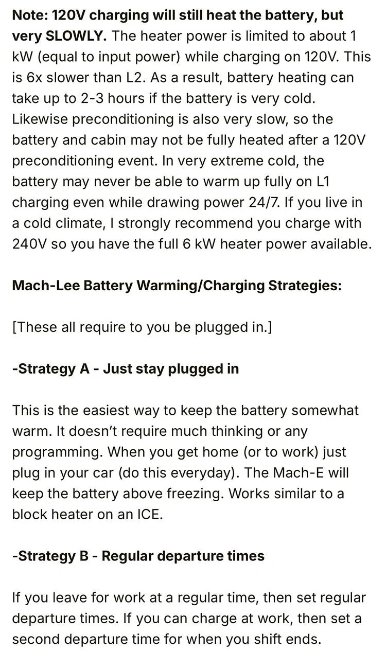

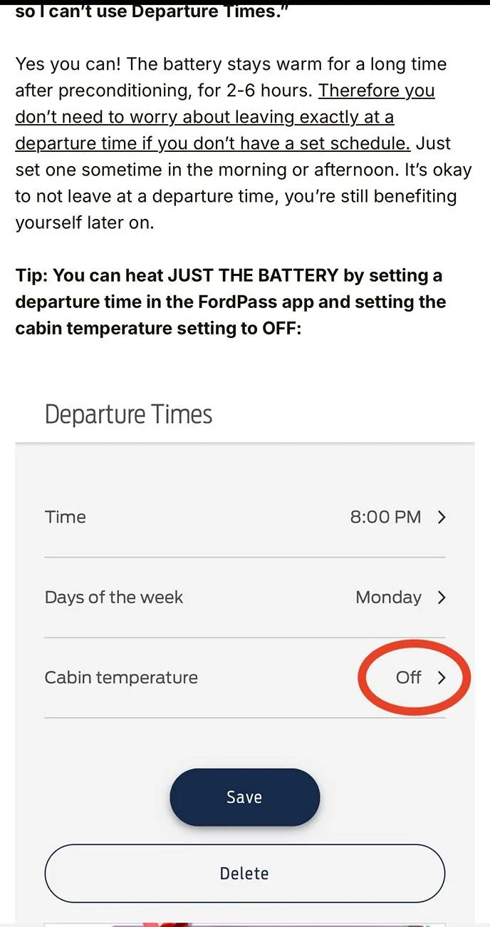

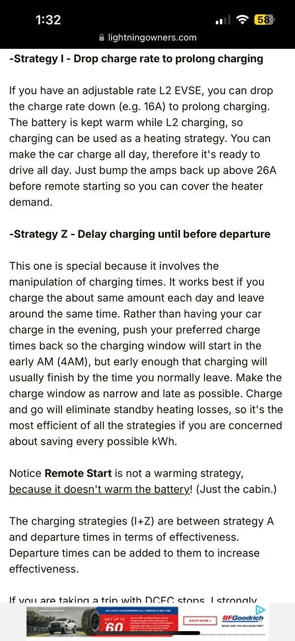

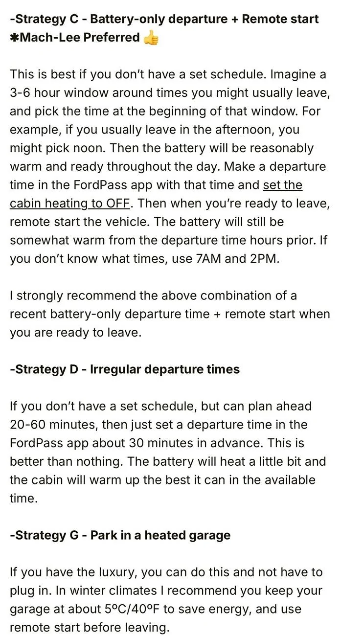

Found this on [banned site] info is for Mach E’s, but I’m assuming pertains to us as well. For all I know this info might be on here somewhere, but I found it useful so figured I’d share.

So purely out of curiosity, guessing it wasn’t gonna work, I tested the method of just heating the battery by turning cabin controls off in my departure time OFF plug to see if anything happened at all. Oddly enough, the cabin controls came on anyways and started heating the cabin to 74° although it was a brand new departure time I had created and double checked that indeed cabin temperature was off battery was cold as a stone. ?‍♂?

I was going to experiment with strategy C, I have never done that, previously.
Normally I use strategy Z in the deep of winter, delayed charging to early am, then a remote start when I'm getting ready to go out, doing this 15 minutes prior to leave time.
In my personal use, the extra performance for a typical 10 miles of daily driving isn't worth the extra 5 to 6 kWh to warm the battery directly with departure timer.

Nice to see that while slow, 120 volts does heat the battery.

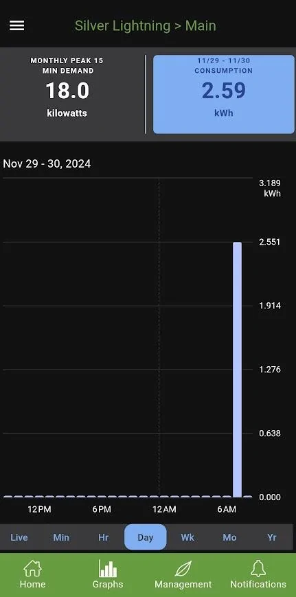

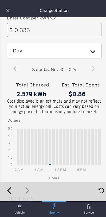

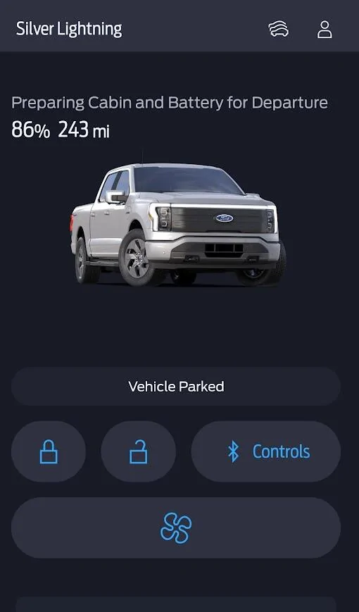

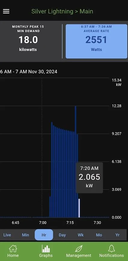

This morning I did a modified strategy C, I don't plan on driving it today, but wanted to measure the actual energy used to precondition just the battery, so I set the cabin conditioning to off and I did not use the remote start for cabin conditioning, charging was inhibited with a lowered SOC goal of 80%
The scheme required a departure time of 7:50 am.
The truck decided at 7:04 am to begin warming the battery, this phase ran for 16 minutes until 7:20 am. The truck did not take any additional energy from 7:45 to 8:00 am as would be normally seen if cabin conditioning were requested. I sent 2.59 kWh of energy to the truck to warm the battery. The FCSP insights log recorded a similar amount of energy, it's usually within 1% of Emporia. The PTC and pumps draw a hair above 9 KW.
Ford F-150 Lightning Cold Cold Weather tips 1732974915784-2x
Ford F-150 Lightning Cold Cold Weather tips 1732974941307-jc
Ford F-150 Lightning Cold Cold Weather tips 1732974965293-mt

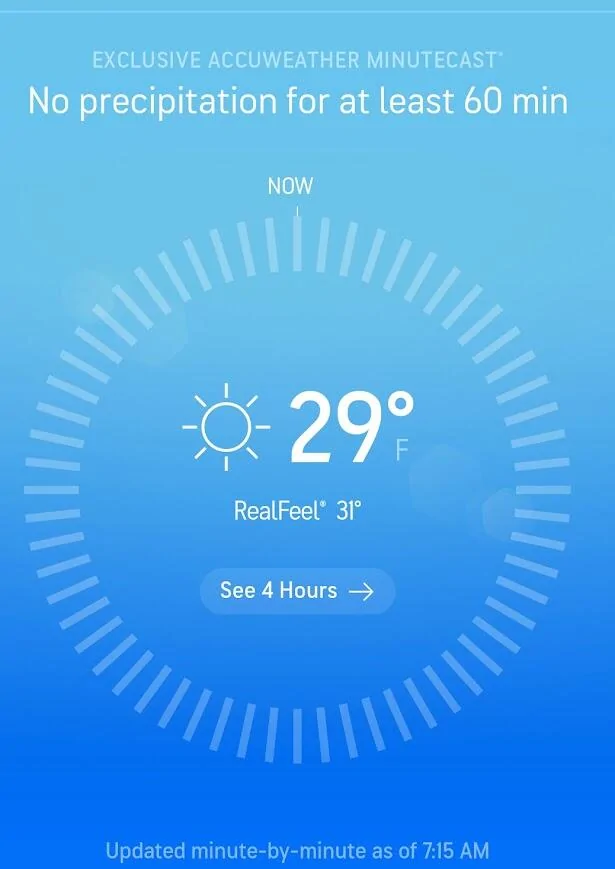

It was a chilly 29 degrees this morning my garage is not heated, Ford pass indicated at the start of the process that it was "Preparing Cabin and Battery for Departure" given my settings only battery preparation was occuring.

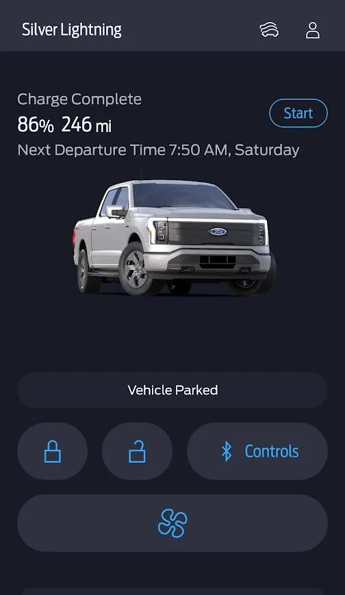

When the task was complete, the message changed to "Charge Complete" though no charging actually occurred, and no historic charge record was created for this pre-conditioning activity.
