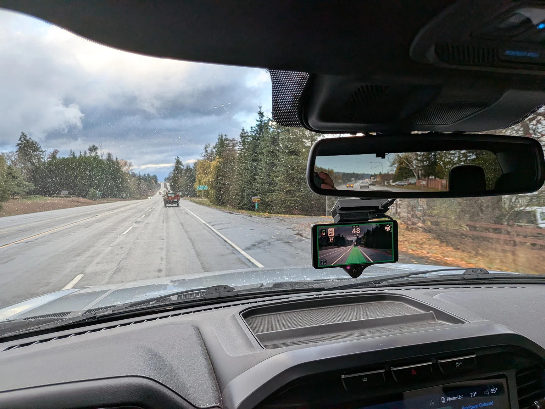

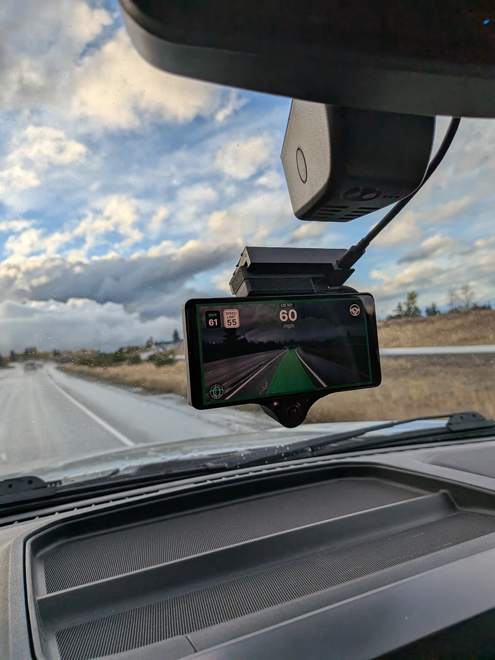

I have it with the fitcamx. I used the stock mount and put it as high as possible which blocked the view of the truck hood plus a little bit of the road that was inconsequential.
I now am using the quick release mount that I purchased from @Ajzride and the Comma sits lower, but works just fine. The mount still blocks the same sliver of road right in front of the hood.
EDIT:
@Howard_Scott_Warshaw , I overlooked the part where you asked about power supply... The Comma and Fitcamx pull off of different power sources, so I haven't seen any power issues. The Fitcam uses the mirror harness, the Comma powers from it's harness that goes to the IPMA. There are options to power both with OBD power too, but that introduces some 12volt battery issues when the truck is off.
Do you have any pics with the FitCamX setup. This is what’s preventing me from pulling the trigger. I want to have both.

I decided to not install the FitCamX on my 2nd Lightning because it causes the Comma3x to be mounted too low (and Comma specifically says to mount as high as possible). I installed another DashCam and installed my C3X as far up the windshield as possible, hiding most of the screen. All that's visible while driving is the bottom of the screen which is where messages show and I have the screen timeout after 10 seconds (I don't like screens/distractions on my windshield). I, personally, wouldn't want to install the C3X with a FitCamX due to the placement. That being said, my C3X is more valuable to me than the FitCamX which is why I made the switch to another dashcam.
