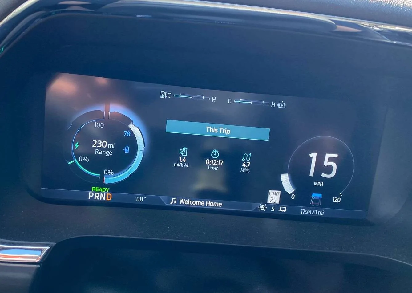

It was mentioned in another thread, but I wanted to share my test. If you didn't know, Summer decided it wanted round two in Phoenix, so despite some cool days a few weeks ago, the last few days have been in the 110s, so I was able to test it out.
If my battery temp is over the mid-line, driving in normal or sport will take hours, if ever, to cool it down. Switching into tow/haul will get it back to mid-line in about 15 minutes.
I wish I knew this all summer since we know heat is slowly killing our batteries and I intend to make this last as long as possible. Oh well, for next year I guess. When I got in the truck to run some errands, my battery temp was as high as you would expect when your car registers 133F on the thermometer when you first get in, but it was back to the middle in 12 minutes.

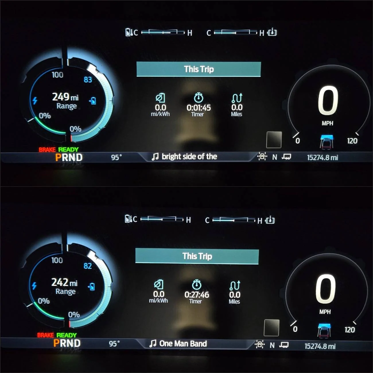

Saw this post and did some small testing, wished I knew about it earlier.
2023 Lightning with Max Tow package. All I did was 'idle' for almost 30 minutes with Tow/Haul mode on, AC at 70 degrees auto low, recirculation on, and driver cooled seats max. It was 8PM in Tucson, outside temperature at 97 degrees. I 'idle' a lot almost daily between 1-2 hours for work and on normal or sport mode the temperature is still stays high so I'm glad I saw this post.
Ford F-150 Lightning Cool down high battery temperature faster using Tow/Haul mode 🌡️ 20240928_201339
