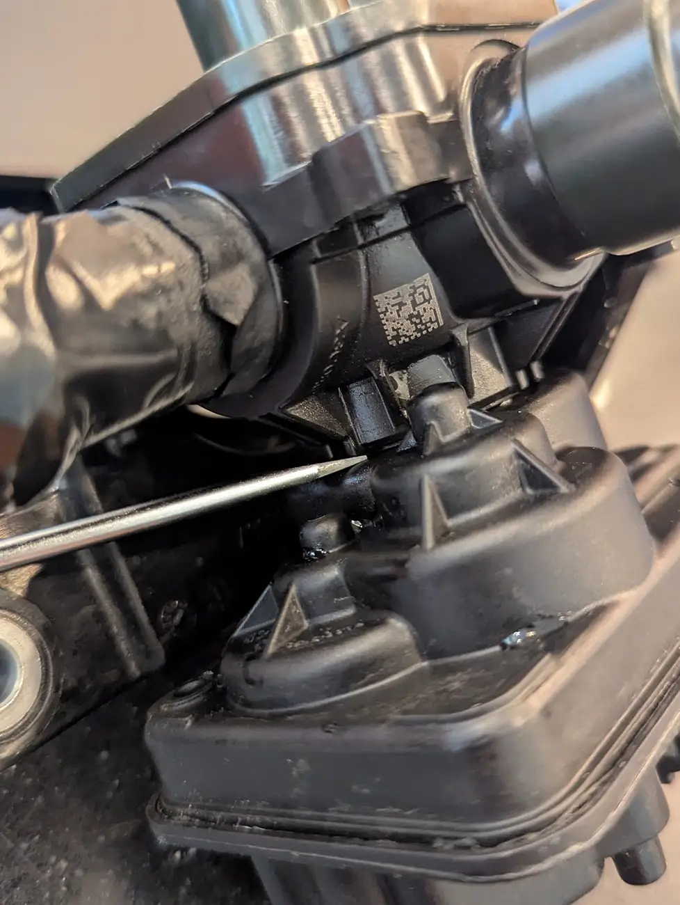

I got around to watching it. It seems like it could benefit from an upgrade to metal gears.
Absolutely, but at what cost/economics. Martin and I did this fix at 100kmi, I now have 155kmi on the truck with zero issues since. I immediately purchased the replacement valve and still have it in the box new. If the plastic gears consistently last 100kmi+ that's a pretty dam awesome job by some engineer who made the decision to save Ford a few bucks on every one, but if Ford is so stupidly not keeping spare parts stocked and causing issues even close to what has happened here for the OP then it was all in vain. The reputation and PR damage of something so extreme as a buyback over a $100 coolant valve is so ridiculous there's no amount of engineering effort worth it, ever. Ford should be ashamed the way this has played out. Someone high up should have stepped in, yanked this valve of an unsold 25 anywhere in the US, and shipped it to this dealer first class.

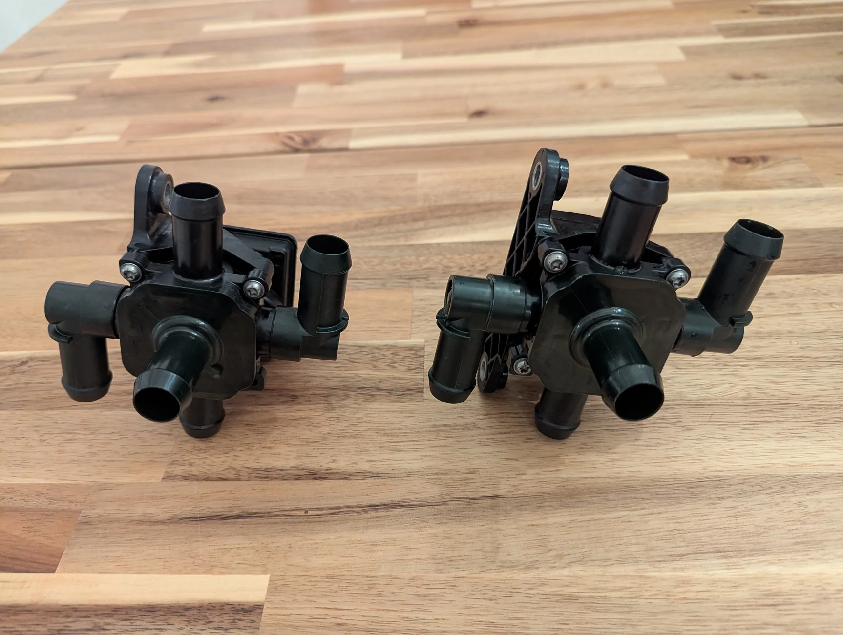

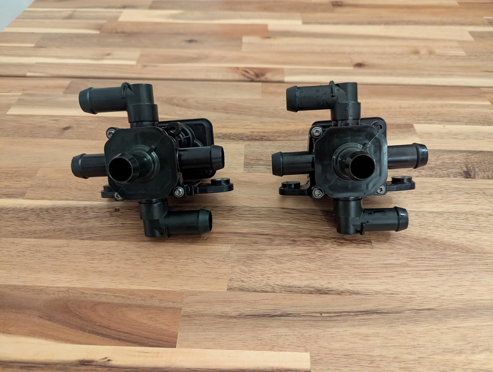

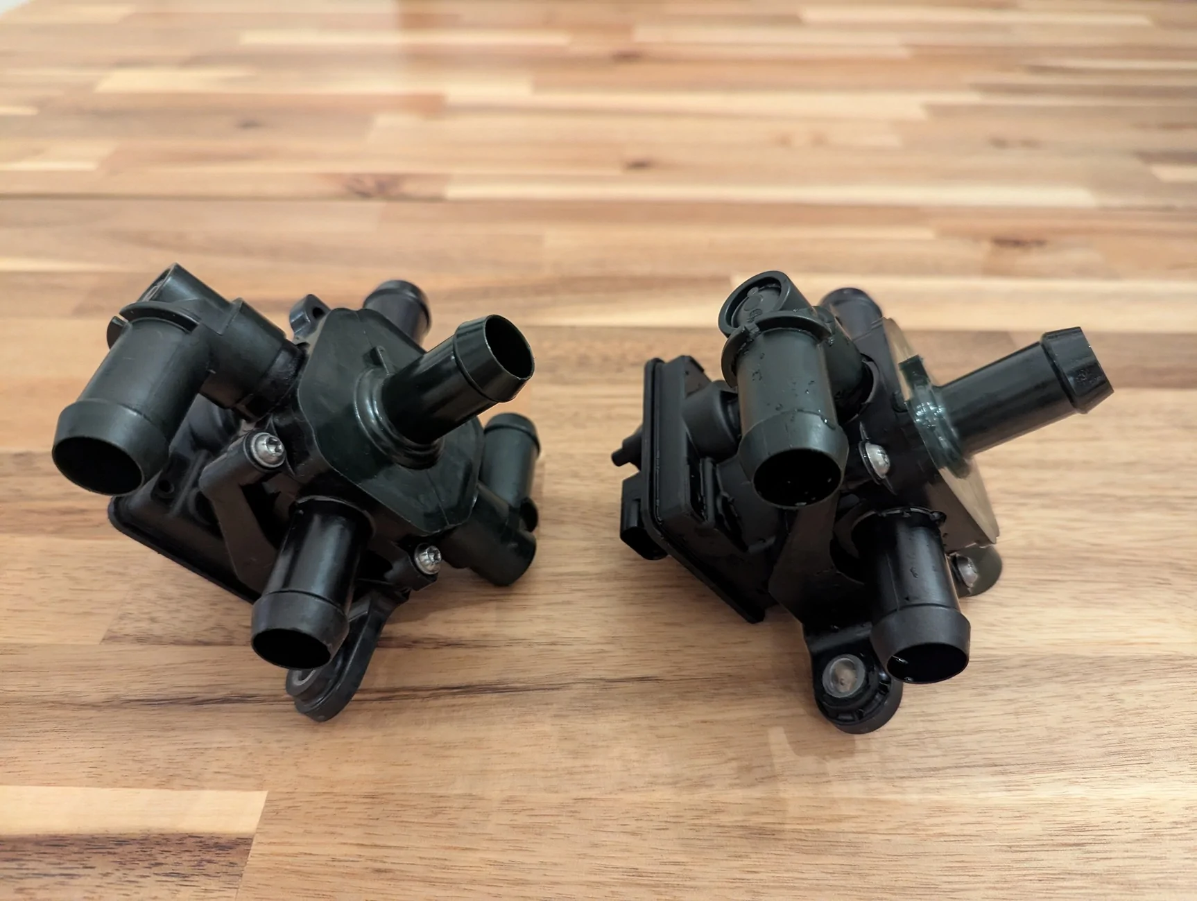

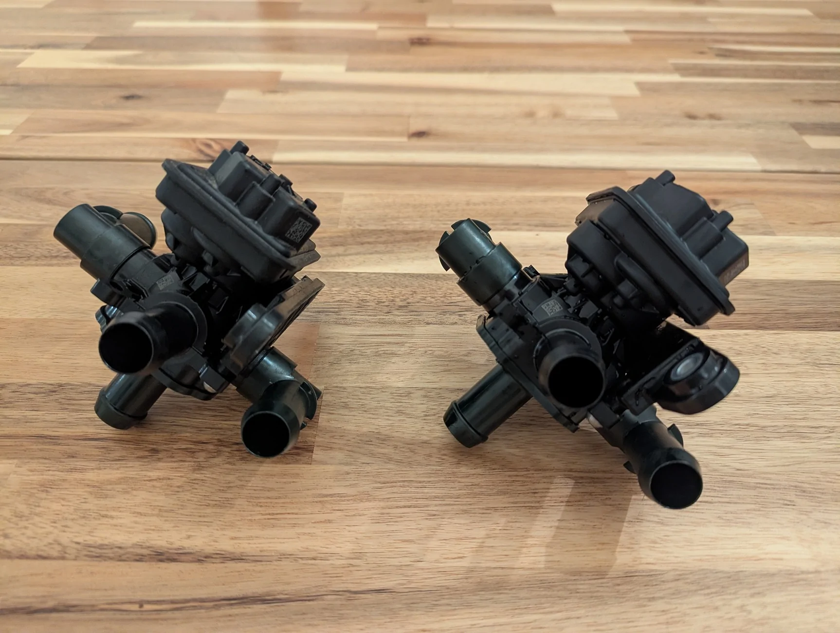

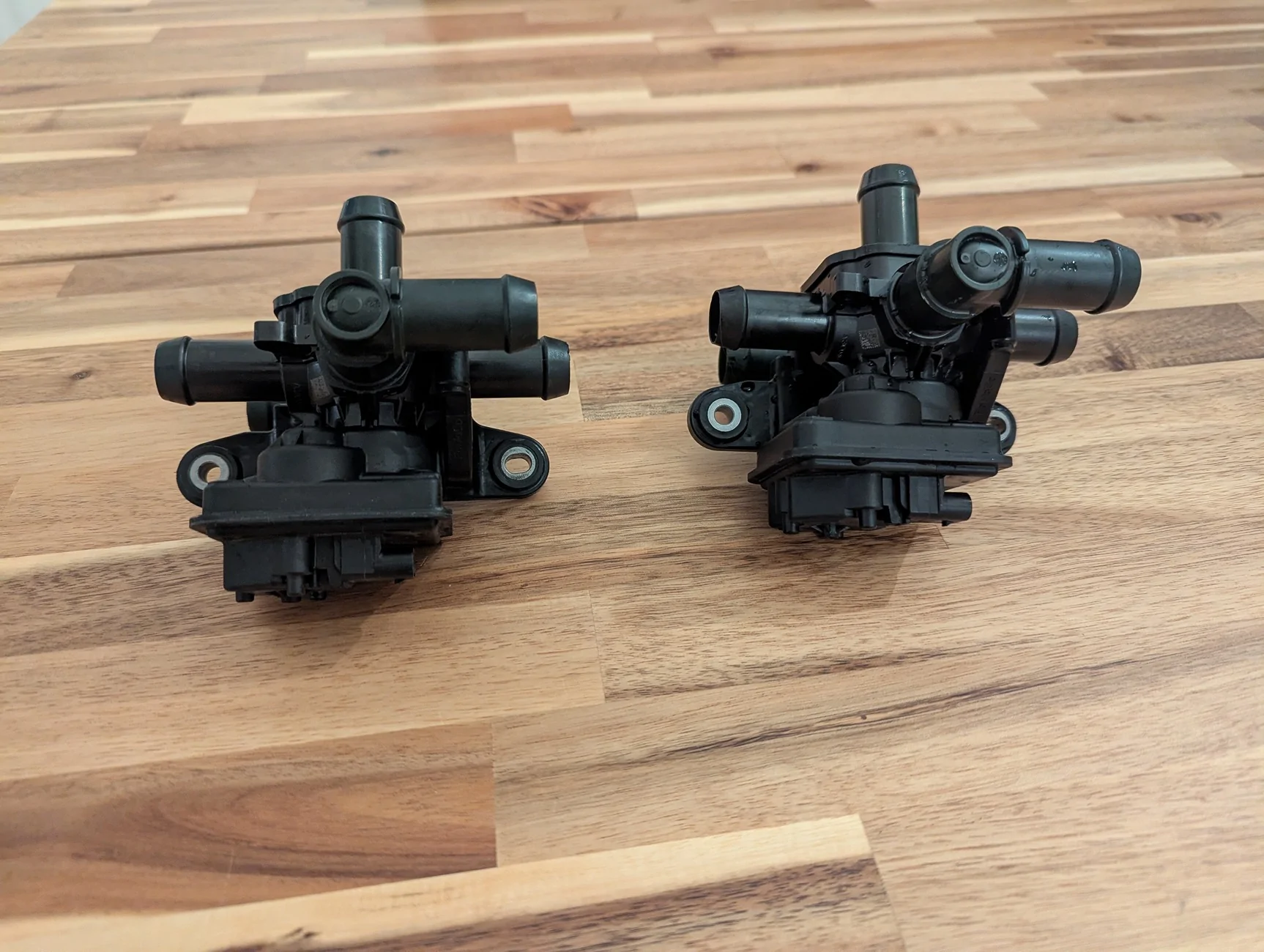

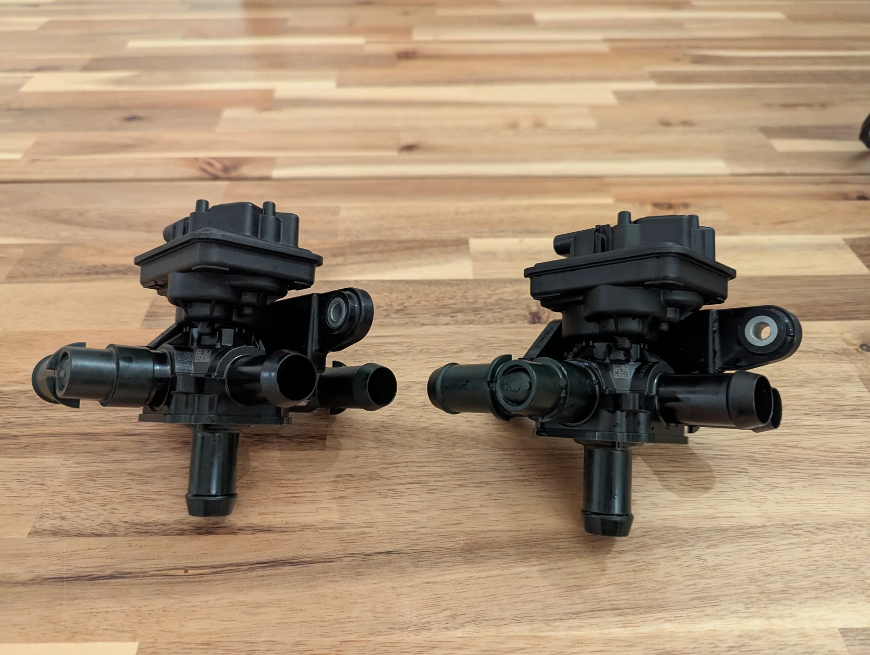

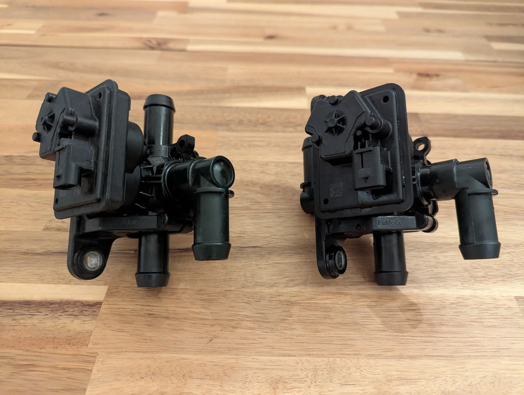

My new 2025 Ford Lightning Pro came complete with a coolant leak from the coolant valve. Ford Part # MU5Z-8C513-D. The truck has been at the local dealer for 2 months now....... This part is backordered indefinitely.
I have tried everything, filed a case with customer service and just received approval for buyback.
I really like this truck, and I bought a bunch of accessories for it.
I can't find another 2025 Pro and I am incredibly frustrated that this part is not available for a new truck.
The stress is taking a toll on me, especially since I am short a vehicle for our family.
This is a $ 150 part that is keeping a $ 50,000 truck from operating.

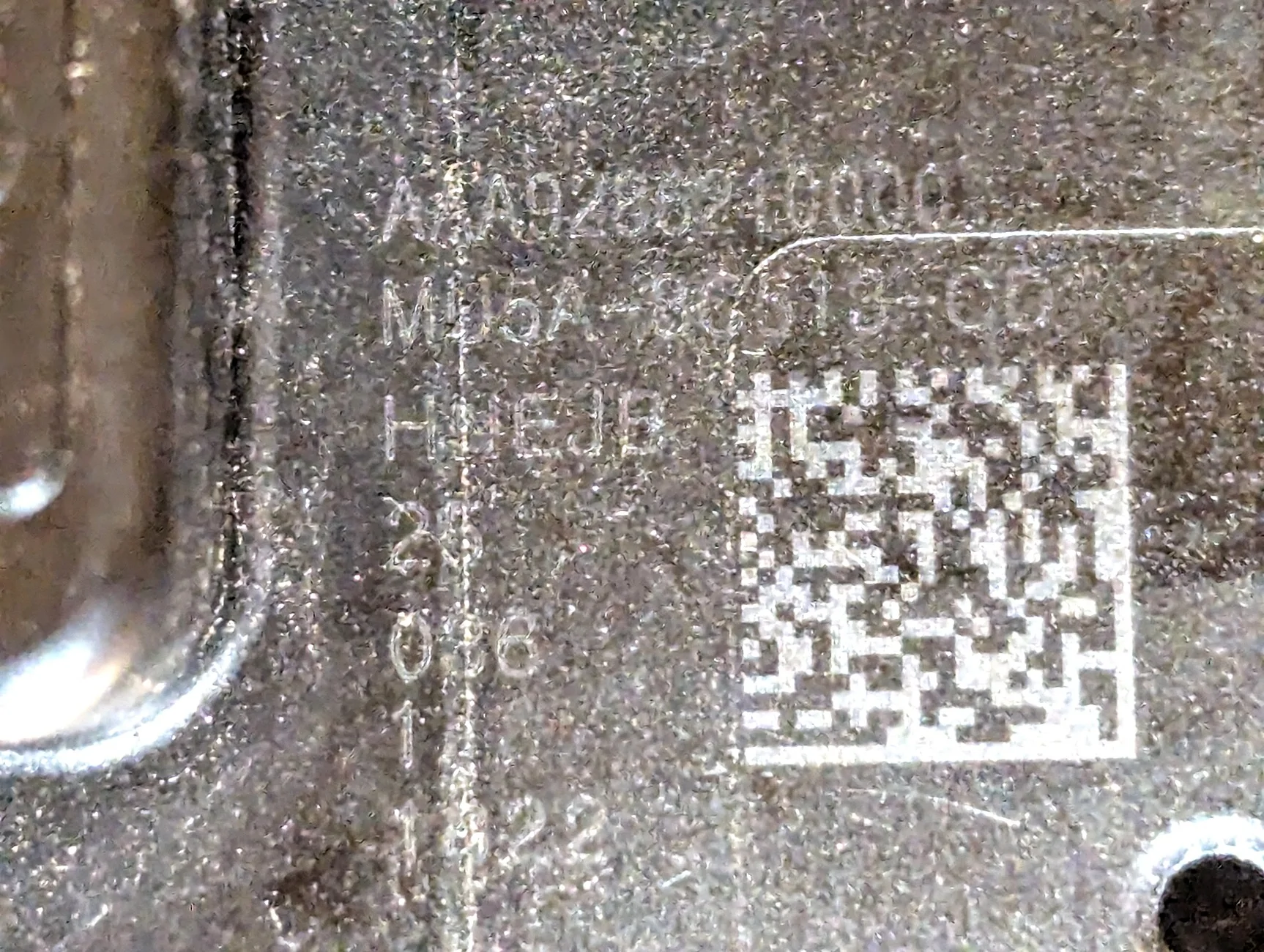

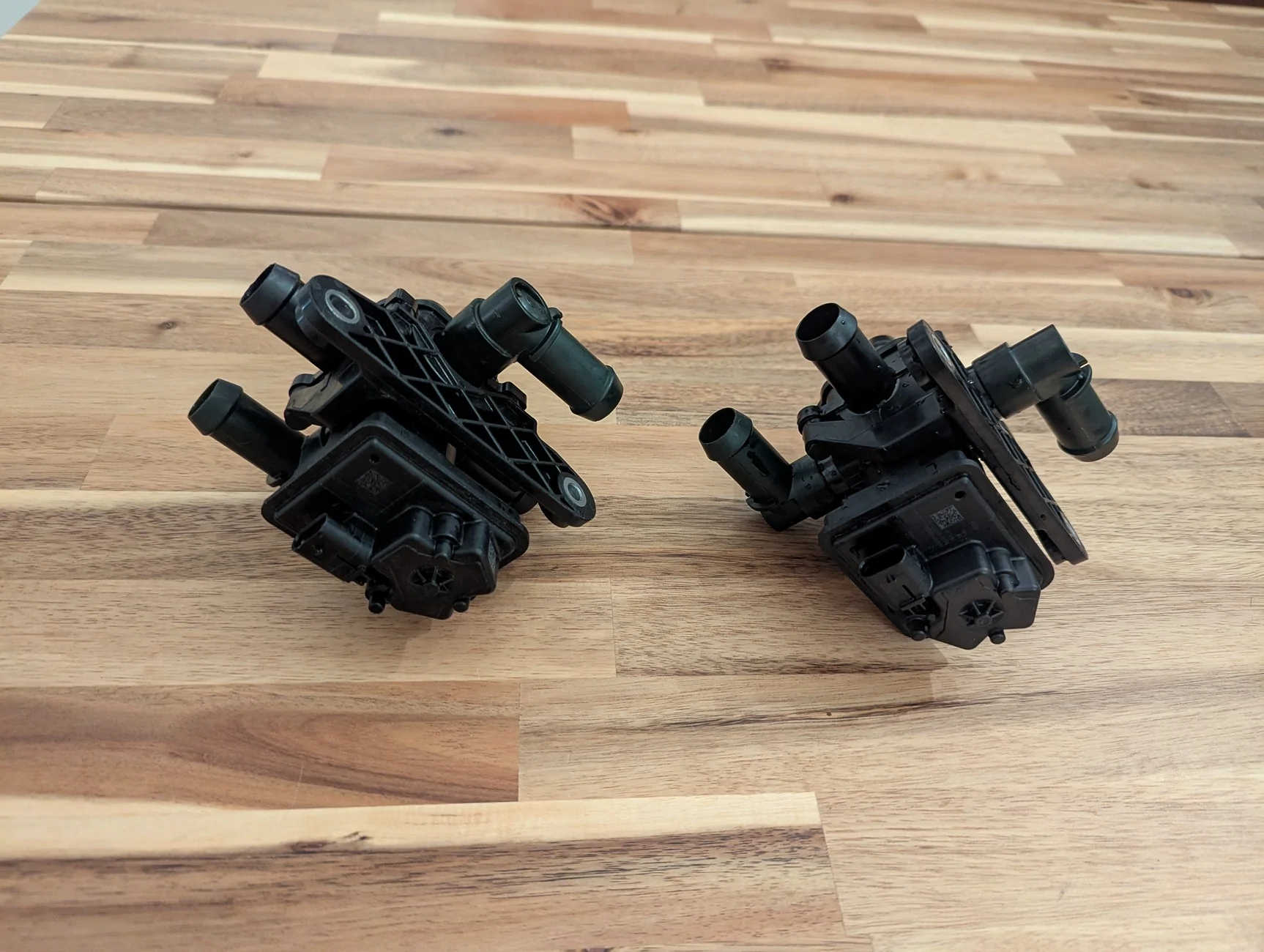

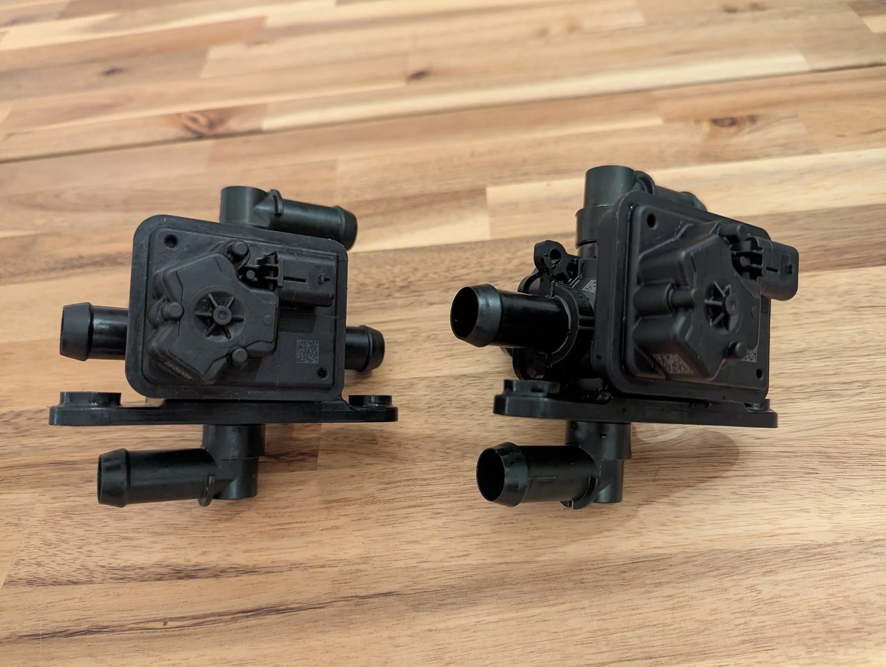

I have bought an A version (MU5Z-8C513-A) for this truck, but was told that it is not compatible.
There is also a B and C version apparently and I saw that the installed valve is a MU5Z-8C513-CD.
Does anyone have any suggestions?
I checked all the local junkyards and used parts business without success.

Brian, what we need here, immediately is for a tech/engineer from Ford to confirm if a different part # valve which is the same mechanically can be used here, and if so which one specifically. If so, that needs to be conveyed officially to the service advisor and that part overnighted.
Please personally check on this ASAP. I cannot fathom how Ford thinks this is worthy of a buyback unless they literally know there is no alternative valve that can work here and the part is indeed not going to be available for a LONG time.
I'm on it.
