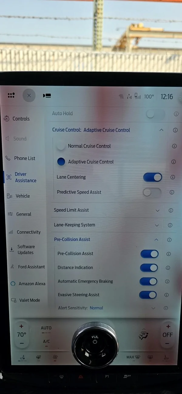

Yea, that showed up a few months ago. As has been stated, there is a setting in the Adaptive Cruise Control setting that turns that off. You can see an indication on the dash when it's on. The speed limit display will have a box around it with sort of an arrow pointing to the right towards the ACC speed setting (only when ACC is active). When it is disabled, that box and arrow goes away. I don't remember the exact wording of the setting to change, and it's not entirely obvious, but it was not hard to figure it out from the info buttons on each setting.

@Gaffer
Driver Assistance: Cruise Control Adaptive Cruise Control - Predictive Speed Assist - turn it off

Sounds like you have the Speed Limit Assist turned on. You can toggle that off.
