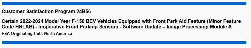

Ford F-150 Lightning CSP 24B56 - Inoperative Front Parking Sensor(s) - IPMA Software Update for Certain 2022-24 F-150 Lightning Trucks CSP_24B56_Banner
BLUF: CSP released to address “Front Parking Sensors Not Available/Sensors Blocked, See Manual” messages in IPC. The fix is to update the IPMA software level. Some vehicles may have had this same issue previously repaired under SSM 52161.
Applicable build dates are: October 14, 2021 through December 15, 2023.
See attached bulletins for more info. Owner letters should be mailed out the week of 9 Sep 24.
P.S. Anytime you can get the dealership techs to update your IPMA and PSCM for free to enhance your BlueCruise functionality in addition to anything else...is a win-win.
