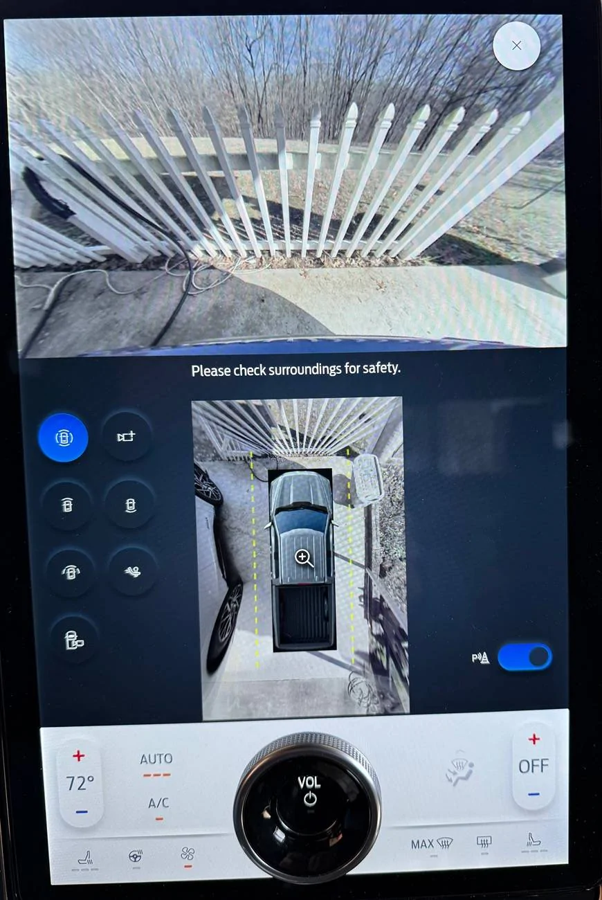

I had it done and ended up with the tiny 360 view. I changed it back with FORScan and just lived with the menu button to get to the camera views. When I updated to 6.14, it seems that applied/configured whatever the tech didn't as I now have the correct button layout. Don't know if it was a coincidence that the update happen to run the config or not. Point being that you could get it done, fix the view yourself, then let a future update perform the config.

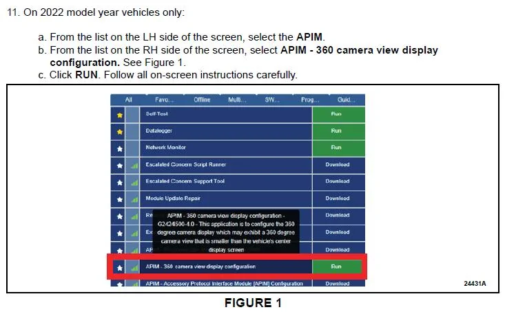

How did you fix it? Or did the dealer need to do it? (If so, please let me know what to tell the dealer that might expedite resolution.)
Mike G
Mike G
Jan 6, 2022
1,564
2,189
N. AL, USA
Well, they could start by re-reading the TSB. It says right in there what they need to do.
Step 11.
Ford F-150 Lightning CSP 24B56 - Inoperative Front Parking Sensor(s) - IPMA Software Update for Certain 2022-24 F-150 Lightning Trucks 24B56_360_Camera_View_Fix
But apparently it's 'rocket-surgery' for many of these folks....
