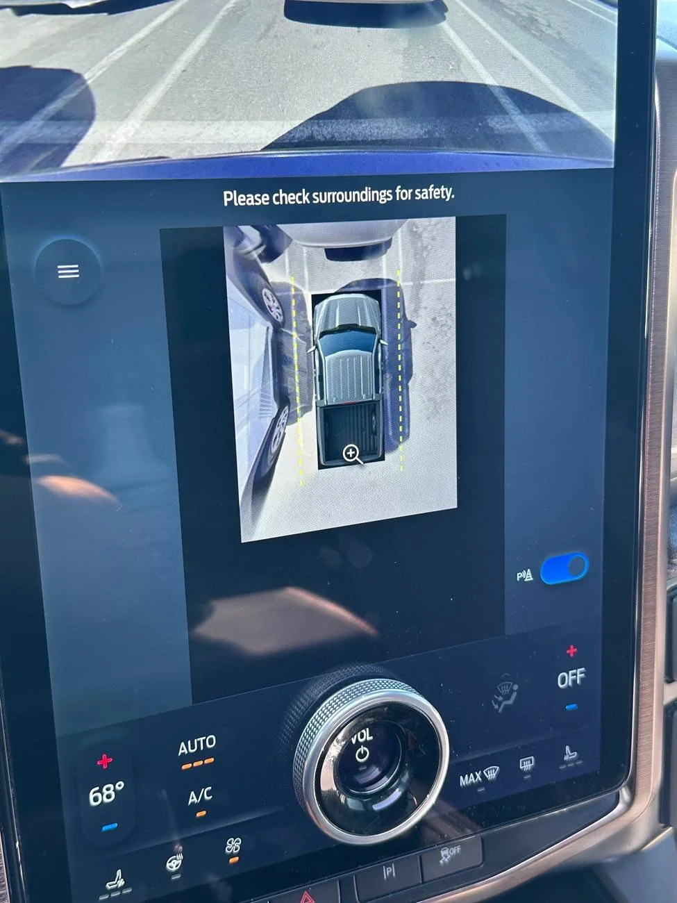

Cursed with the small 360 cam now
I'm not sure if i have the small 360 view display. Can you guys look at this snapshot and determine if i have the small display? This 360 pic isn't much wider than the volume knob, but i can't remember how the display normally looks.
Thanks.
Thanks.
Yours is normal. The only issue is on 22's where the dealer didn't follow directions so they're left with the black box around the image until it's either fixed in FDRS or FORScan.
Ahh... ok. I thought for sure that the 360 was bigger than that.
In fact, it doesn't look any bigger than @MichaelCA "s post that I quoted. :unsure:
It was bigger but the update also changed the size and how the menu on the left was displayed so we're stuck with it. Maybe enough people will complain to Ford and they'll revert back to the previous since within the next decade.
