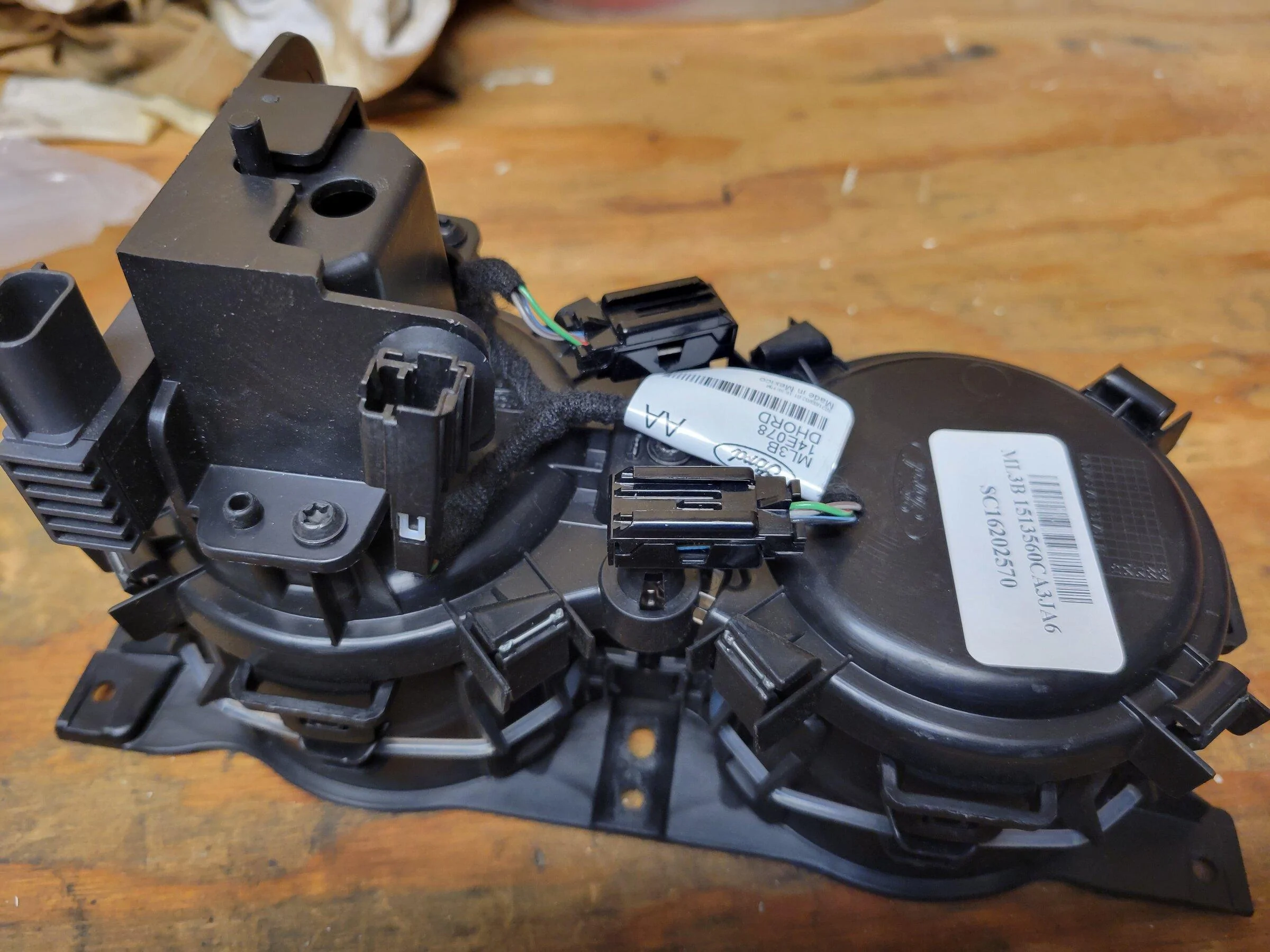

Did yours come with the light ring too? My cup assembly came with the lights but not the light ring. Fortunately I had bought the light ring previously and was able to retrofit it. Seems some guys are lucking out and receiving both the lights and light ring, others are not, even though we're ordering the same part #.
I was lucky enough to to get the light ring too.

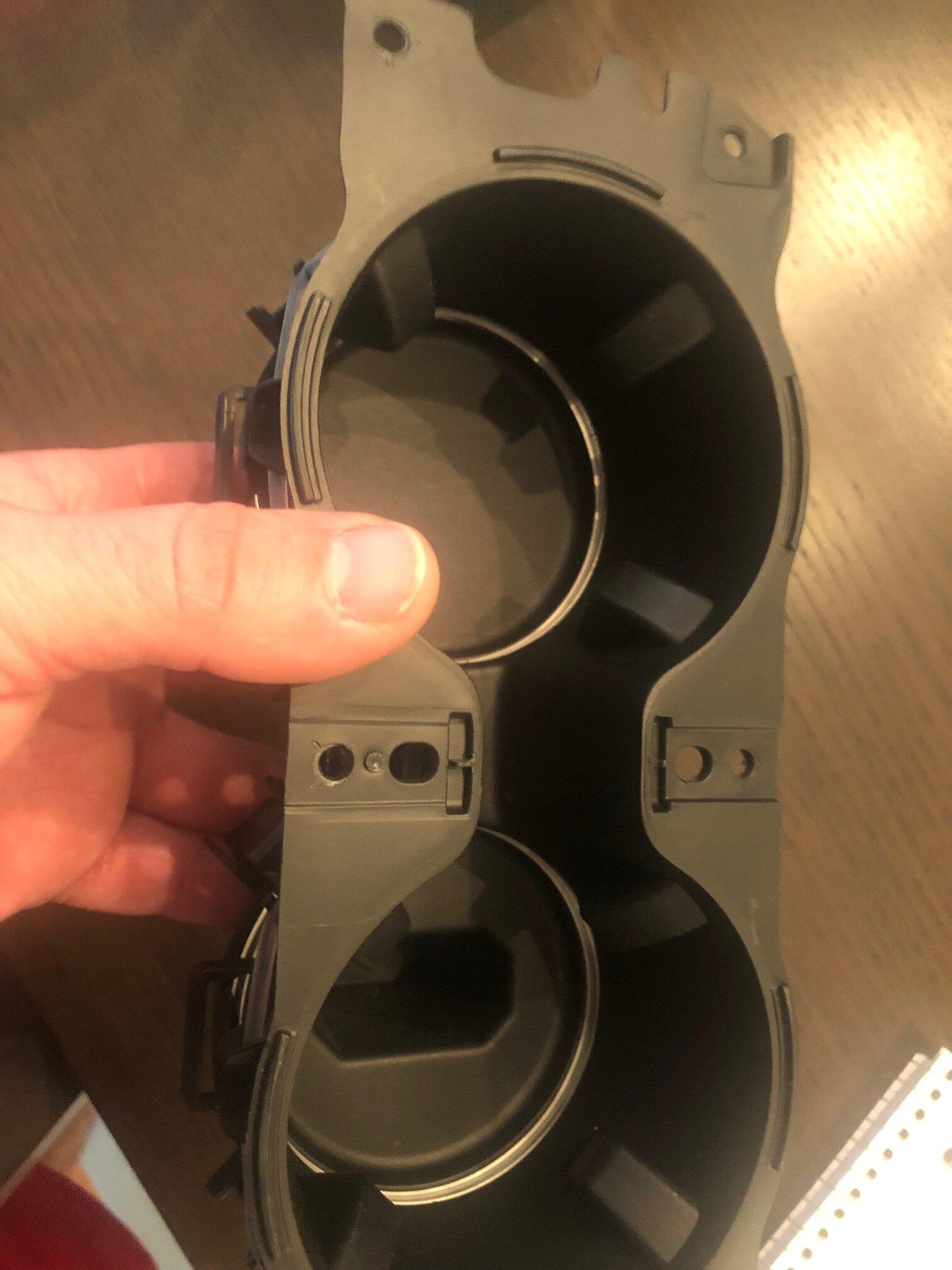

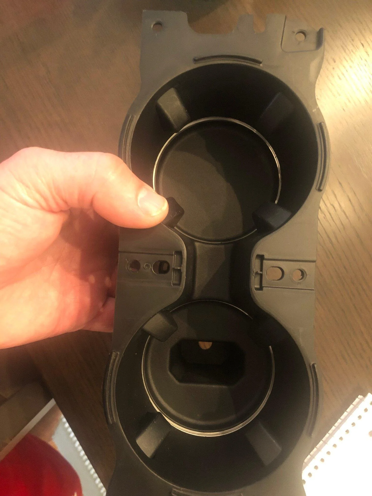

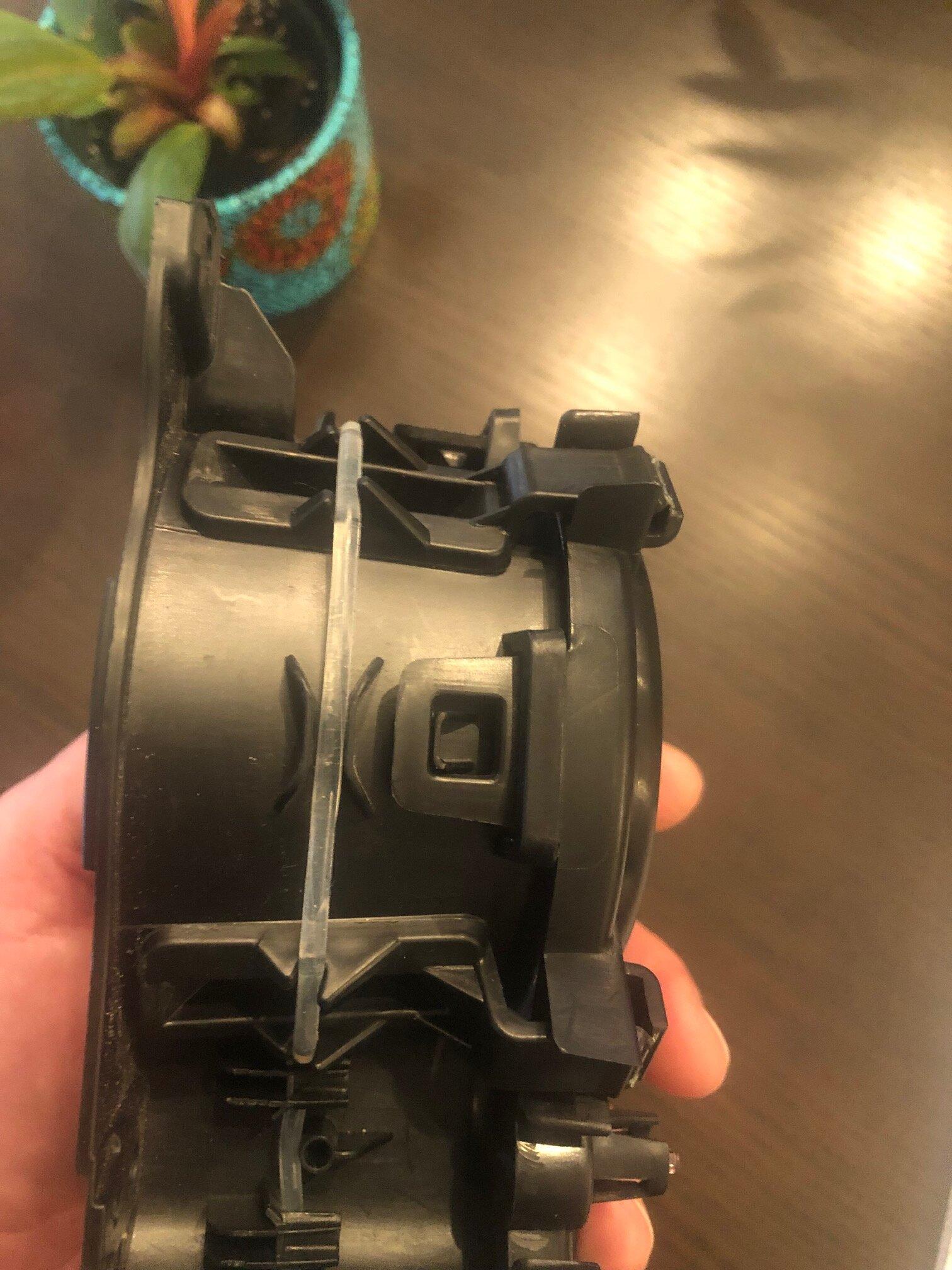

ok before I shipped the cup holder to @STJonesin4 I snapped some pictures. I did sand a little too far on the one side. I fixed this by using plastic weld to glue the clips down in place. I went about 1/16 to far. not a big deal just didnt want there to be a gap between the light ring and cup bottom. Ill let @STJonesin4 give his opinion of how it turned out and what could be done better maybe? for my first one i thought it came out pretty damn good lol
