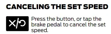

The problem may be that I have lane-keeping turned on to work in concert with the intended speed maintenance that comes from activating adaptive cruise control. The best answer for me seems to be to hit the Cancel Cruise control button at the first sign of any KEEP YOUR HANDS ON THE STEERING WHEEL message.

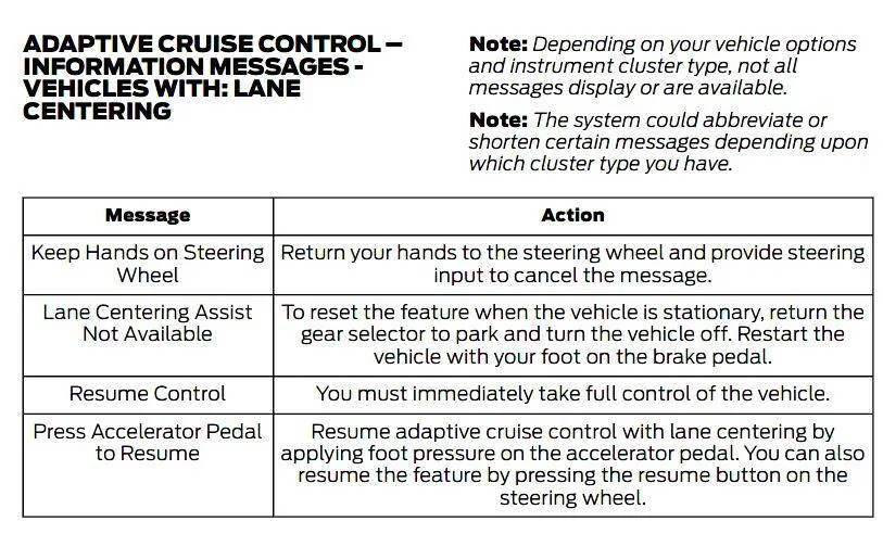

The manual does say the following under Adaptive Cruise Control:
Ford F-150 Lightning Dangerous Unexpected Adaptive Cruise Control Behavior - Sudden Braking Following "RESUME CONTROL" Message 1735079380799-g2
I've driven that same section of road dozens of times with my hands tightly gripping the wheel and never gotten a KEEP HANDS ON STEERING wheel message before. One would think that the resistance to the steering wheel moving in any direction would be considered torque, but I guess it's not. It's stupid when one needs to drive straight to be safe on that perfectly straight road (open gutters on one side, traffic in a neighboring same-direction lane on the other) that you need to move the steering wheel away from driving straight ahead to be safe. Ha ha.
On RESUME CONTROL, "you must immediately take full control of the vehicle" is wonderfully vague. What exactly does that mean?
As I said, the best answer to this nonsense is the CANCEL button on the steering wheel. When Ford's sensing mechanisms aren't happy with a driver tightly gripping the wheel, eyes on the road, and driving with no change in steering down a perfectly straight road, as I've done many times before in the exact location, the best thing is to stop putting up with Ford's driving assist nonsense.

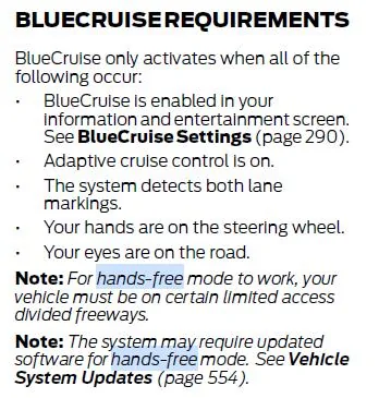

This road must not be a mapped Hands free zone, your hands must always be present on the wheel with an occasional torquing left or right, this assures the truck you're in control even if it's able to give you substantial assistance.
211
15,610
17,435
Hands Free roads, limited access divided highways {freeways}

we have to also differentiate between the original post saying 'adaptive cruise' versus what some others automatically think of as 'blue cruise'... but, they are not the same.
My PRO has Adaptive Cruise and Lane Centering, after I ADDED it, and it works great - but, I will tell you that there are TIMES, very infrequently, though, that the truck, and ANY vehicle with this type of technology, MAY have issues created by not only SUN GLARE/REFLECTIONS, but also by hills/overpasses that can seem to throw it into a tail spin... a vehicle sitting at an intersection waiting for you to pass also can 'seem' to be in your lane, and the vehicle responds accordingly...
Blue Cruise requires roadways that are in the software, but basic 'Adaptive Cruise/Lane Centering' does not - it can work ANYWHERE, when you turn it on, as long as it can read the side road stripes effectively.
