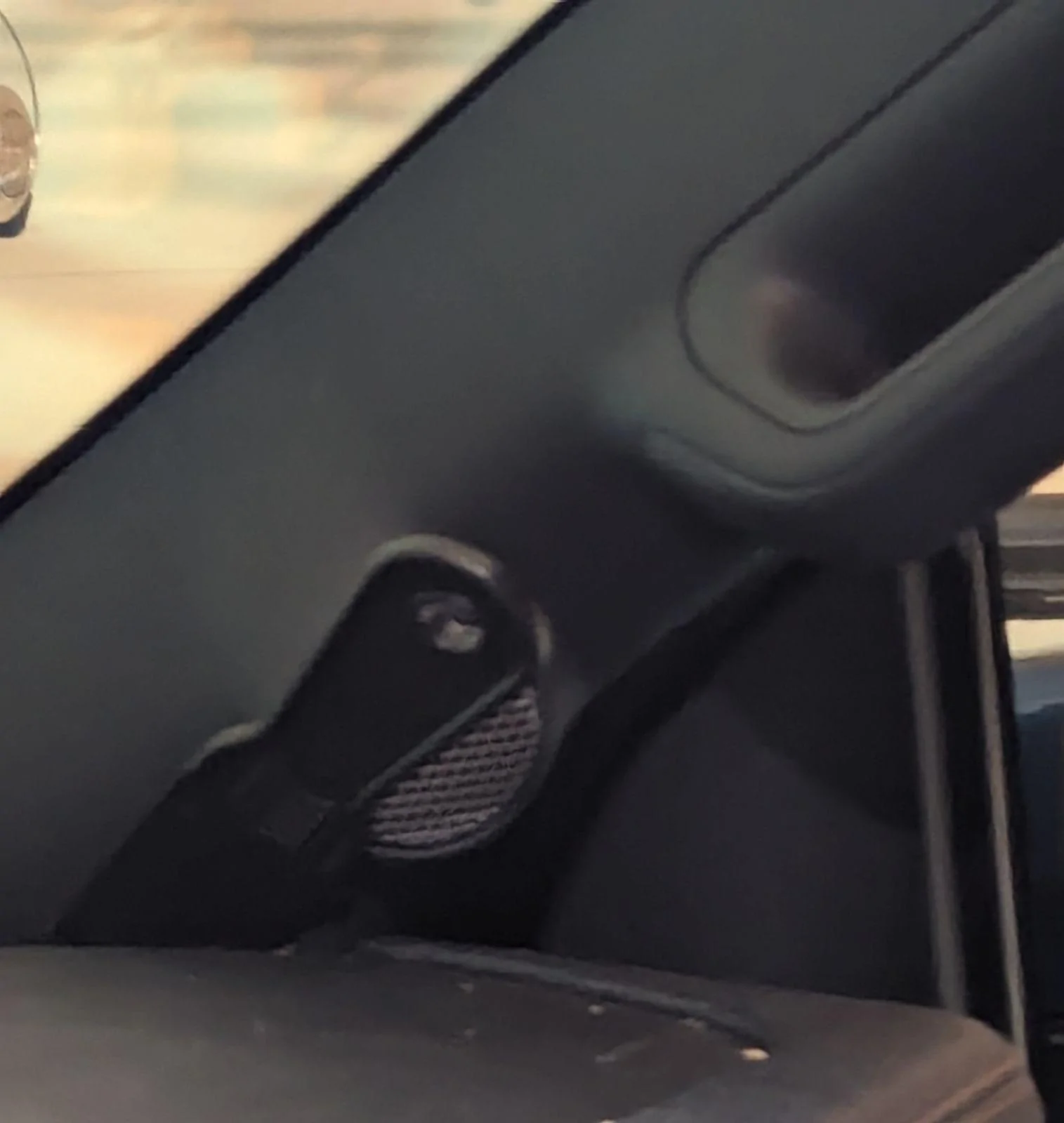

Can you guys post a picture of what you are talking about regarding the (1) "Plastic (triangle) panel on the door frame" and "that triangular black piece of plastic just under that tweeter speaker." I just had a look at those areas of my Lightning, and I don't see anything triangular.
Thanks!

Ford F-150 Lightning Dashboard - A Pillar Creaking Tj3wy1E
this is the part. My truck is at the dealer so I can't take a picture of mine.
Ah, I get it. That is the plastic piece adjacent to where the side view mirror connects to the door, correct?
I think my issue is originating at the interface between the long plastic piece covering the inside of the A-pillar and the dashboard. Will keep that triangle in mind.

I had a noise from that same area. My noise was coming from the panel on the side of the dash. Its held on by those metal clips. I just popped it of and put it back. That kept it quiet for about a month then it started again. I just popped it of again to fix it. Next time, I'm adding some silicone lubricant to it.

I had this exact problem and solved it. It wasn't the pillar on my truck, it was that triangular black piece of plastic just under that tweeter speaker. It's clipped on with those stereotypical metal clips and all I did to fix it was pull it off and reseat it where it apparently isn't rubbing anymore on the adjacent parts and pieces.
I had stubbornly and stupidly thought it was coming from the dashboard/A Pillar Interface. I should have listened to you two. I had not driven the vehicle for the last 10 days of the year, and it was getting really annoying this past week.
I used my plastic putty knife, popped open that panel on the passenger side of the dash that includes an HVAC vent to the passenger side front window. My clips were all plastic. I took a Q Tip and some Vaseline petrolatum jelly, swabbed the clips on the part and the receptacles for the clips, and the creaking noise is gone.
