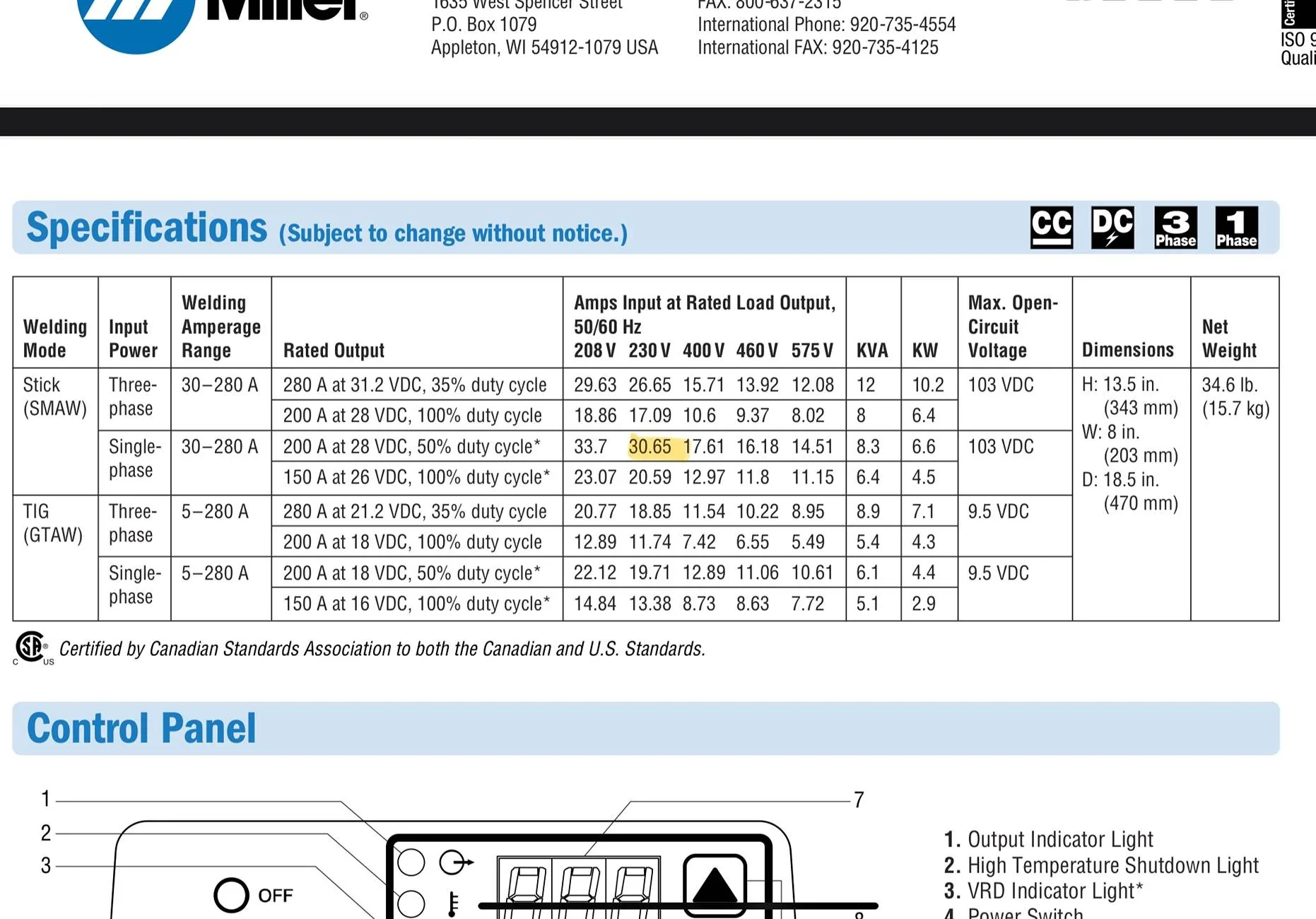

Your welder is capable of exceeding the 30 amps provided by the truck if maxed out. Iโ€™m sure youโ€™re aware and areโ€™t running at maximum output. I wonder if the turn on amperage surge is just a little too high and causing an overload condition.

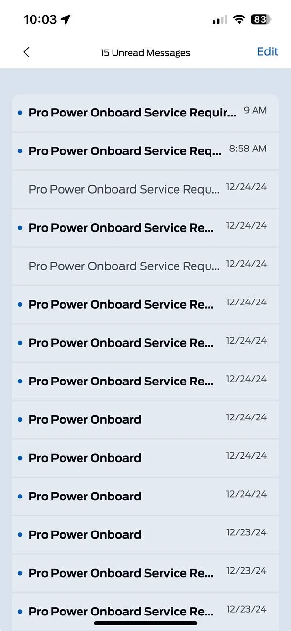

The dealer is saying that they do not have a hard code for this issue. I'm puzzled because I received multiple alerts on my Ford app stating "service required see dealer". My question is what is the point for the Ford app to tell you to see the dealer if the dealer can't see the issue. Anyways.
Fullerton Ford really tried to eliminate a possible issue with the bed outlet itself. They took a bed outlet from another Lightning and installed it in mine to see if that could possibly be the issue. I took the truck home last night and tried to weld with it this morning. It welded for about 3 rods before the machine shut off and I got the same warning sign on the dash. I tried to unplug and reset everything but no go.

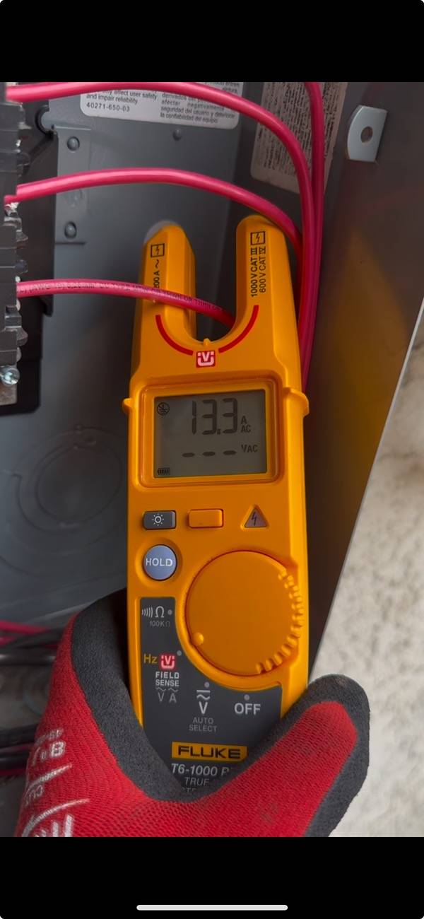

I just ran an Amp draw test. I simulated the same weld scenario. This screenshot is running 75 amps on my welding machine with 1/8" welding rod.
This is an inverter welding machine that typically doesn't draw a lot of amps.

13A is not much. One theory is harmonics. Your machine has an inverter, and probably a rectifier on the front end. These can throw out a lot of harmonics backwards toward the source, which is just another inverter. These harmonics can create heat without showing up on an ameter. Large industrial VFDs have harmonic filters built in to reduce this problem. Just a theory, I have not run a fab shop out of my truck!
We see this in data centers also. I agree with your theory here. This can be a major issue!
