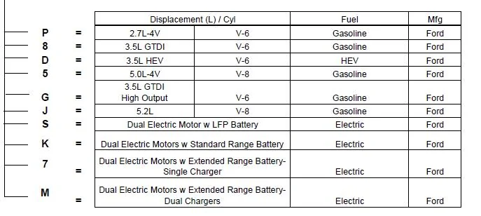

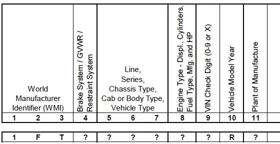

  • To determine if your F-150 Lightning has an LFP battery, you can check the 8th digit of the Vehicle Identification Number (VIN). If the 8th digit is a 4 or 5, the battery is LFP.
    this is how I found out
Mine has a a 4

That's 452hp vs the 580hp of the ER. The ER has about 28% more ponies, that would be noticeable.
I didn't know they had different hp specs but that would explain my experience. Thanks.

My 8th digit is a 7 so I should have an ER battery, and the fact that I’ve put over 100 kWh on a charge before supports that.
I do wonder if Ford uses different motors for SR and ER trucks or if they just control the output via software. I had kinda wondered if mine was just tuned differently than my old one or something.
