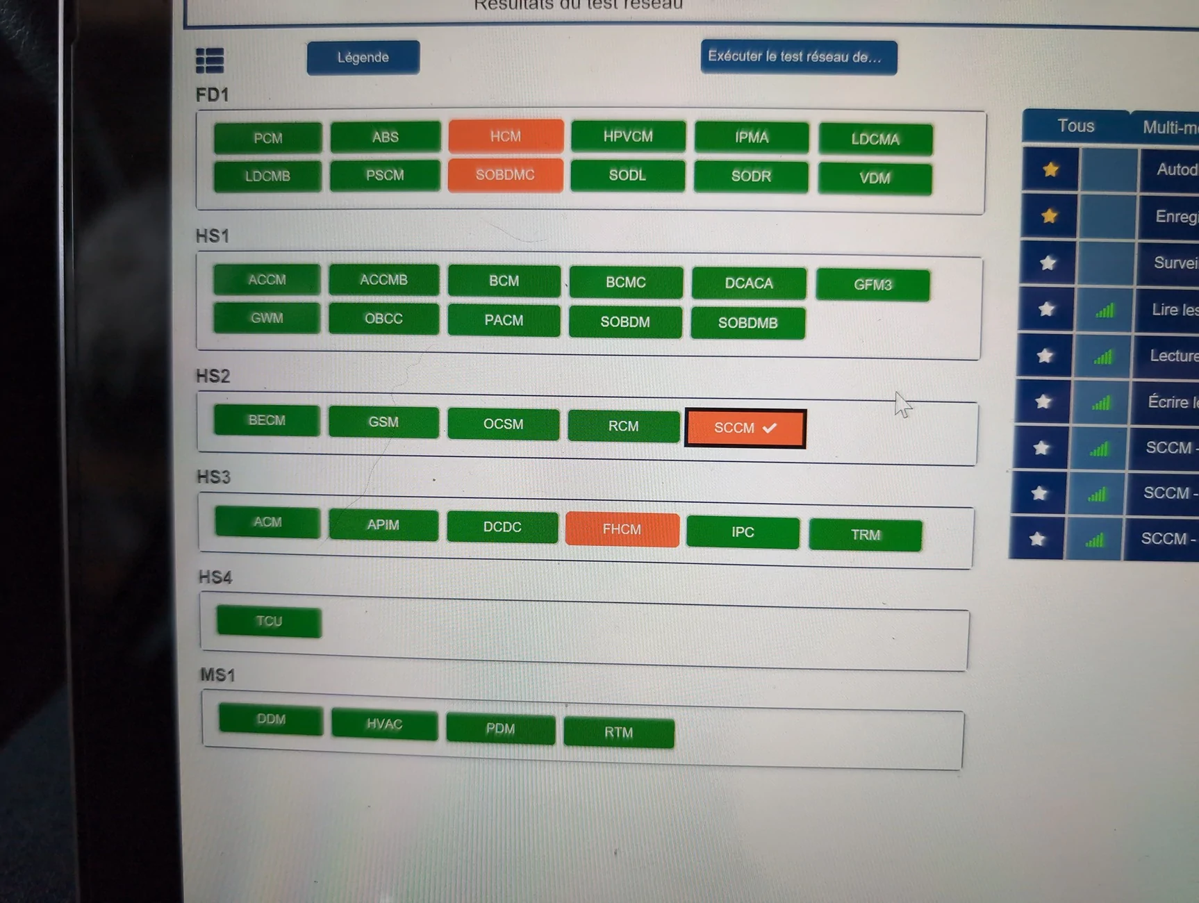

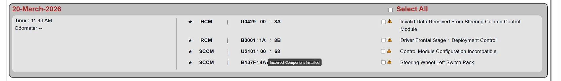

SCCM is unresponsive most of the time — when it does communicate, it shows the following DTCs:
B137F - Steering Wheel Left Switch Pack - Incorrect Component Installed
When it communicate SCCM Easy Mode shows "50 - Incorrect value or not configured" for Steering Wheel Switch Left
HCM shows U0429 - Invalid Data From Steering Column Control Module

Most of the time he is gray and become orange and display the dtc codes. Do you think it would be possible to me to buy a new sccm module and then reprogram it with fdrs because actually up here the delay for lightning jobs are awful they gave me an appointment for the 6th of may even if my 12v battery is swollen and give high drainage alarm 😅
Ok, so if it's not purple, at least the SCCM is not bricked. Strange that it keeps losing comms. You sure you wired everything correctly and there are no loose connections? The SCCM you bought now..... you sure it's the correct part number for this project? I've never done what you're doing, so not sure what the job entails.

You are clearly having a CAN communications issue with your SCCM. This sucks, sorry you are dealing with this, but you likely have a physical problem with your harness or the connectors with the CAN pins for the SCCM. Nothint to it but to physically dissassemble and inspect.
