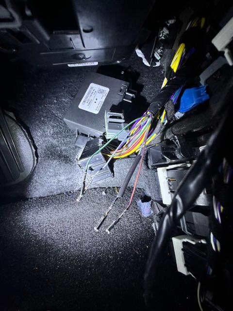

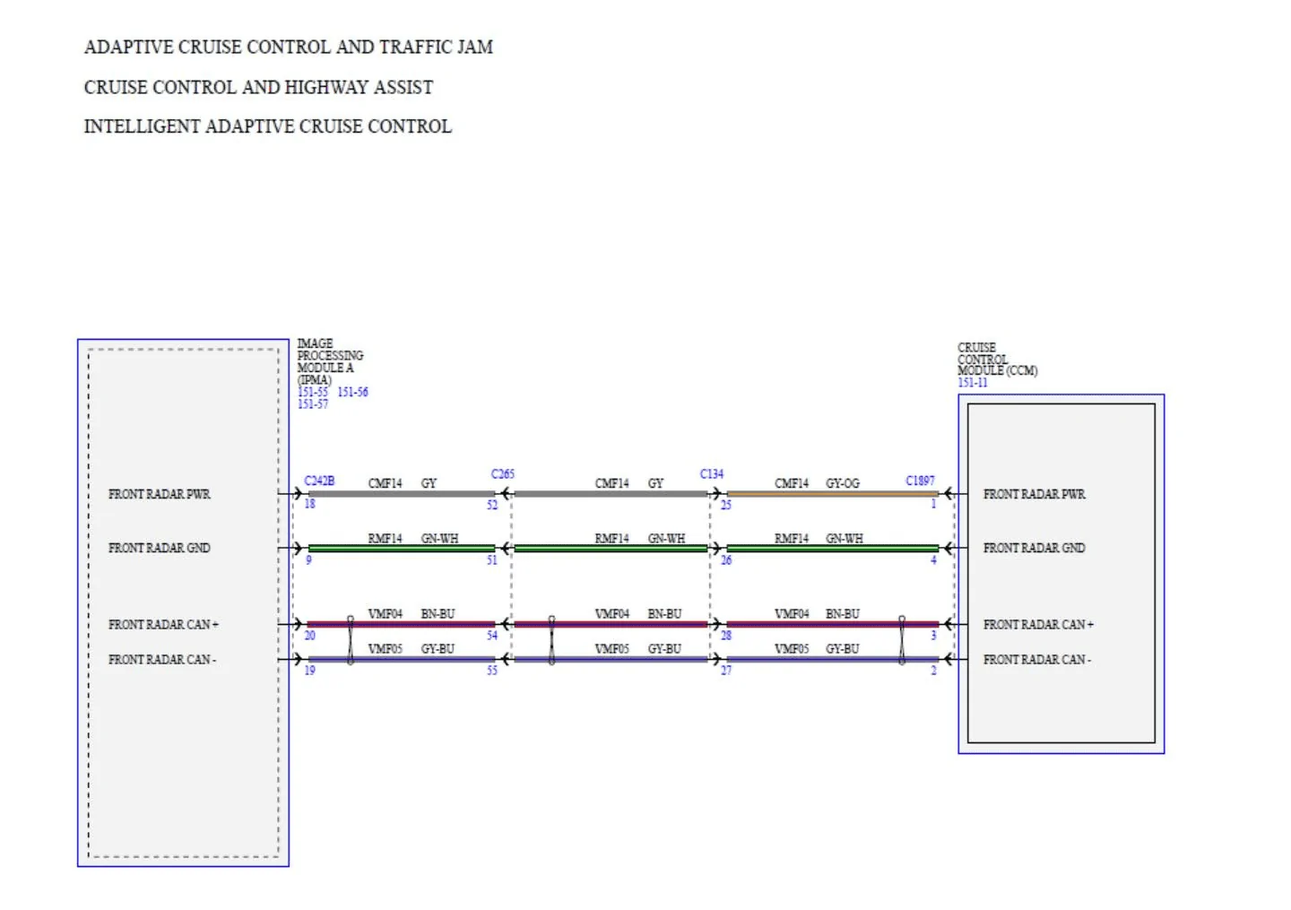

I tested and confirmed I had wiring from the IPMA to C265, but missing the 4 CCM wires from C265 to C134. I had already ordered the harness and liked the idea of preserving the IP rating and single point of disconnect for the bumper too, but the plugs were a bit of a pain so I certainly don’t blame anyone who wants to go straight to the IPMA though lol. Although I’ve read it‘s possible, I don’t see how to mount the CCM without removing the bumper completely without switching up some mounting hardware so at that point might as well just stick with the factory connector and get the harness regardless of where you go from there imo.
Parts list is the same as what Brotato used In post 1. I re-pinned the male side of C134 at the bumper using Molex WM14271CT-ND from DigiKey and ran the same wire through the same spot in the firewall that Zach did here. I did this before his video but that does a way better job explaining the connector.
Ford F-150 Lightning DIY: Installing ACC (Adaptive Cruise Control) and LKA (Lane Keep Alert) to 2022 F-150 Lightning XLT 6A74DFA9-473A-4CF3-A25E-78AC8A95230C
The male side of 265 looks like a pain, and I didn’t have the right pins to crimp the wires into the female side, so instead I de-pinned the 4 wires from the female side and used some inline wagos. 221s fit the whole pin lol. Will probably redo that with the actual pins next time I’m under the dash. Didn’t have to unmount the FHCM, but did unplug the cables going to it to allow for much more slack while working with C265.

Success!
@steveje and I have been working on this and I finally got it working last night.

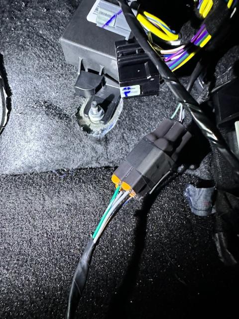

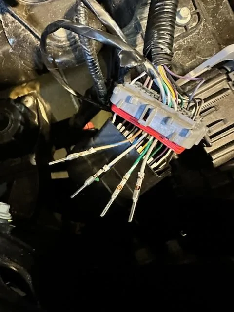

As I mentioned earlier we both discovered we were missing the wiring between C134 (Main Front Bumper Level Lock Connector) and C265 (Passenger Kickpanel 50+pin Lever Lock Connector)
So since I'd already installed the bumper harness, I decided to go full OCD on the missing piece and match the factory wiring color scheme and maintain the IP rating and connectivity of C134.
Here are the pins I ordered:
https://www.digikey.com/en/products/detail/molex/0194170028/3183227
Here is the wire I ordered:
https://4rcustomswire.com/products/20-gauge-txl-wire-6-striped-colors-each-25-foot-long
I did all this post bumper off work. Once the backup/PAWS speaker is removed you can easily get to C134 with one hand and work the lever to unhook it and bring it into the frunk bay for pin work. For the backup/PAWS speaker removal I've been using a 1000Ohm resistor since the week I got the truck, but after removing it during this job and discovering that it's just a 4Ohm speaker I discovered you can replace it with a Ford Injector and get the IP rating of the connector back :)
So, here is a video of how to add the pins to C134:
https://photos.app.goo.gl/CCwe7fXHhBoCezgz7

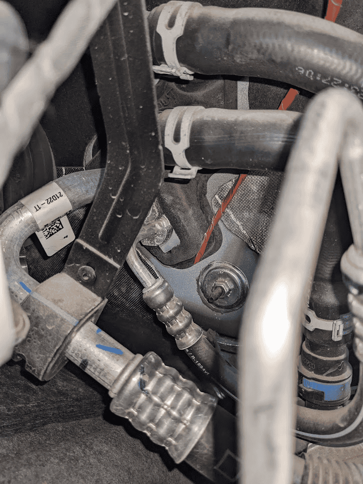

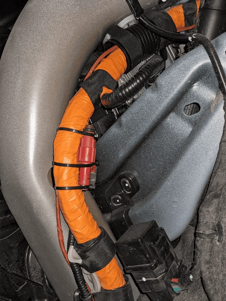

Here is where I went through the firewall:

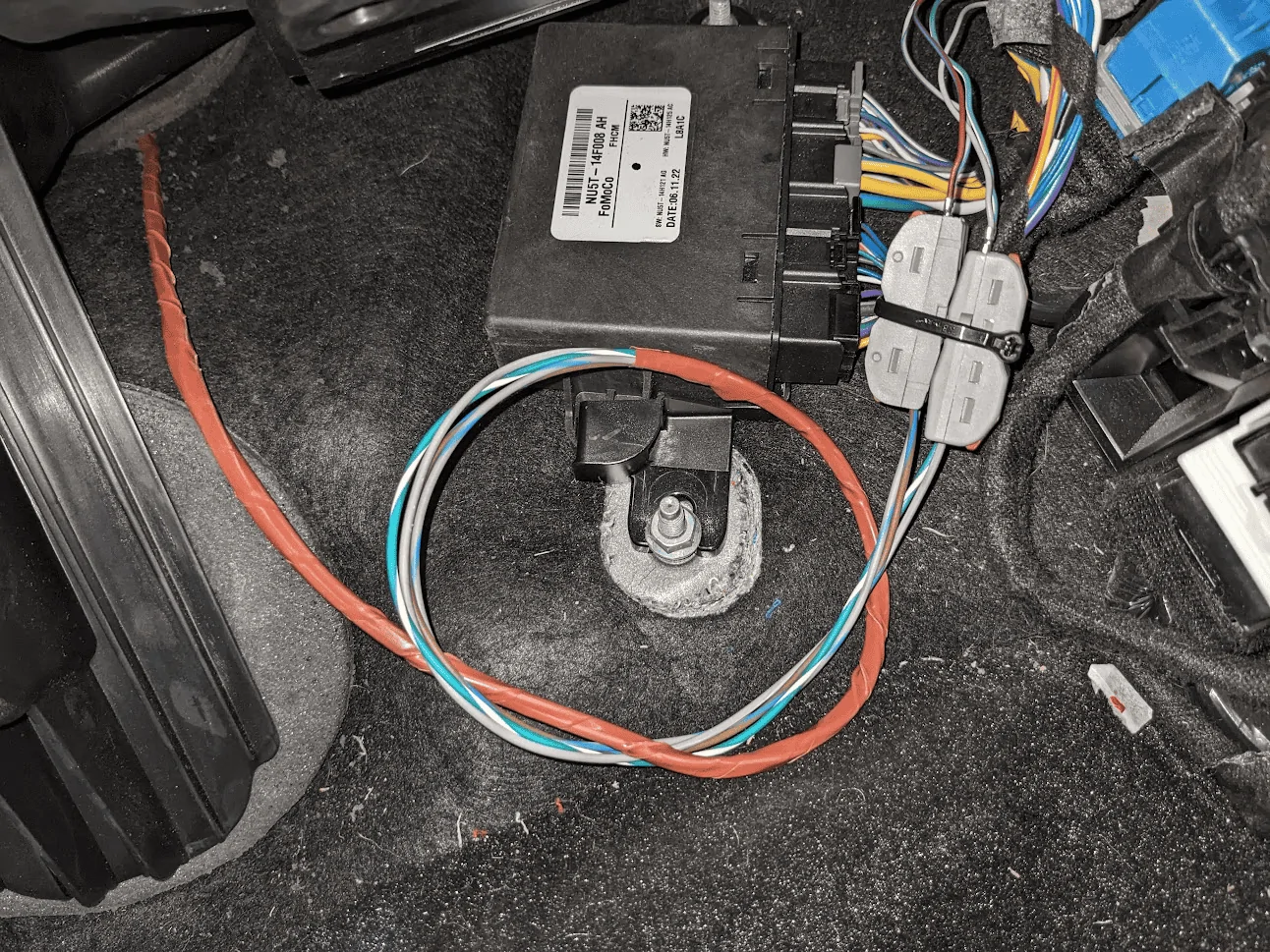

And here is the final splice to the factory pins I extracted from C265:
If you're following Jason's original post just know that you will not receive power to the CCM until you execute the IMPA changes as that module supplies power directly to the CCM. You can basically execute all module changes except the VIN -> CCM, then you can rediscover and find the module.
Also, make sure you don't forget to level the vertical of the CCM:
and clear all DTCs before attempting to calibrate the horizontal in FORScan.
Good times:
What did you guys use to wrap the wires through the frunk? I purchased a shrink wrap tube, 1/4 inch, 20 feet, but it was not wide enough for all of the wires, plus it has some adhesive inside. Couldn't feed the wires.
Did you use some sort of tape to wrap them, or is this a shrink wrap sleeve of some sort. Hope this isn't too stupid of a question.
Thanks.
Amazon sells harness tape made of fabric. Tesa's Most Advanced High Heat Harness Tape 51036 Mercedes, BMW, Audi, VW https://a.co/d/6ZigS0P

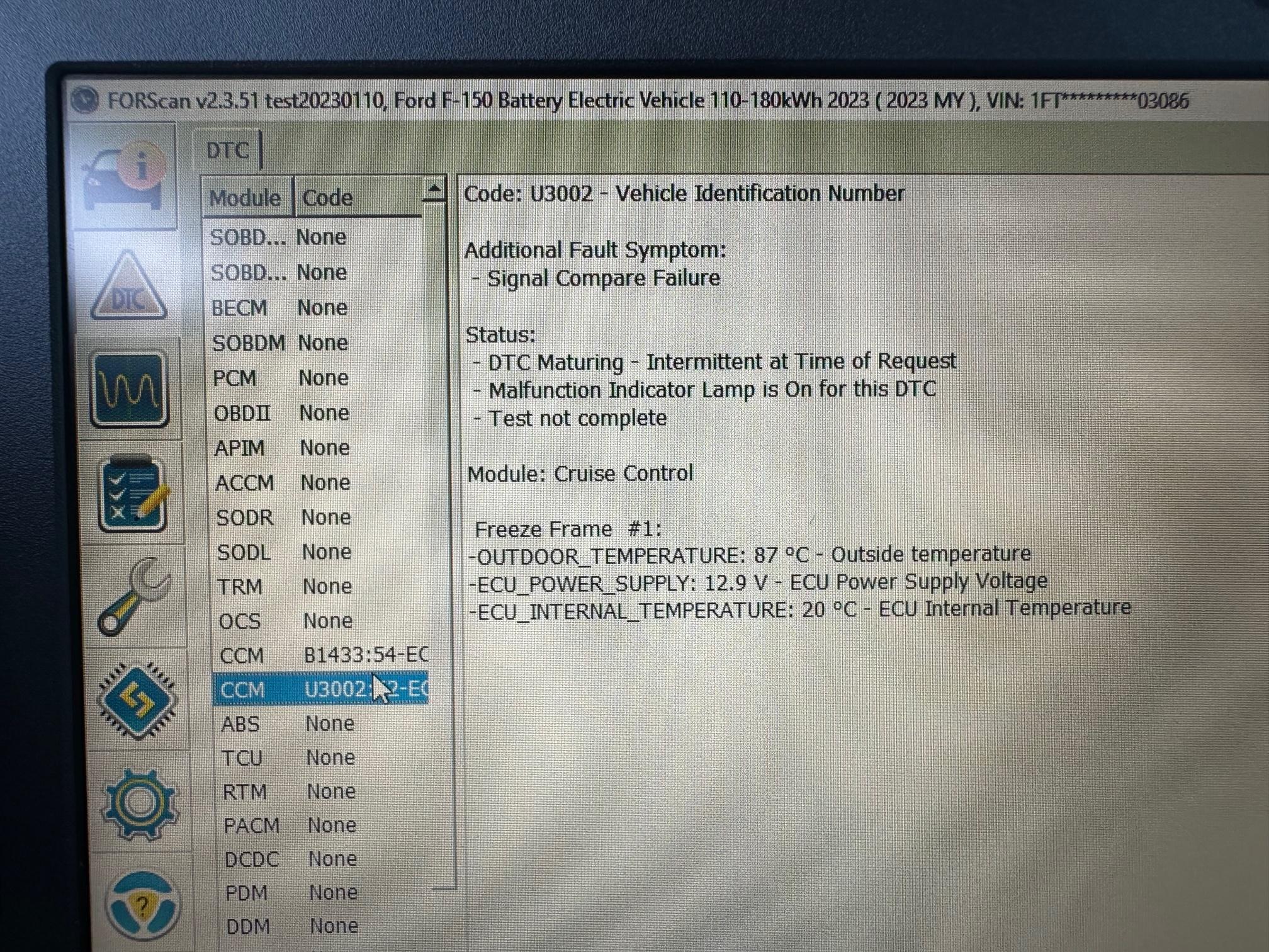

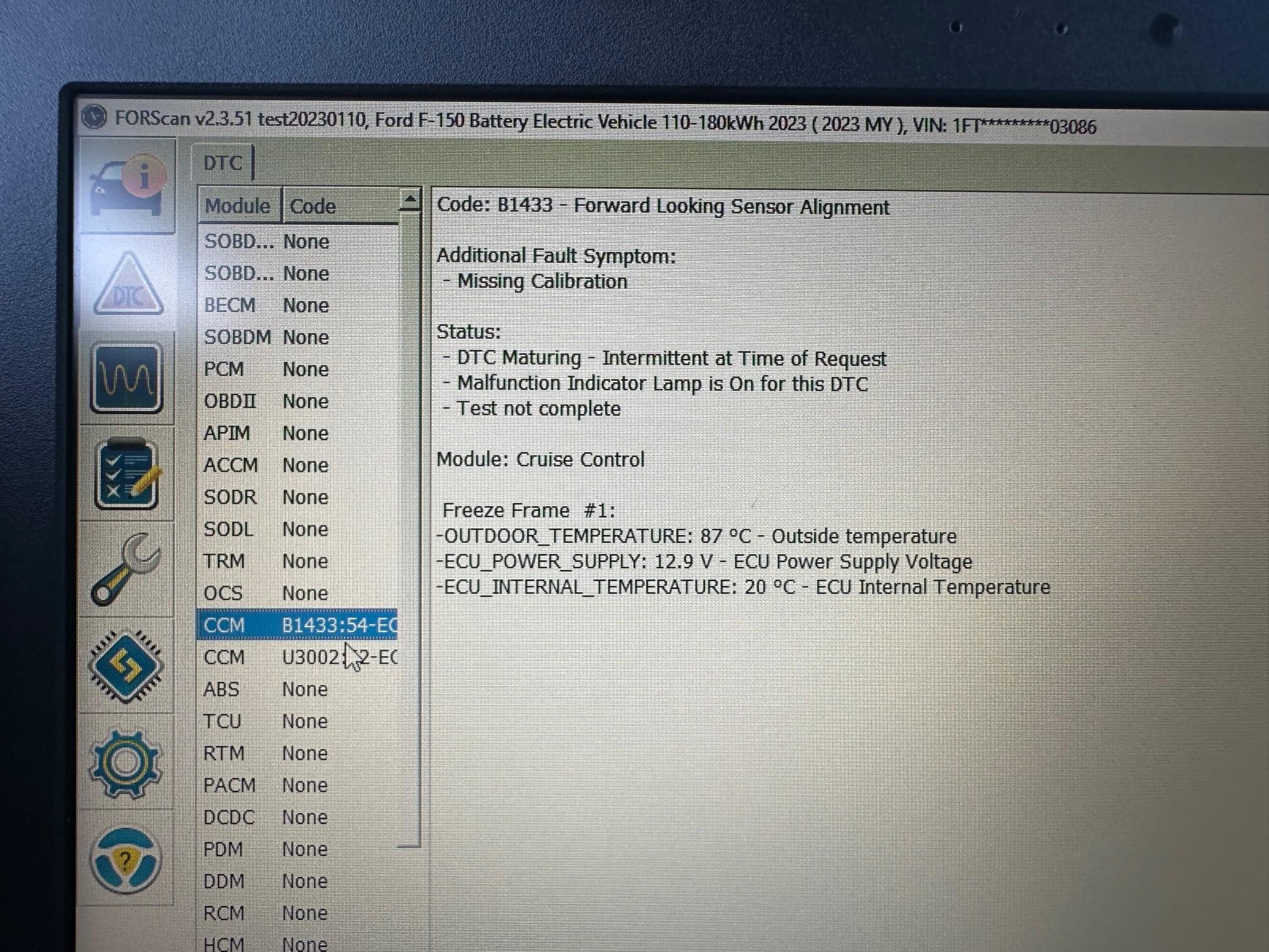

I was able to get everything changed in forscan. No issues with it not seeing the CCM, but now it will not calibrate. I start the calibration process and it just stays at 0%. I've driven for 20+ minutes over 30mph with cars in front and it doesn't go past 0%. I restarted the truck twice and still it won't budge.
That said, I do have 2 faults that may have something to do with it... I have not been able to clear two DTC faults:
- CCM U3002 (Vehicle Identification Number)
Ford F-150 Lightning DIY: Installing ACC (Adaptive Cruise Control) and LKA (Lane Keep Alert) to 2022 F-150 Lightning XLT IMG_8502
-CCM B1433 (Forward Looking Sensor Alignment)
Ford F-150 Lightning DIY: Installing ACC (Adaptive Cruise Control) and LKA (Lane Keep Alert) to 2022 F-150 Lightning XLT IMG_8501
Anyone have a similar experience or any ideas?
I had to program my CCM twice. Try resetting it under the same menu and double check your settings.
Thank you, that did it. I found an error in my values that was causing the issue.

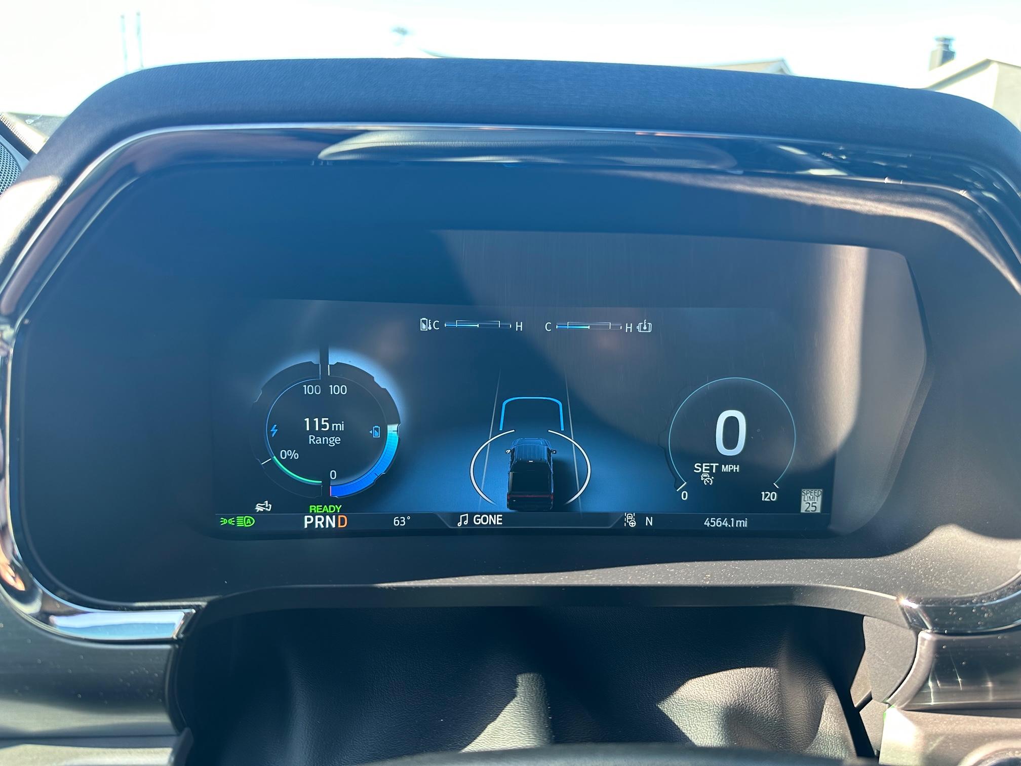

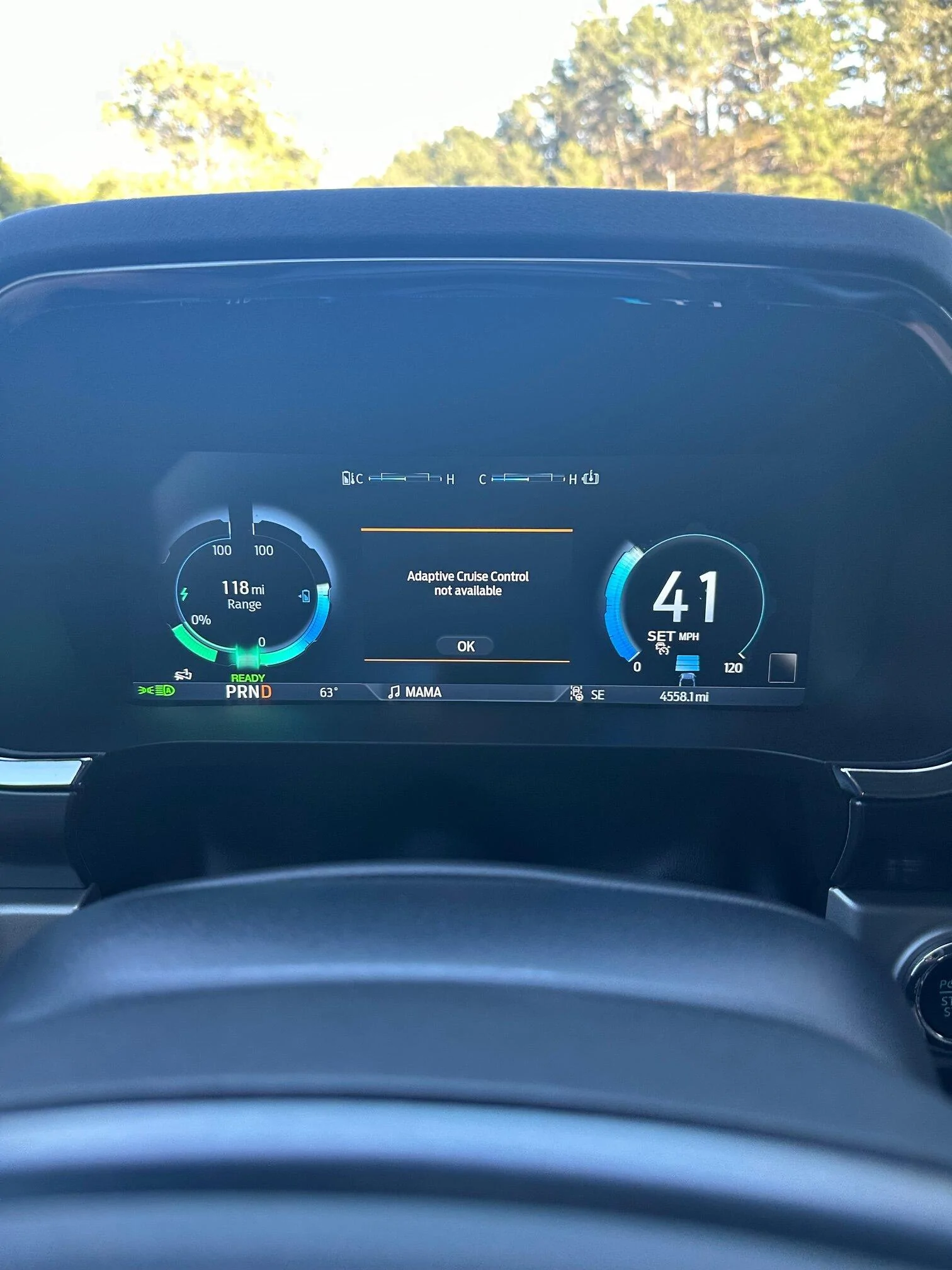

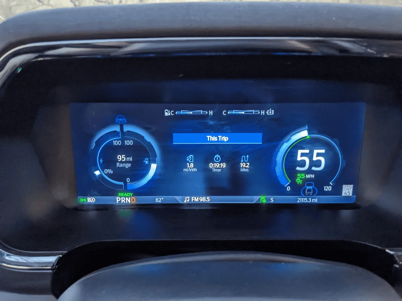

I was able to calibrate successfully, no more errors on the dash. YAY! Now when trying to engage ACC I get an error on the dash that says "Adaptive Cruise Control not available". I've tried on different roads, with different speed limits. With cars in front of me, without cars in front of me and the result is the same.
I do have one error in the DTC related to not having the right stock and enabling automatic wipers. Could this have something to do with it? It's in the BCCM module I believe.
Ford F-150 Lightning DIY: Installing ACC (Adaptive Cruise Control) and LKA (Lane Keep Alert) to 2022 F-150 Lightning XLT IMG_8505
Anyone else have this issue, or any tips to make it work? I appears as though everything else is working(see attachment). So I'm not sure where the issue lies.
Yep, same exact message that made me reset my CCM and try again.

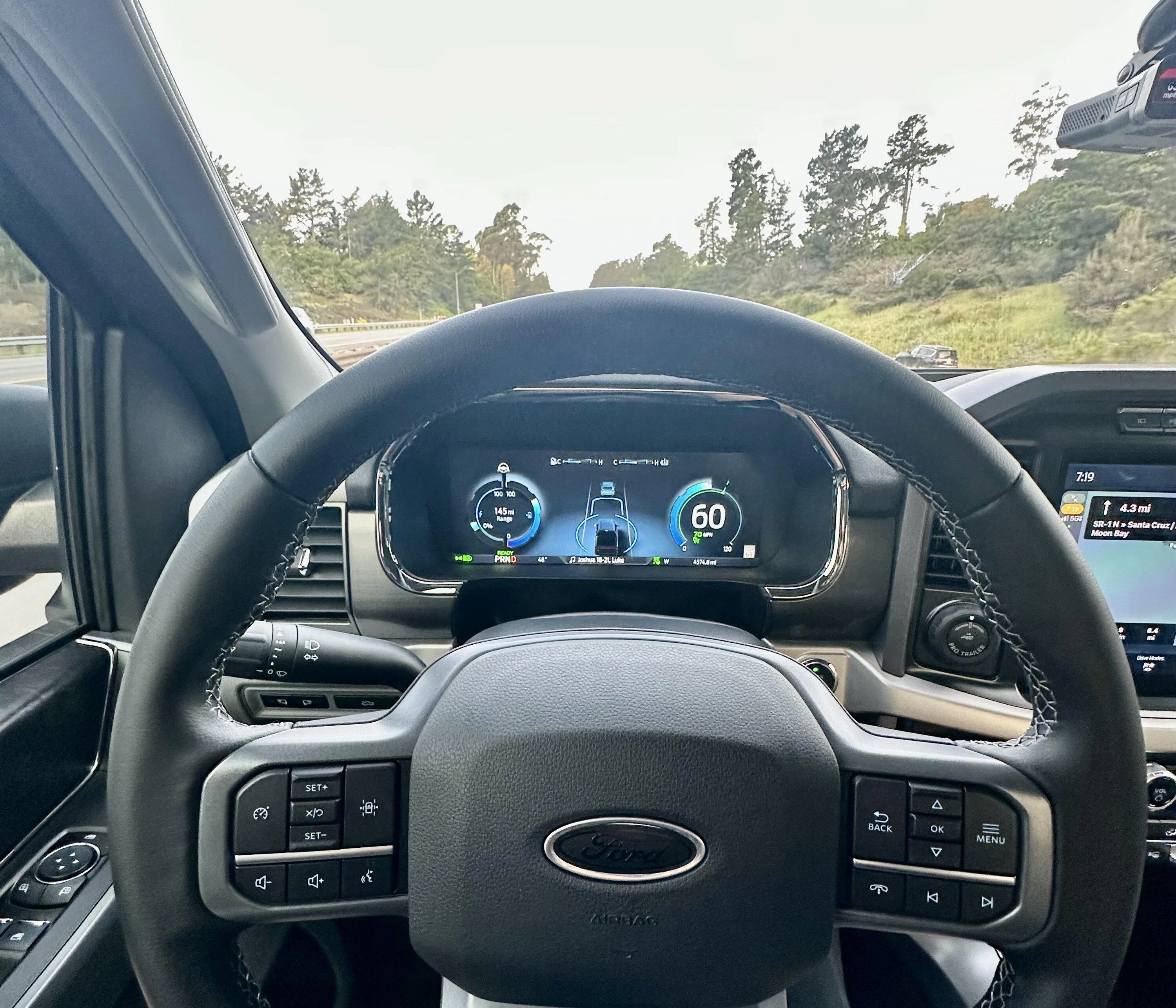

Update: It works!!
I ran out of time yesterday, so I had to stop before I got it working. This morning, I loaded my forscan setup in the frunk so I could mess with it further at my office. While driving to the office, I tried turning on ACC and it worked! I’m guessing it just needed a full reset. I used it on the 18 mile drive and it’s pretty solid. On the highway I had no issues. On some smaller side roads it definitely freaked out a couple times as the lane lines are nit
