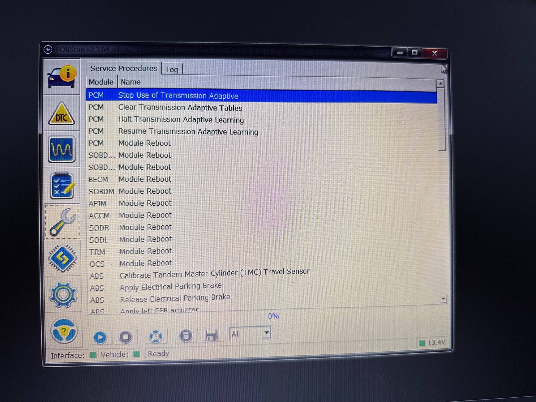

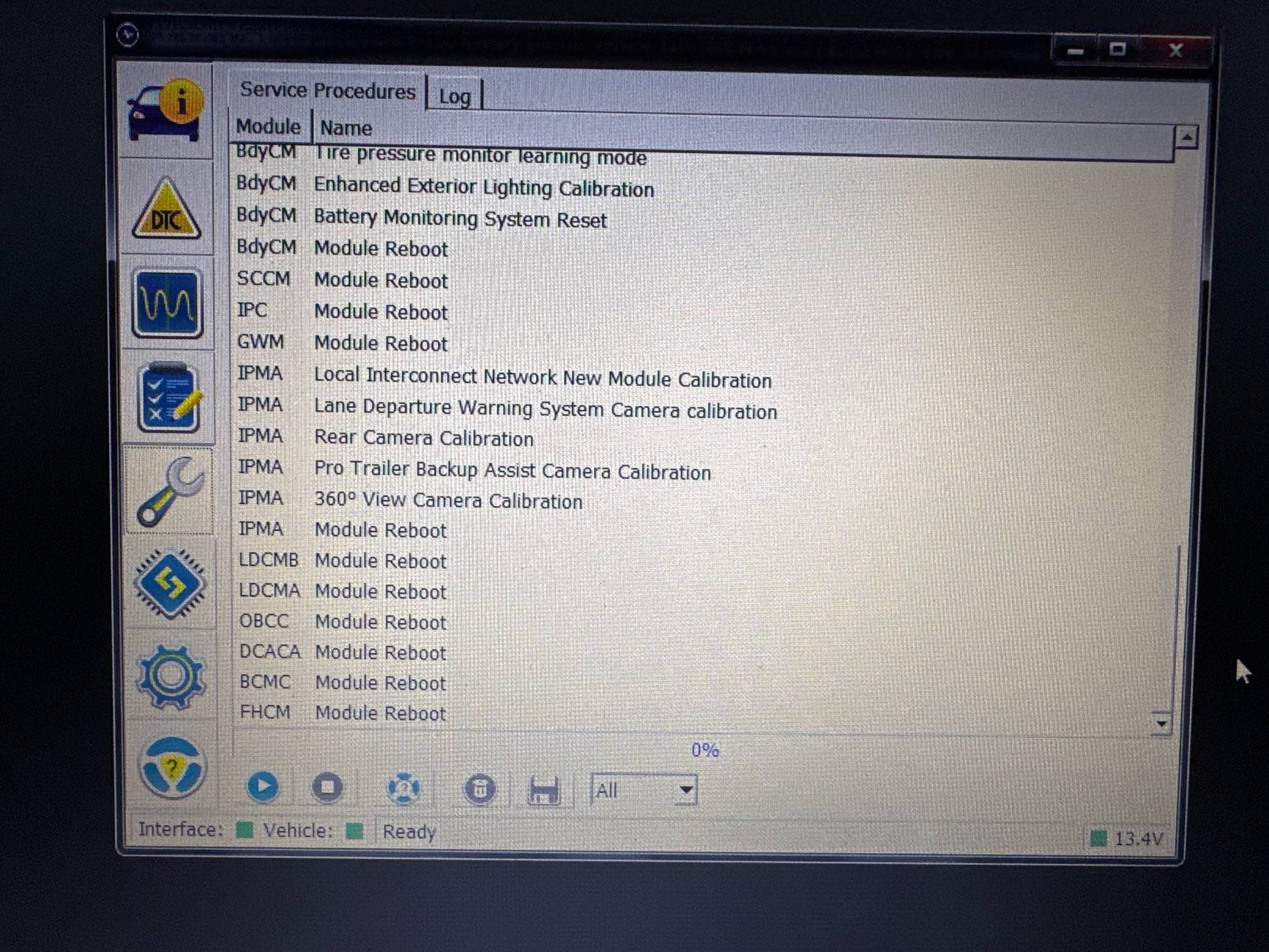

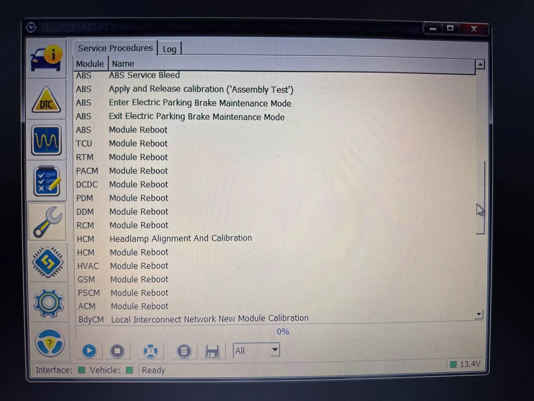

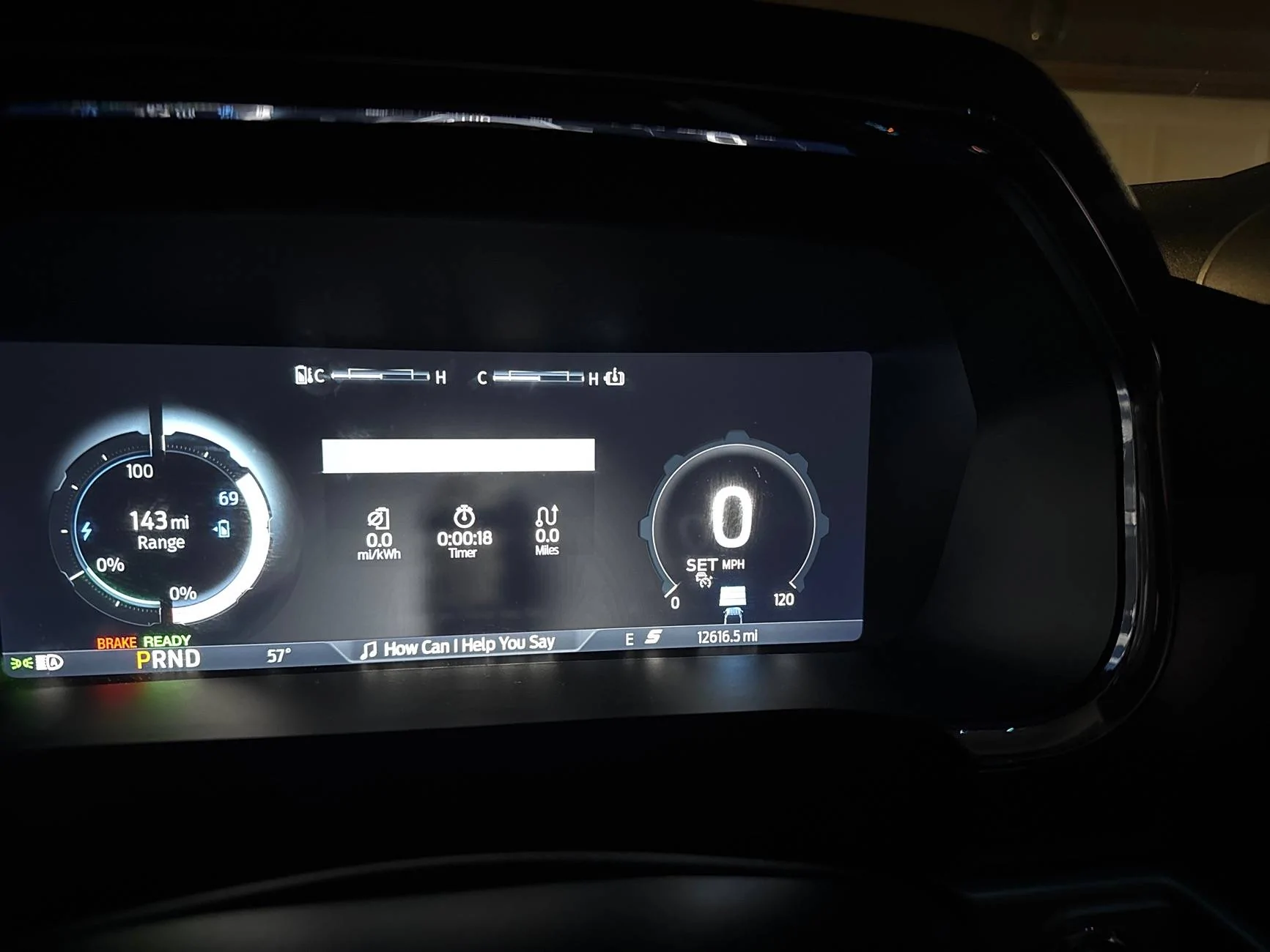

no dice, but i have no codes on dash. but i havent installed the steering wheel switch yet.
You have something happening. Your last picture shows the distance stripes in front of the tiny picture of the truck underneath the speedometer.
If you haven't got the CCM to show up, make sure you follow this section of the instructions:
IMPORTANT: Disconnect FORScan and turn the truck completely off, then back on. Reconnect FORScan BUT do not use the saved profile. Let it rescan for all modules.Connect to IPMA and take a screenshot of the following values
706-19-01 xxxx xxxx xx--
706-19-02 xxxx xxxx xx--
706-19-03 xxxx xxxx xx--
706-19-04 xxxx --
After picture or screenshot, change the following to turn on the CCM:
706-02-02 x**x xxxx xx— (04 to 05)
IMPORTANT: Once again, disconnect FORScan and turn the truck completely off, then back on. Reconnect FORScan BUT do not use the saved profile...
Then continue changing the appropriate values for your truck

i do not have ipma

Ummm..... You have to have an IPMA module. It controls a lot of systems in the truck.
yes i figured but it might have s different name. the closest to the name is APIM

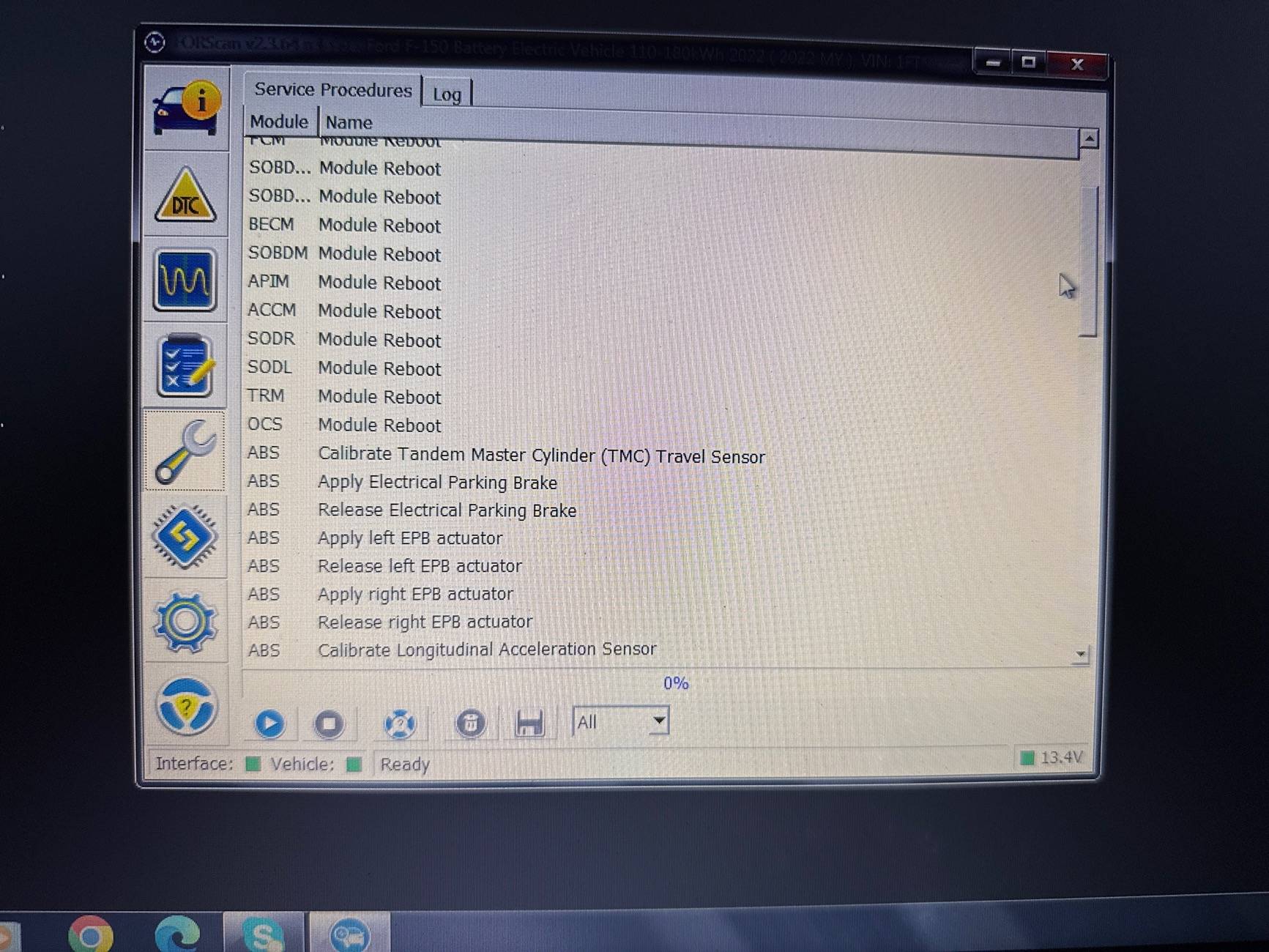

ok i did all you said and thanks for the help, after deleting it a few times it popped up?‍♂

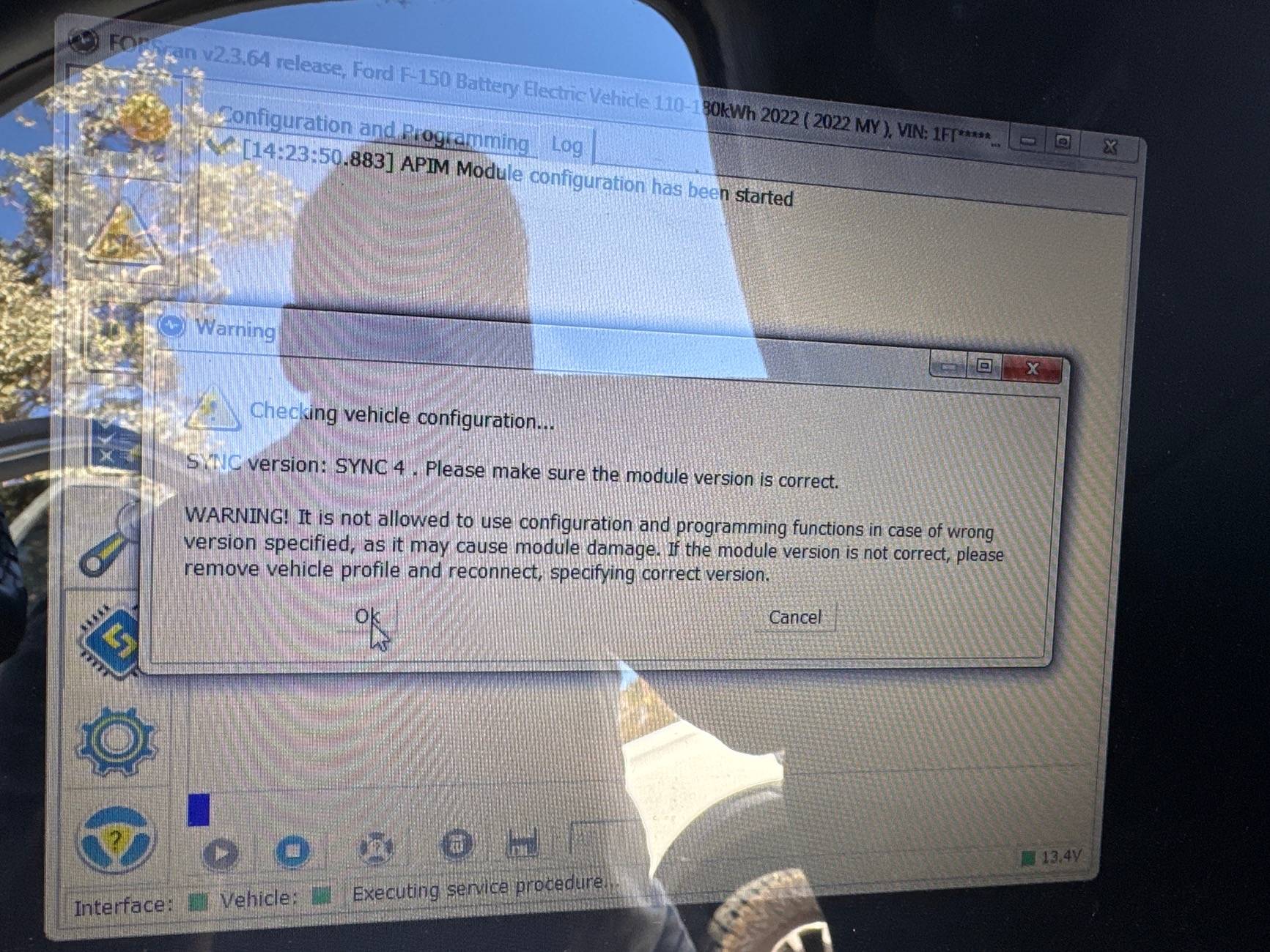

ok i got the horse before the cart this is what i have now
Ford F-150 Lightning DIY: Installing ACC (Adaptive Cruise Control) and LKA (Lane Keep Alert) to 2022 F-150 Lightning XLT image
2,753
3,897
Fine to click Ok on that. I get it too when changing the APIM.

ok i deleted and reinstalled the program on my computer im going to attempt to see if the c-cm comes up. I tried changing values and then doing easy mode and its still not coming up. I’ll keep you posted, this is not easy. I tried driving around town for two days and still bananas
