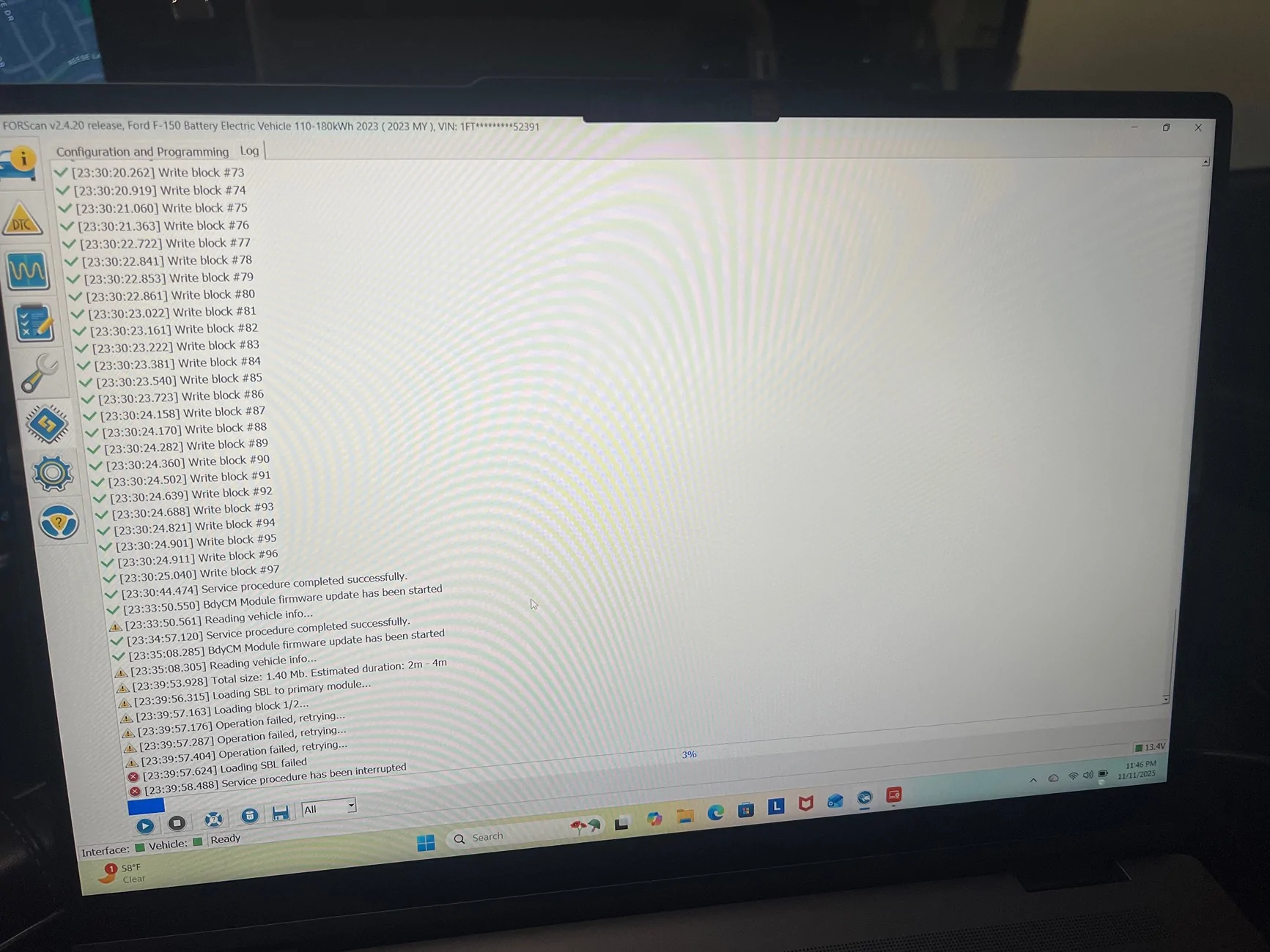

Hey everyone, just tried to do the firmware update and it failed. Heart skipped a beat. Any help?
See picture.

Write a detailed email to: <[email protected]>
Include pictures,
Reload the files into the MFA dialog and screenshot that as well to show them what you are trying to do.
