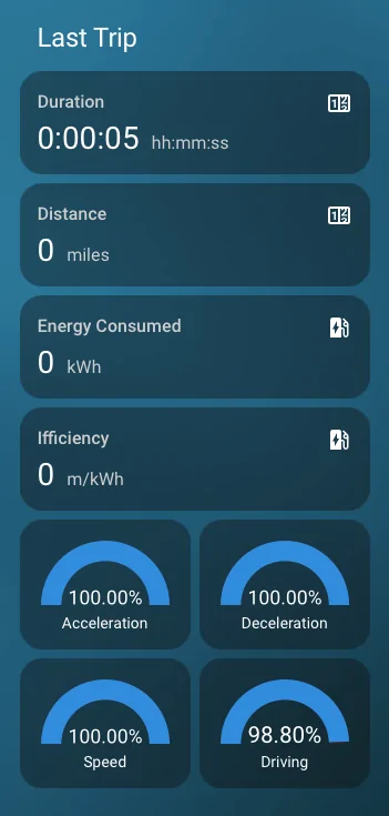

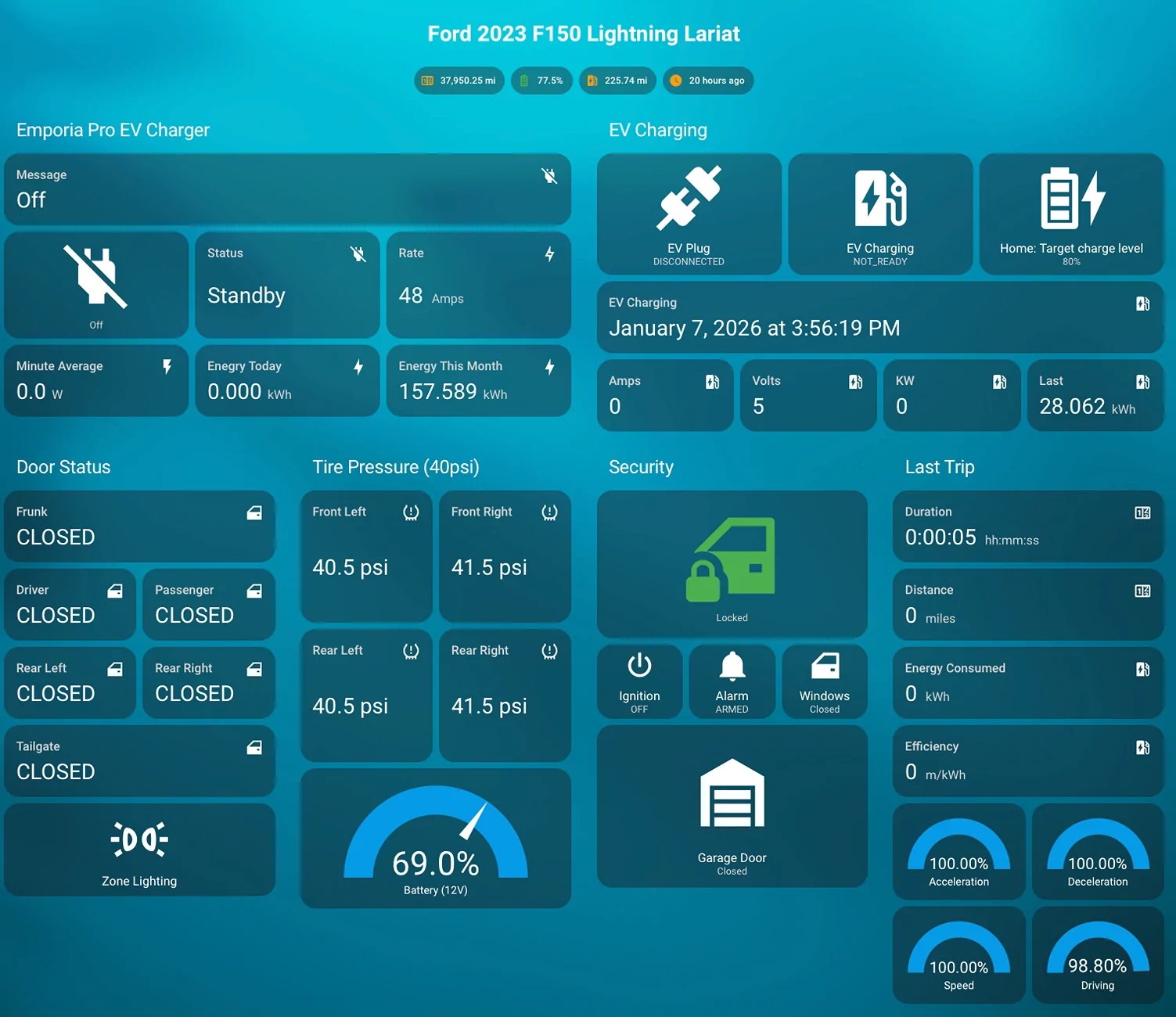

I'm using the Fordpass Home Assistant Integration from here: https://github.com/marq24/ha-fordpass and have built out a pretty nice dashboard. One of the things that you can get from this, is an Acceleration, Deceleration, Speed and Driving score. Seems to be out of 100%. Anyone know anything about these scores and how they are calculated? Metrics shown are not great in this example as it would appear I accidentally remotely turned on my climate for 5 minutes yesterday which seems to have scrubbed the last trip information.

I don't know how they are calculated, but Ford has (had?) agreements with at least one Insurance company that they could be shared. There are options to turn this connection in the GUI. This was so you didn't need the Dongle connected to your smartphone for this kind of tracking.
I'm guessing the calculations were at least shared with or shown to hold merit for driver tracking at a minimum.

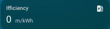

You folks in Georgia spell Efficiency weird LOL.
I have the same HA integration - will have to look into it.
You know, I would look at that every time I opened the dashboard and I thought "That does not look right" lol

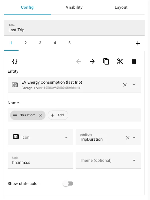

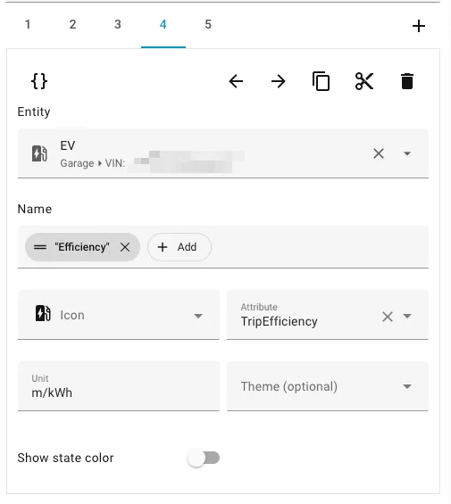

Where are you finding that data? Are you using the _lastenergyconsumed sensor, and the TripDistanceTraveled attribute under that and using a template to get the mi/kWh?
I'm not seeing this raw data (nor the Ifficiency ;) )

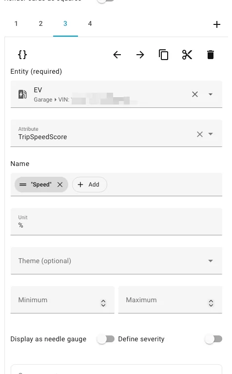

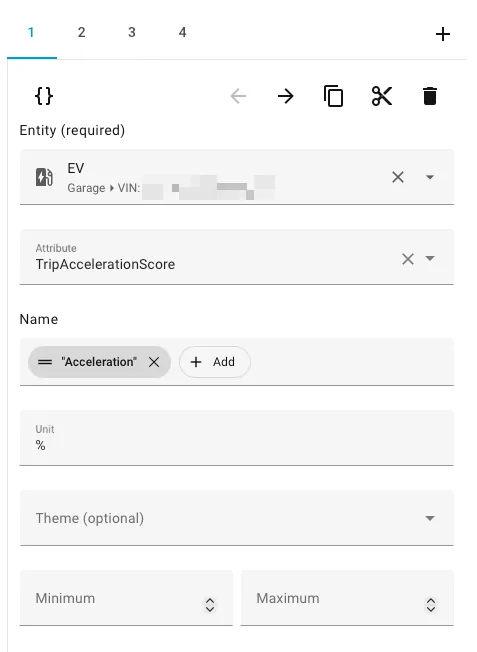

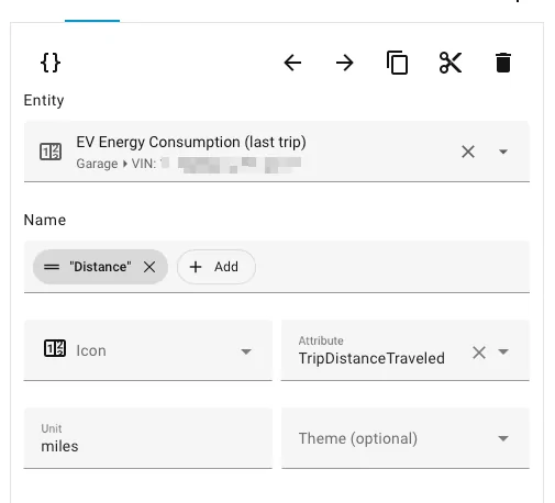

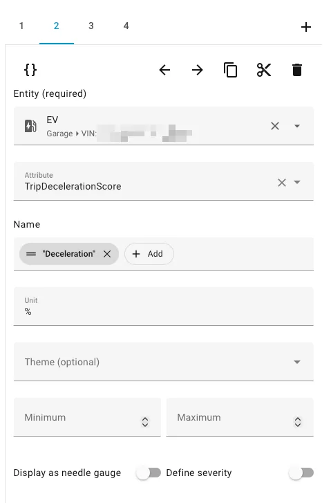

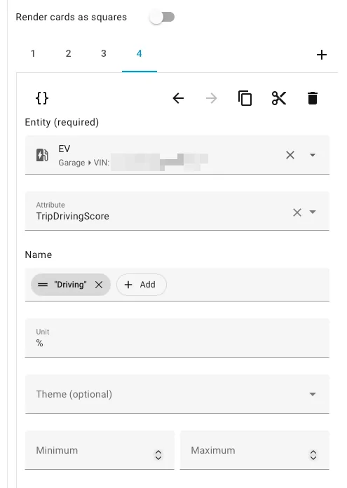

These are my cards:
