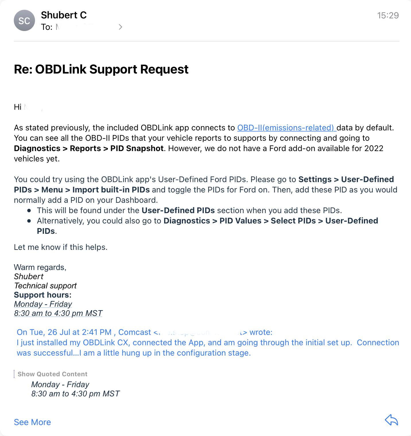

Here is the suggestion I got from OBDLink Support to access the Lightnings PIDs from within their app….:
Using these tips, I was able to sort through all of the ICE-related PIDs and identified what I think are the SAE EV-related PIDs. I’m now in the process of creating custom viewable dashboards within their app linked to these PIDs….and have no idea what I’m doing or what results I’ll see….
Someone smarter than me will probably make more sense of available PIDs, more here than I can list….
