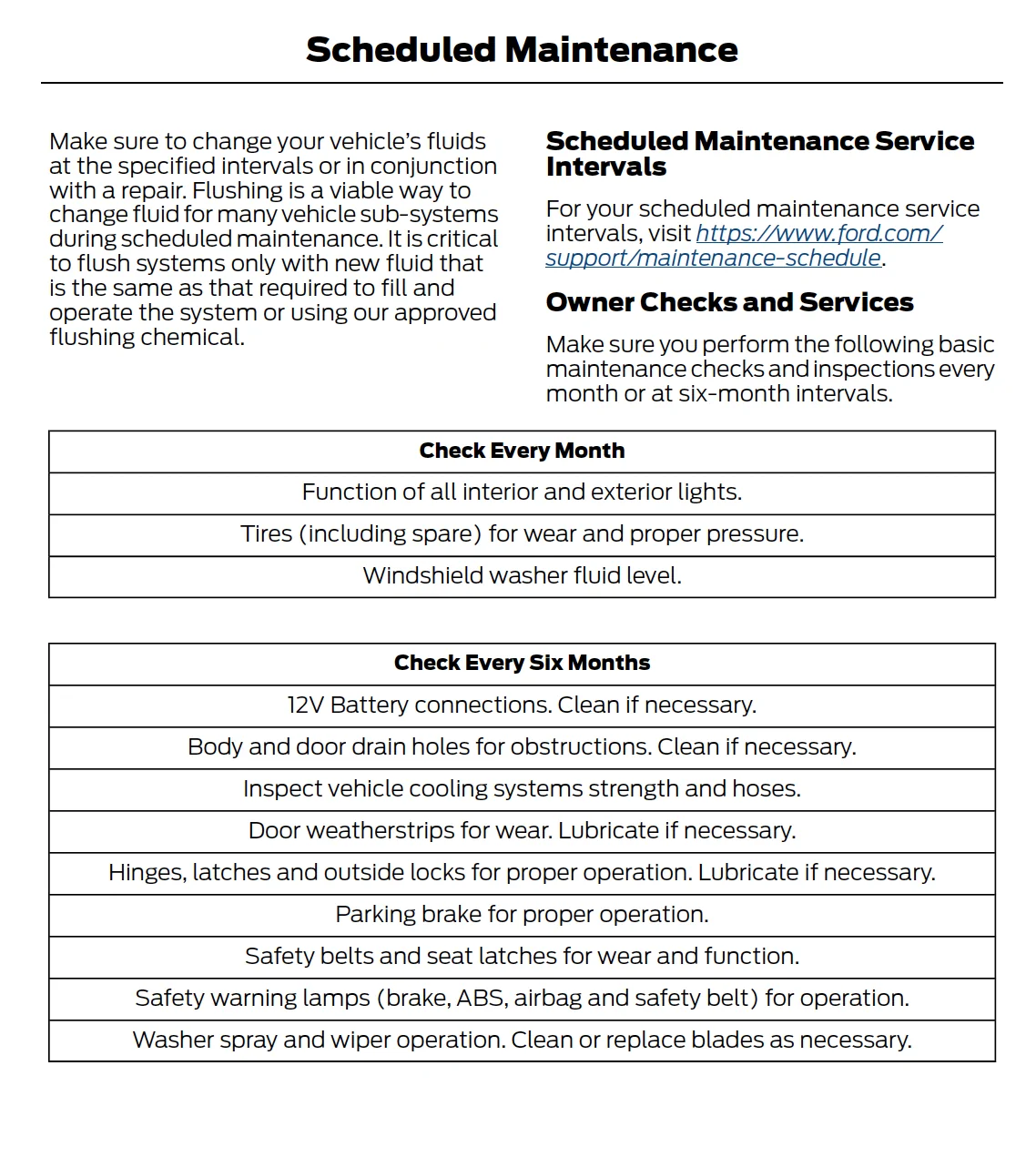

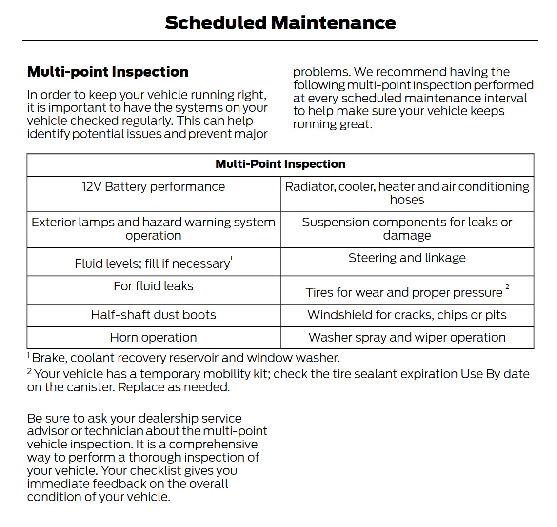

Over 600 page owners manual, and the closest thing I can find is changing the "transmission fluid" at 160k. Since we don't actually have transmissions, are we to assume this is the ev motor gear fluid?
Other than flushing the brake and cooling system fluid periodically, are we supposed to change the ev motor fluid occasionally as well? I'm assuming letting the ev motor fluid go unchanged for too long would ruin the motor, but I really don't have anything to base this on.
Any input appreciated.

According to the owners manual, 150,000 miles change the oil in the transmission, other than that it's just look at stuff, rotate the tires, replace the cabin filter every so often.
