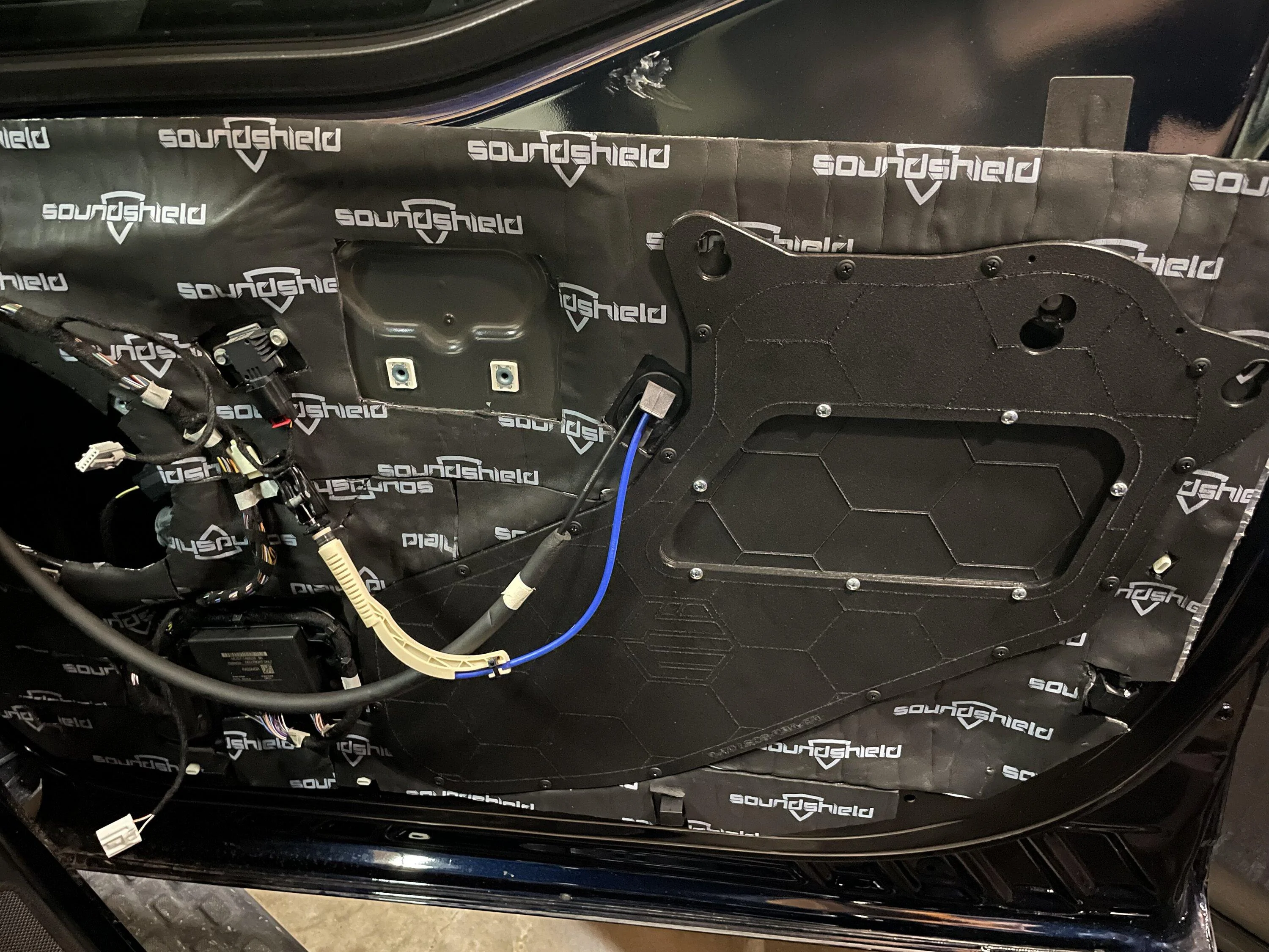

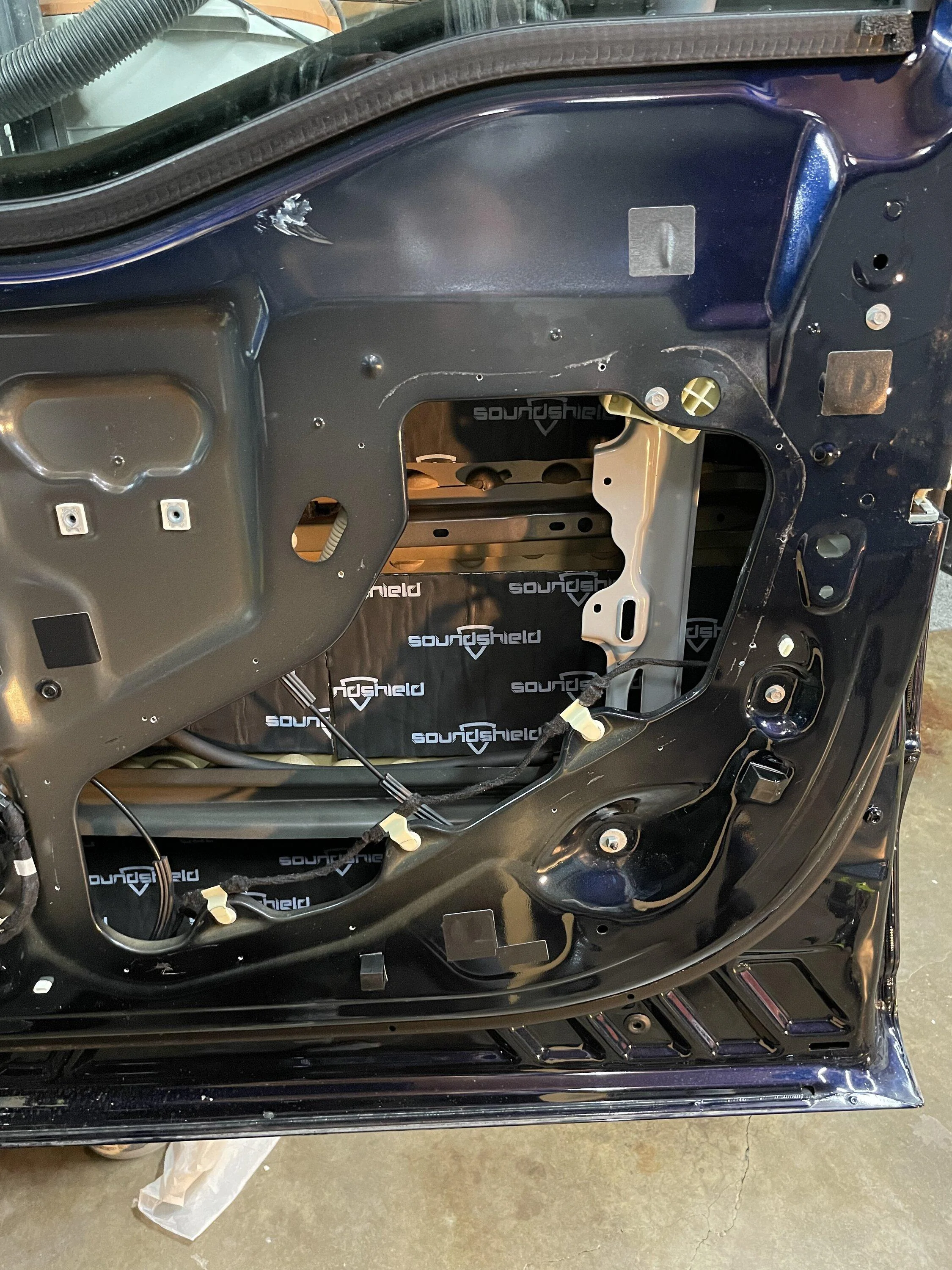

I pulled the trigger a few weeks back and bought a system from MTI. More than I ever thought I'd spend on such, but it arrived in 5 BIG boxes the last week or so. Luckily with a quiet weekend and I hope a couple of days off this next week I'm hoping to finish the install this week. It is time consuming if you treat the doors as they all suggest.

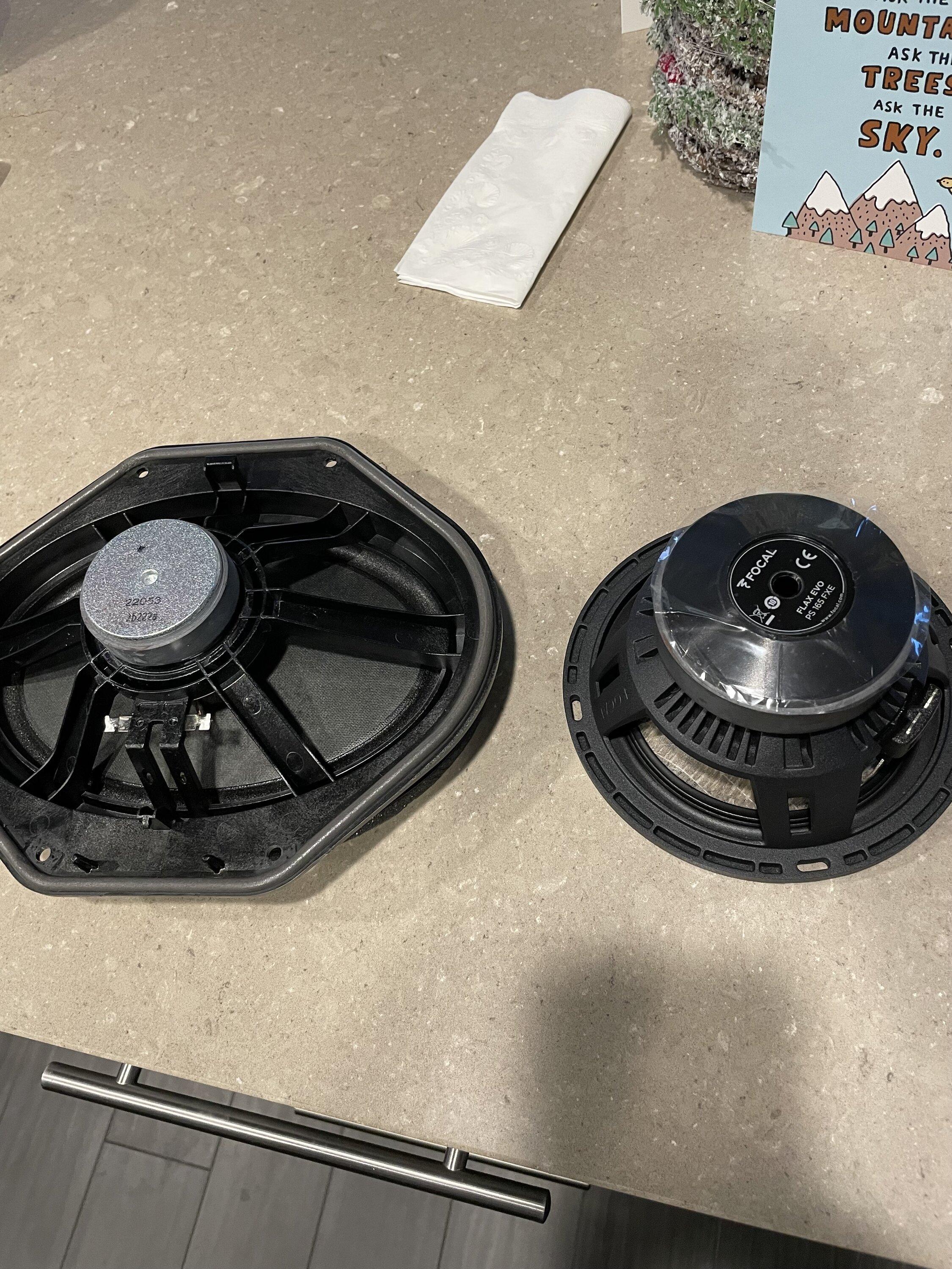

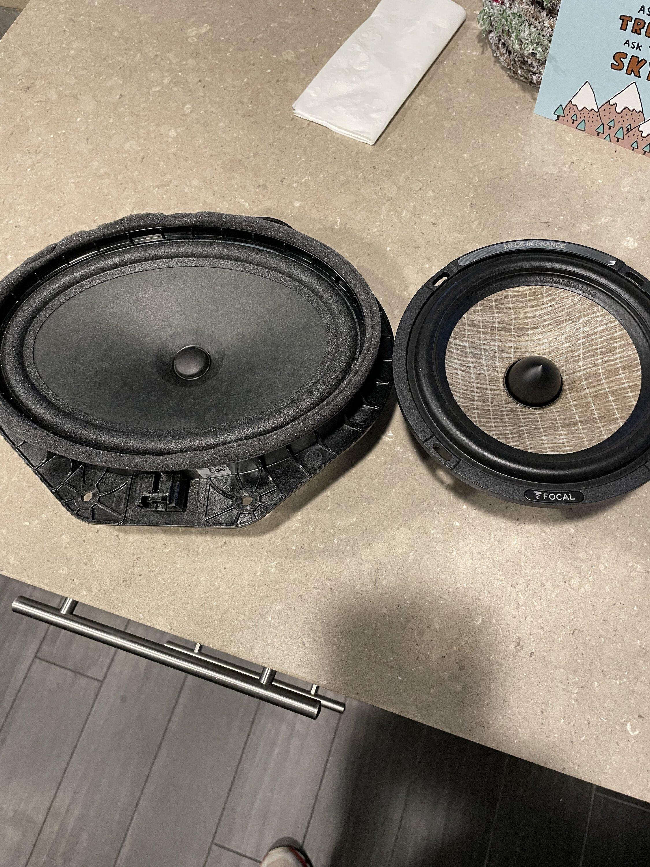

The rest of the doors will go just like this first one, I'll put a full post together after its done, but the factory speakers have such small "motors" / magnets, super super cheap.
I do want to get the 4 doors finished and hear new quality speakers with the factory amp just to see the difference they make - then I'll swap in the new amps and sub.

The sound material is behind the edge of the access panel too, but I don't know why they added the cut outs - those are machine screws with locking nuts, but there is no way to take the inner panel off without taking the bigger panel off. Both MTI and SGS - Sounds Good Stereo, use these panels (I don't think SGS has the inner cut out).
Knowing that both MTI and SGS use them even on their highest end builds I don't expect them to rattle (they are 1/4" thick) but I do have a couple of questions I'm sending to MTI about the inner panel cut out.

Correct - it is rigid and has about 16 screws in it. I'll take a picture of what came out - it is just a heavy plastic. I will note that it had a very good bead of sealant around it. Ford has done a pretty good job evolving the F150 and the build is good.
The insane thing I've found - for a DOOR - there is a HUGE amount of wiring and modules in it. Kind of blows you away. I don't see any reason they would put a "control module" (the big square one down low which I did not remove) in the door, seems it would be much better protected just inside the dash with any wires needed running to sensors in the door. Very near the middle of the door you'll see a sensor held in with two screws, I looked the part number up and it is a collision sensor that would trigger air bags, that one I understand.
