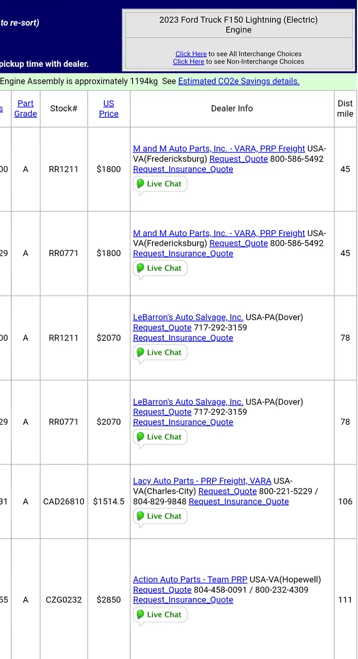

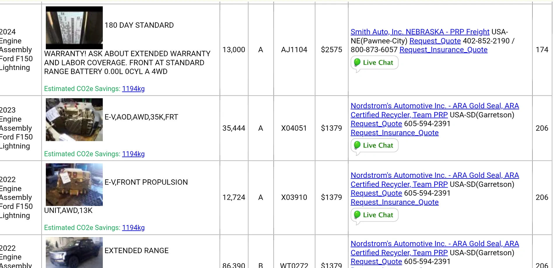

Additional info, perhaps useful for others here: the cost of shipping a used Lightning front motor from one of the breaker / recovery yards listed in post #7 above, from North Dakota to Northern Virginia is quoted today as just under $500, i.e. reasonable for a heavy motor.
I didn't know your location in post # 7. But I just researched again using 22201 area code and there are local options for you. Let me know if you need help searching that website.
