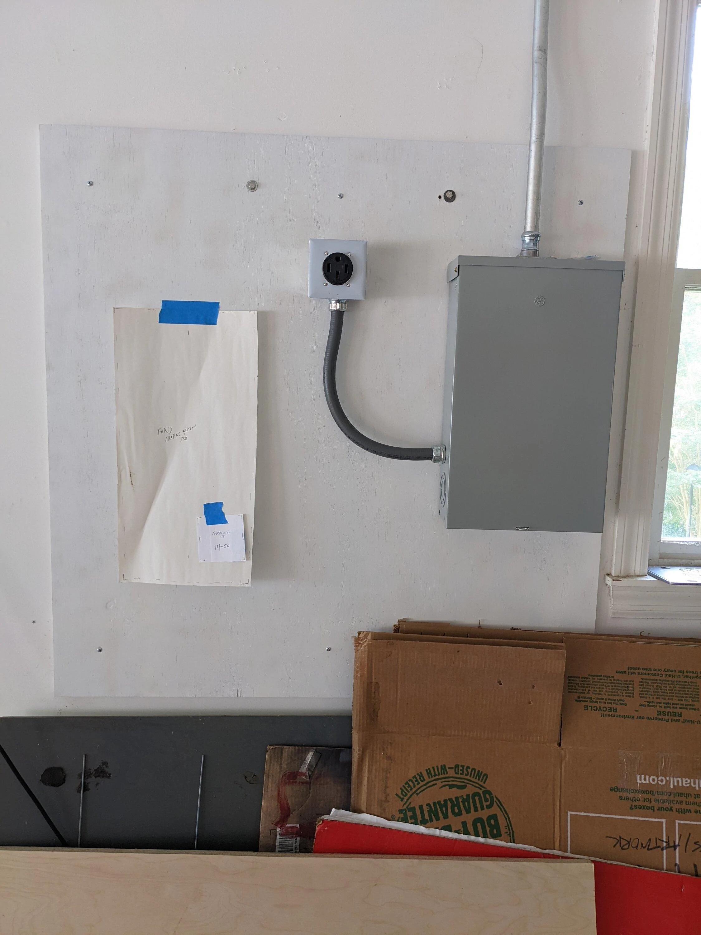

Now that my FCSP is enroute to me, and after reading about the heat-developed and related shutdown cycling issues, I am evaluating the mounting configuration of my FSCP especially in-light of Ford planning to increase the safety shutdown limits by ~10 deg. F to address the cycling issue.
I need to surface mount on the garage interior of an exterior wall. Should I consider having my electrician use a FR backer-board or other wainscoting? Any other suggest from this learned group would be appreciated.
