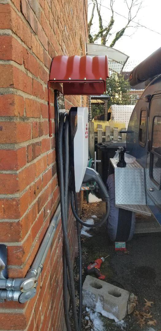

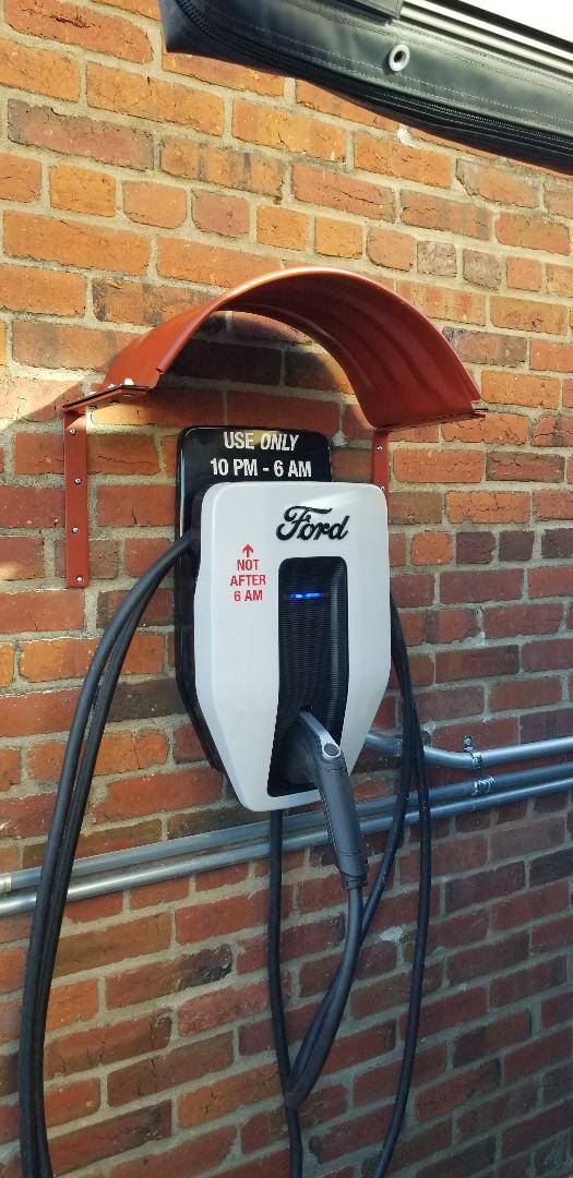

I was worried a bit about eventual environmental impacts on the Ford CSP mounted out on my driveway, despite its factory weather-proofing... things can fail over time with constant exposure to water and temp swings and snow and ice.
To mitigate this, I found a 24-inch basement window well casing at Lowe's, painted it and two L shaped support brackets to match the solid brick driveway wall, and mounted it high enough to A). minimize cord coils to two, and B). high enough to be at / above the driver's eye level rather than at vehicle quarter panel level for whoever will park here in the future.
The mini-awning now does a great job so far at keeping the rain / snow / ice off. Also, the holster port on the FCSP is now high enough to make it easy to engage and visually confirm that it's stored securely. It's also high enough to make it more difficult to drop into snow, etc.
I post these pics here to give others ideas...
