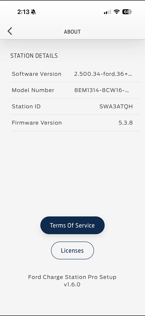

Update: I discovered, perhaps because of the firmware update, my FCSP got connected to a different, distant mesh router on my LAN and was on its 5 GHz band. So I changed my router settings to constrain the FCSP to 2.4 GHz and to connect to the TP-Link Deco mesh unit just on the other side of the garage wall from the FCSP. The Deco app shows the FCSP now has a very strong Wi-Fi signal. Still getting Connection Lost to Ford Servers, and tried again to change my charging rate. No can do now, so the Ford server connection must be essential for derating charging current.
One thing I'd be curious to know, @tearitupsports. If you call up the Charge Station via the menu item in the Ford app on the Charging Tab, does it say anything there other than "Connection Lost?" And, perhaps you haven't tried it yet, but can you also successfully edit the charging rate to something less than 80A?
I haven't tested whether the HIS backup ability has changed yet. But in every other aspect, my FCSP appears to be functioning normally after the upgrade to firmware version 5.3.8. I can charge at 24A. I can access the FCSP via the Ford Charge Station Pro Setup app. My interpretation of the "Connection Lost " message I get in the Ford app is that the Ford servers just aren't running or aren't reachable by my FCSP for some external reason, since I can clearly access my FCSP over my own LAN.

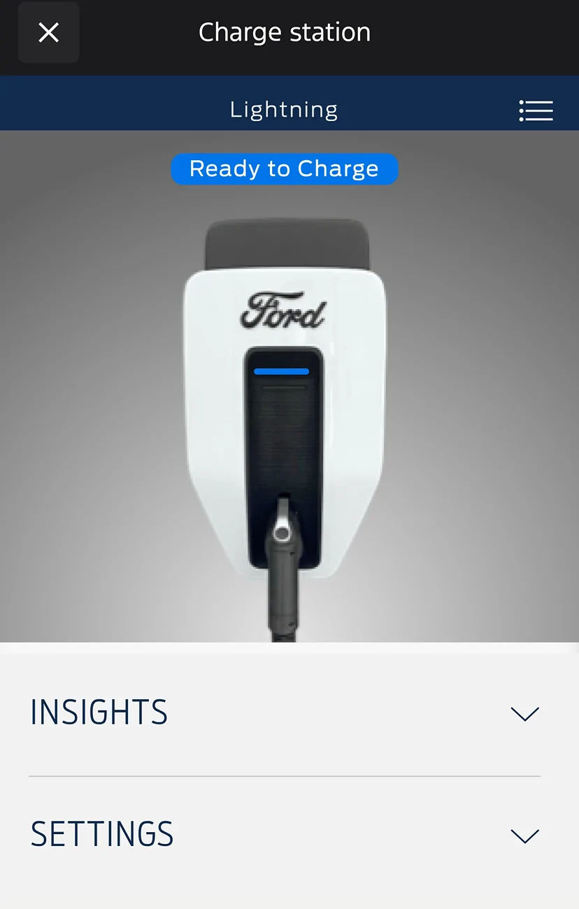

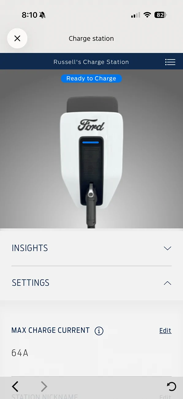

It still shows a valid status for mine.

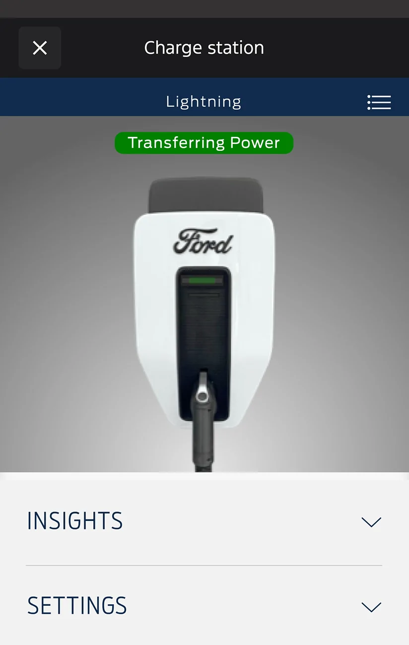

Another TL;DR Post: My FCSP seems to be communicating with the Ford Mothership again.
After various manipulations described below, the orange "Connection Lost" status (unable to connect to servers) has gone away, replaced by the green "Transferring Power" logo that should only show when the truck is transferring power to the house (which it isn't). I have been able to incrementally change the power transfer rate several times: 24A->26A->34A->20A, and the Ford app responds by showing rates of 5.1, 5.3, 7, and 4.2 kWh, respectively. Also, when I go to Charging Station, Insights, Charging tab, the Ford app now shows a test energy transfer for 8/30/26, whereas previously, after the firmware update around 8/7/26, it would show nothing for a charging session until now.
I have the Ford AI assistant in my iOS version of the Ford app. When I asked it why I was getting Connection Lost, it urged me to check my network settings, and I discovered that after the firmware update, the FCSP had connected to a distant Deco mesh router at 5 GHz with a very weak connection vs. the 2.4 GHz the AI said was preferable (router and band connections had been on Auto settings). After selecting the closest mesh router on the 2.4 GHz band in my network app, I got a very strong Wi-Fi signal from the FCSP. AI advice was then to do a cold reboot of the FCSP with all power off for at least 10 minutes, then to set up the Wi-Fi connection again in the Ford Charge Station Pro app, and before doing this, to launch the Ford app and force-kill it so it had to start fresh once used after the new Wi-Fi pairing.
When I did all of the above, it still said Connection Lost in the Ford app for several hours, but then, just as I was about to show the wife how I'd been wasting my time, I noticed that Connection Lost was gone and I was getting the Transferring Power message for FCSP status, no mention of lost server connection, and the amount of an experimental test charge was now showing under Charge Station, Insights. And, hey, I can now derate my FCSP at will. I am not holding my breath that this is going to last into the future. But it works for now.

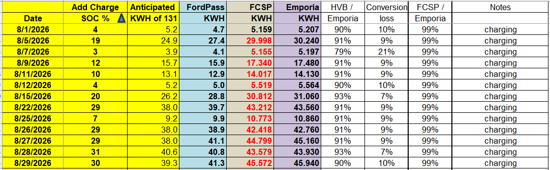

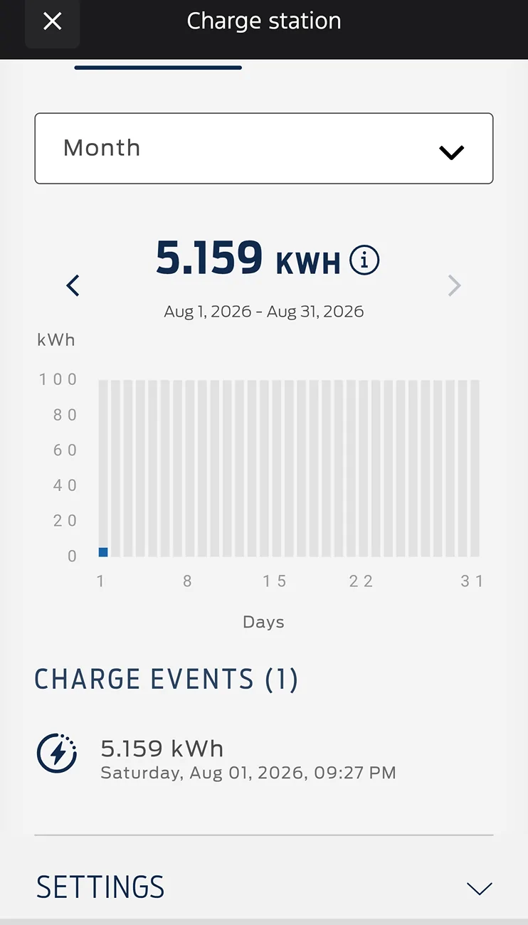

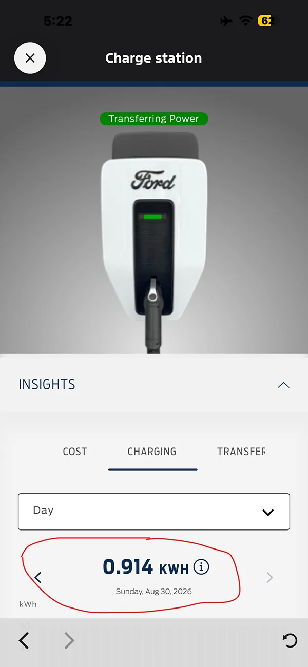

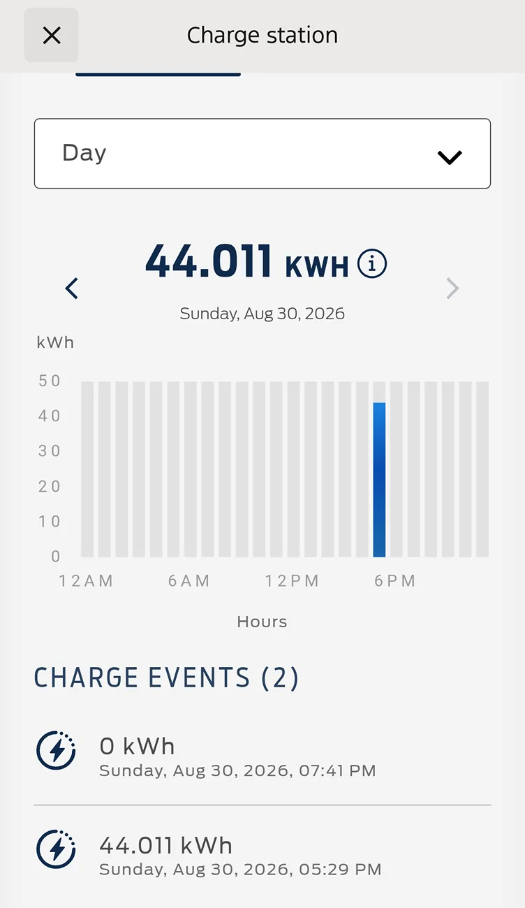

Only data point I have for August is 8/1
Ford F-150 Lightning FCSP Software Version 2.500.34-ford.27+26-08 1788130562334-4d
Actual Emporia data and FCSP KWH in black text is live data, while the RED text in the FCSP KWH column is interpolated at 99.2% of Emporia values, as has been the historic trends of the past.

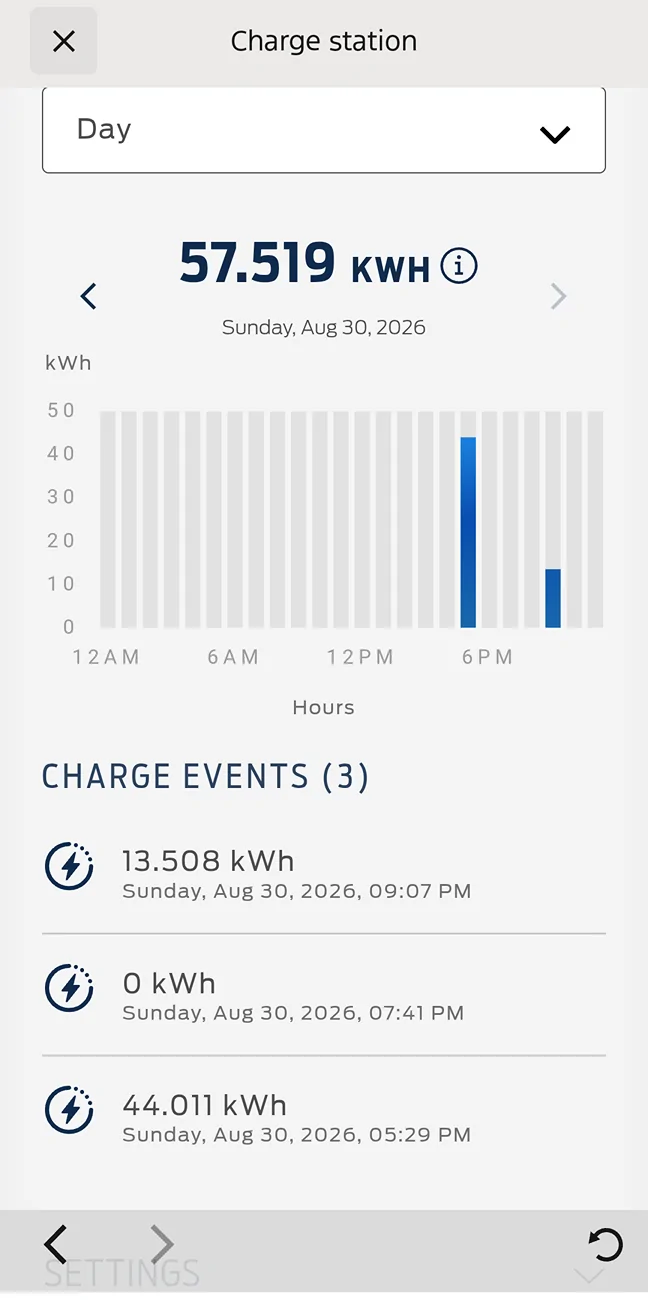

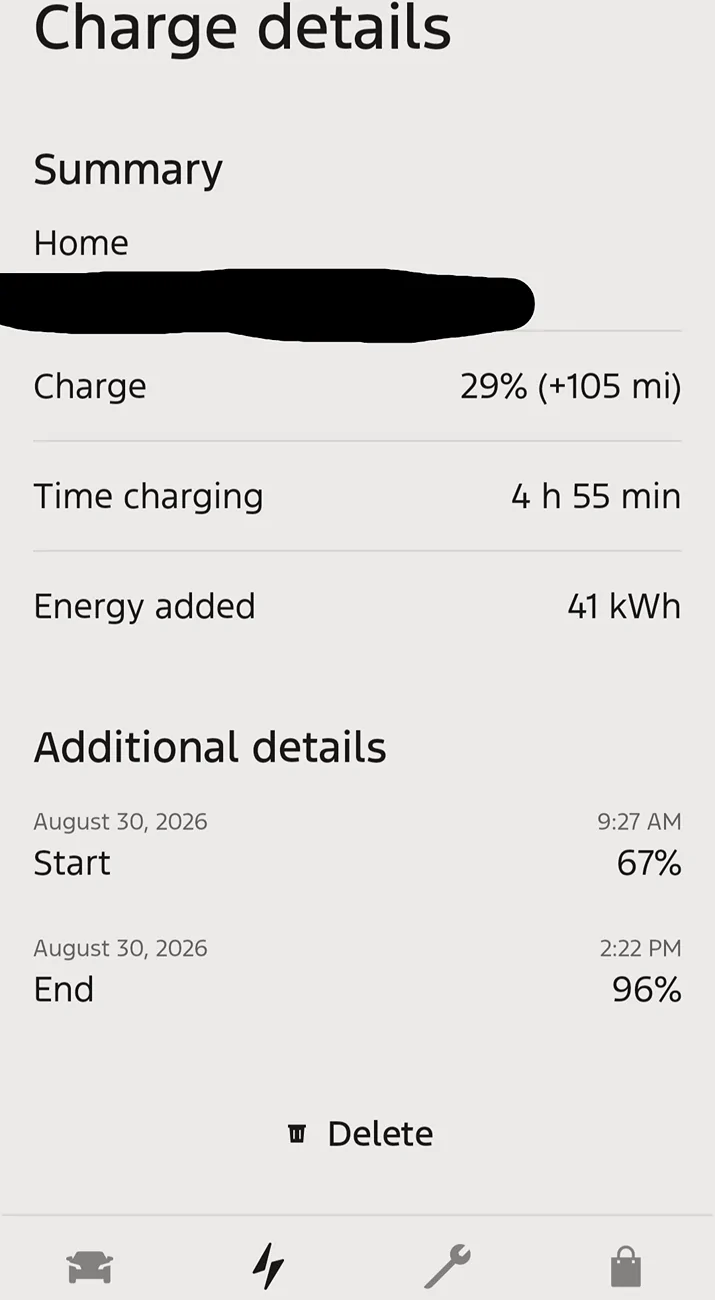

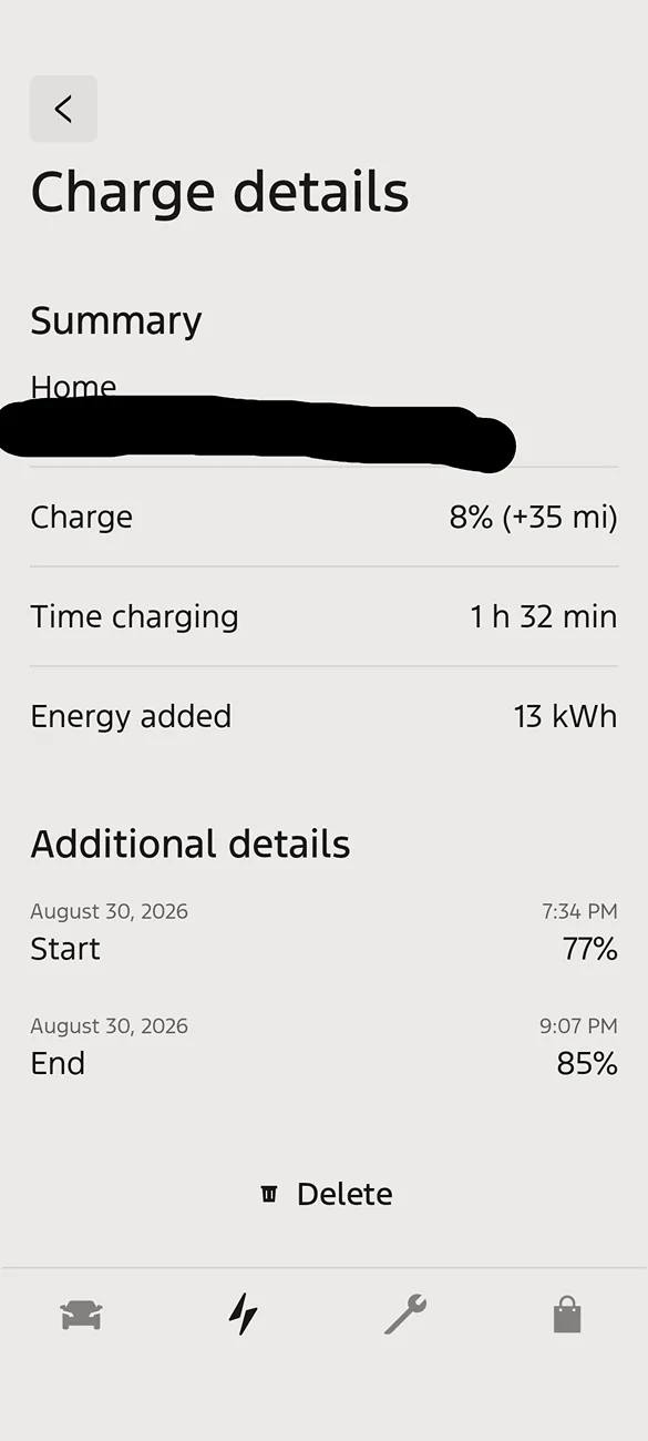

Here is my charge session from today... I'll report back after this next session is completed in about an hour.
Edit: Note the time stamps when the charge was completed and what was reported by the server. It was a lag. When I go back and look at the past recent charging sessions, the time stamps match when I completed and what/when is was logged.

The ford servers are operational.
Here is my charge session from today... I'll report back after this next session is done in about an hour.

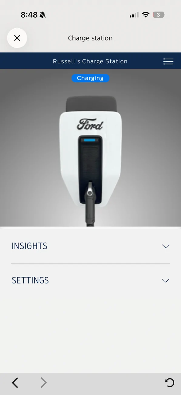

I plugged in to charge and it is updating in the app correctly.
