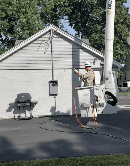

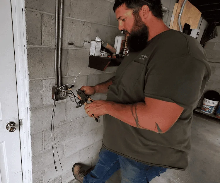

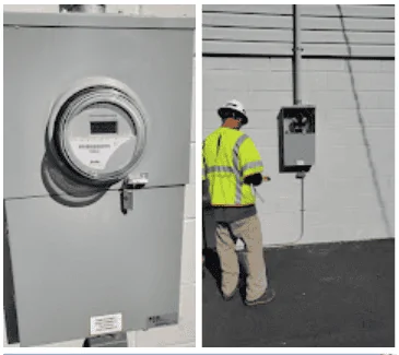

Today National Grid made the service connection to our detached garage, 240v x 200 amp service.
This not only simplified connection of the FCSP to a suitable power source (100 amp circuit) but also provides sufficient energy to my motorcycle [hobby] work shop. It's going to be toasty in the shop this winter while I finish the race bikes engine rebuild.

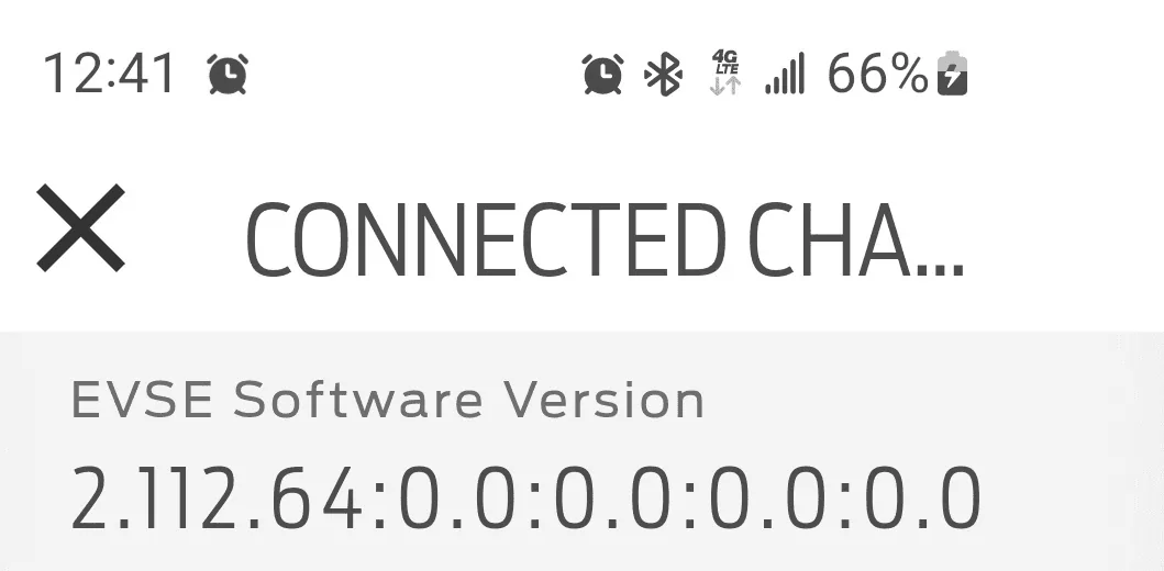

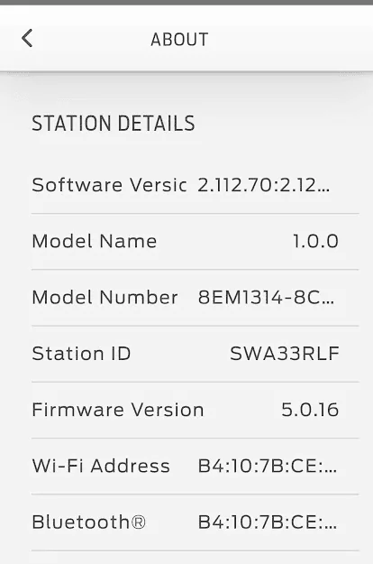

This is the current firmware version, if I'm behind several version, it might take a while to update until I get a strong signal in the garage, thinking of using my mobile phone hot-spot configured with the same SSID / PW so that I can get these patches sooner.
