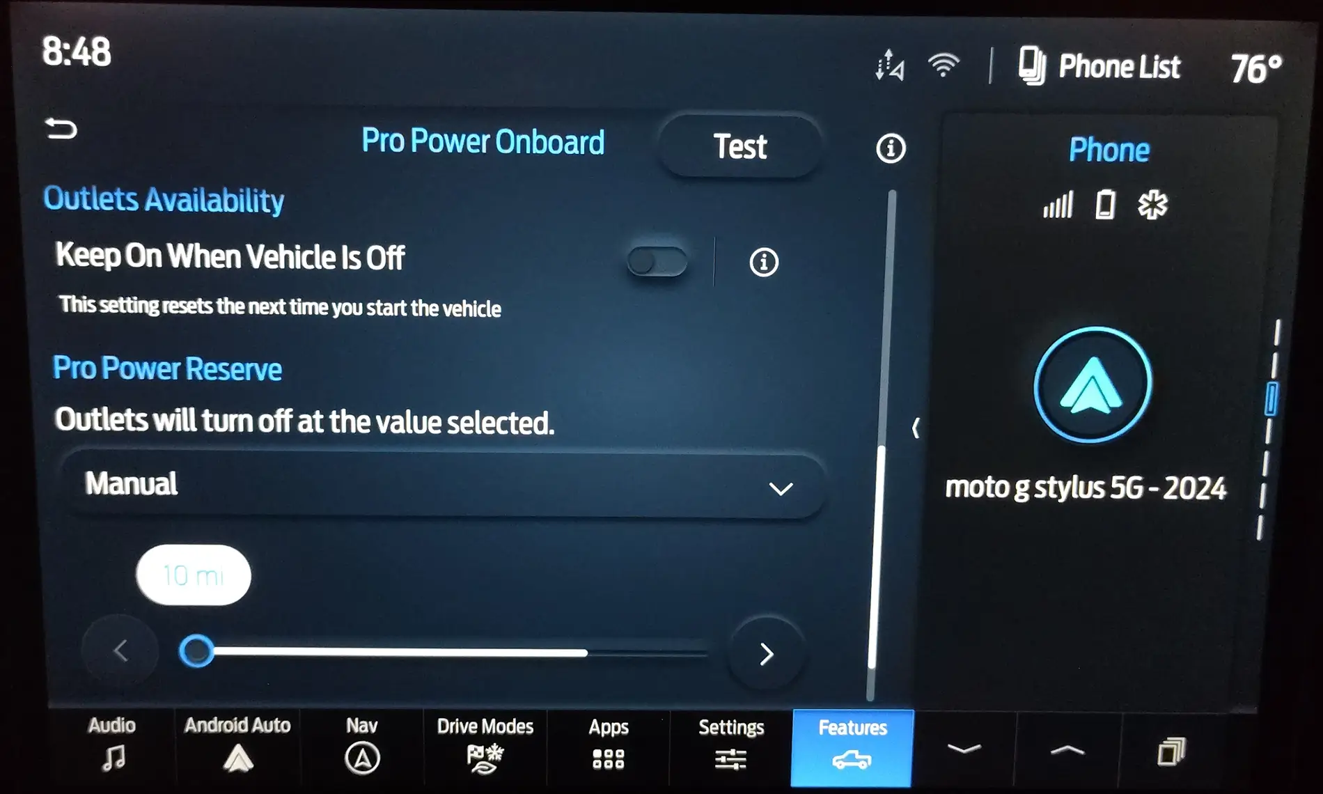

Found it hidden on 2nd page of 12" screen!
Well hope springs eternal. Ill keep waiting. now if @Ford Motor Company could figure out how to keep the A/C on when you start it from the app and open the frunk with it 100 degrees outside that would be nice

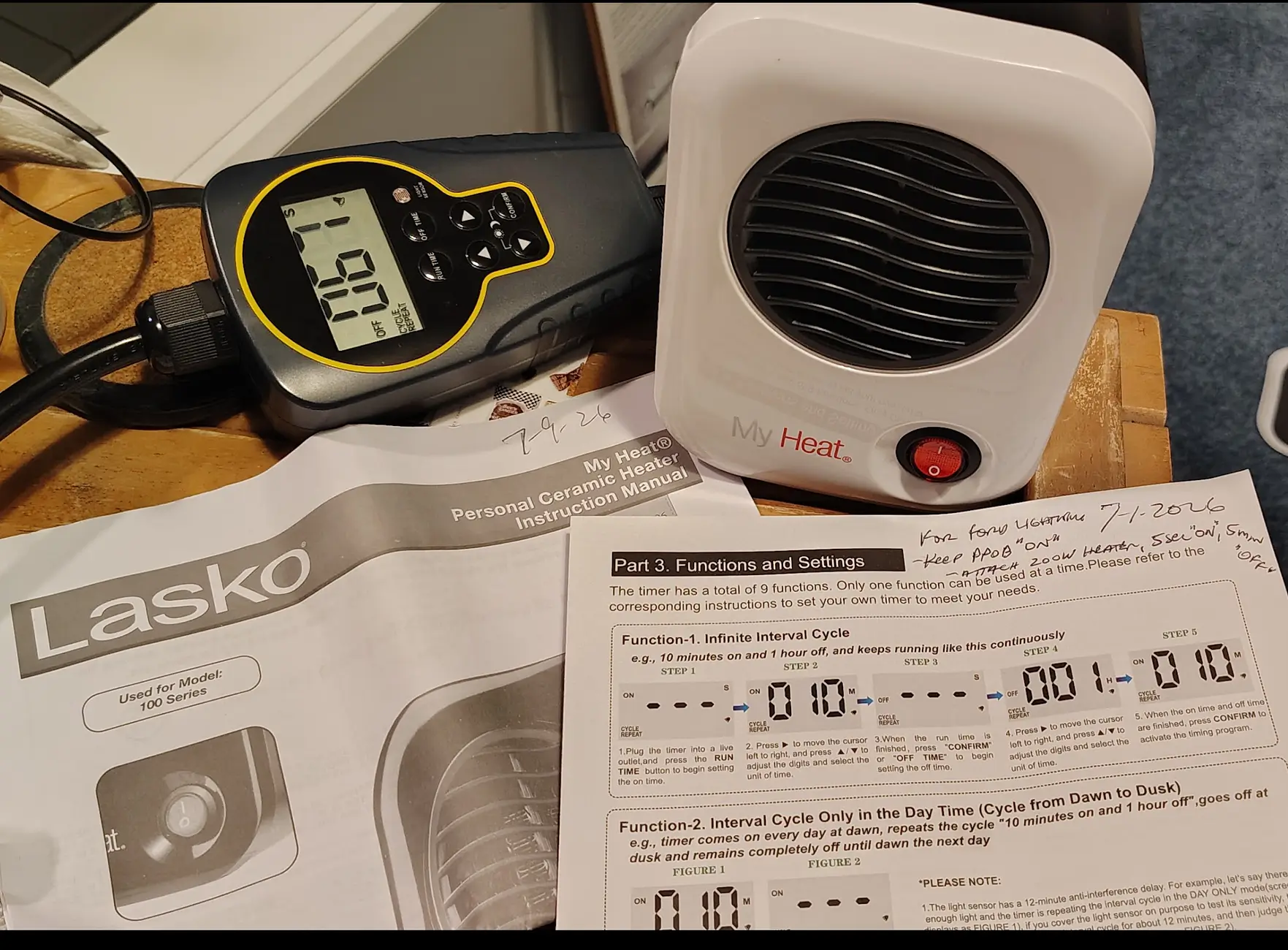

The truck ON with all accessories off uses about 400W. Has anyone using the ProPower with truck OFF timeout circumvention* collected data on the idle truck power used? You should use the ODB2 reader with CarScanner and collect HVB data over at least 24h to estimate idle truck power.
It's a huge inverter (7.2 kW). I imagine there's probably still hundreds of watts of idle power with no load. But, it would be helpful to see data.
*100W load on timer: 1s ON, 299s OFF - 0.33 W avg

I tried to use this feature on July 4 when a storm caused a power outage for 200k households. We were supposed to be without power for four days so I hooked up two refrigerators and headed to the hotel.
Pro Power with vehicle off turned off because of what I assume was the refrigerators did not draw the minimum current when idle. Went to the home and turned the truck on and ran without incident for three days.

This is a great example why Ford arbitrarily setting a minimum draw is an anti-feature, not a feature.

12-volt systems will be powered by the traction battery DC-DC converter when the truck is off with PPOB on. Also, the Sync screen and the instrument cluster will be dark, the AC and seat heat/cooling and exterior lighting is off. The running lights were on but shut off after a minute or so. The dysfunctional auto off on minimum load did not appear with this update on my truck either.
The unlock feature from the Ford app can also be used with the bed green on/off switch to start PPOB. I did not check with PAAK.
I found that I can now charge tool batteries in the frunk with the lid closed. Previously, the 400 watt limit with the lid closed would trip the overload with any battery/charger I have.

Following up to GoodSam's post #164, my '23 Lariat does indicate PPOB load wattage with the bed outlets powered via the Ford APP with the truck off (IPC, SYNC screens and lighting off).
Knowing how problems can appear with any software update, I wanted to be certain the minimum load requirement of the "Leave PPOB on With the Truck Off" selection which the MY '24 and '25 Lightning has, did not propagate to my truck with this update. Fortunately, it did not. It's worth checking in the later model year trucks.
The "Leave PPOB On with the Truck Off" selection resets with each vehicle start, so it is not likely to be enabled when power is needed. It's easier to plug in to the bed outlet, push "Unlock" from the FOB or Ford APP and then push the green On/Off button next to the outlet and not get in the cabin to start the truck, enable PPOB, and shut off unneeded power loads.
My Mikita 18-volt battery chargers draw 200 Watts with a single battery or 400 watts with the dual battery charger. Neither were usable with the frunk closed previously but can be used now.

I was also quite excited to see this feature, as we use our 2023 Lightning for camping, and like to keep a small fridge in the bed. So, I found the slider, enabled it, powered down my truck, and fridge power *did not* stay on. I tried again, engaged the slider, powered down, and just before the screen blanked, I saw a message saying something like, “Truck must be on to enable this feature”, which of course, makes no sense at all. When the truck is on, and the fridge plugged in, the reported draw is 100 W, which is close to that shutoff threshold that people warn about. So, what’s going on here? When I get home (currently on a camping trip), I’ll try a larger load, and see if I get the desired behavior when the truck is powered off. Anyway, love the Lightning, great product (although a Maverick-sized EV truck would’ve been better for me — the F-150 is just too big around town), but it’s a real shame how Ford has handled their first EV products. As for me, I’m going back to BMW for my next vehicle purchase — I have an ix3 on order. However, we’ll never sell the Lightning until the wheels fall off.
