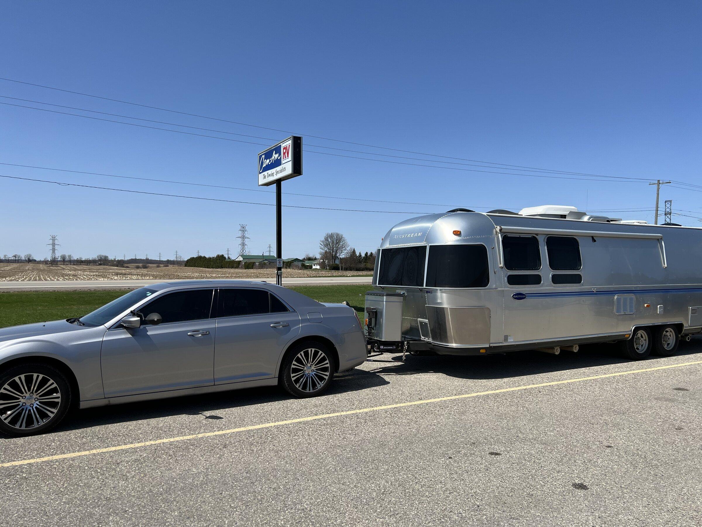

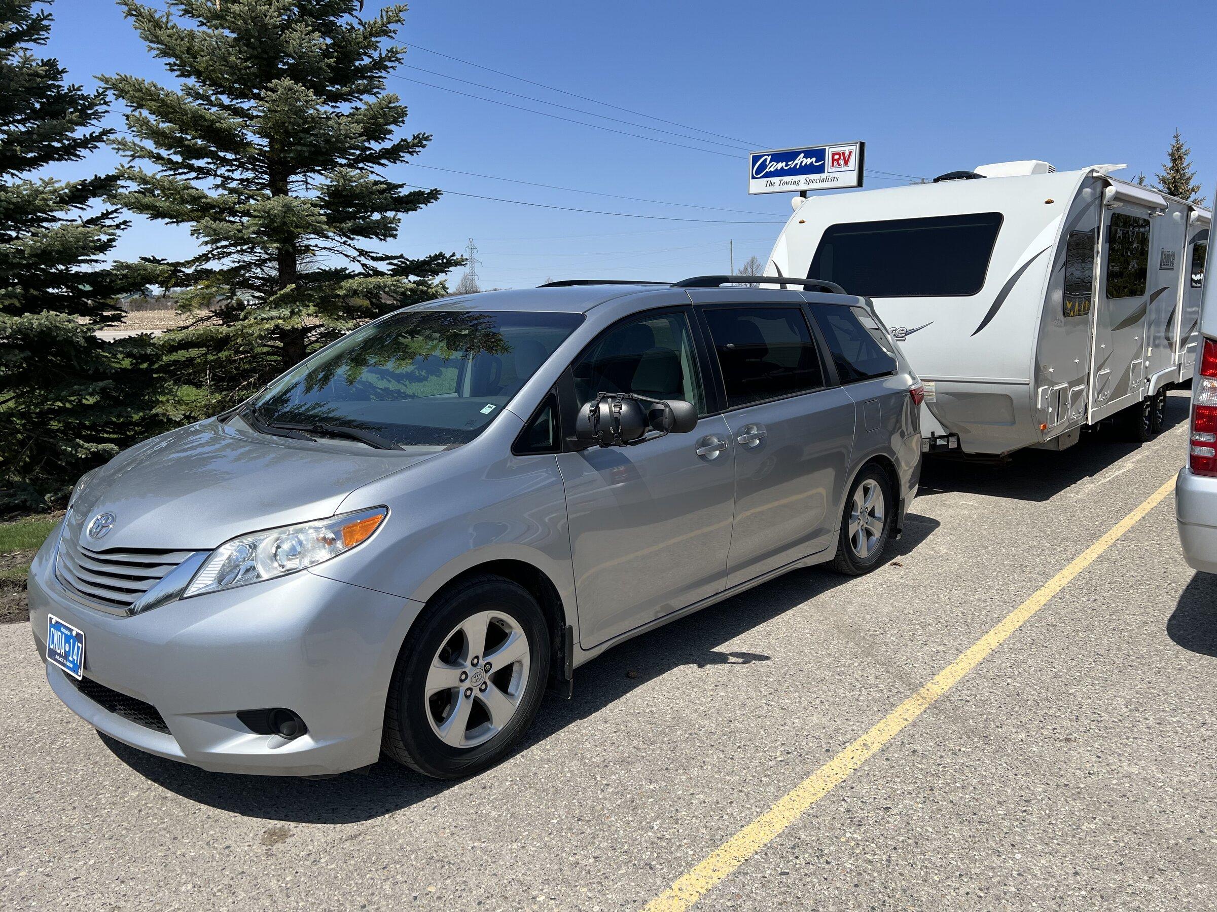

We just purchased a Reflection 150 278BH. By coincidence my dealer is Can-Am RV of London, ON, which you’ve probably heard of if you’ve been around the Internets for a while. They just happened to have this model in stock so here we are. But if there’s any dealer that will help me set this up, it’s Can-Am. Here are a couple of pics I took of their other tow vehicles while I was there.

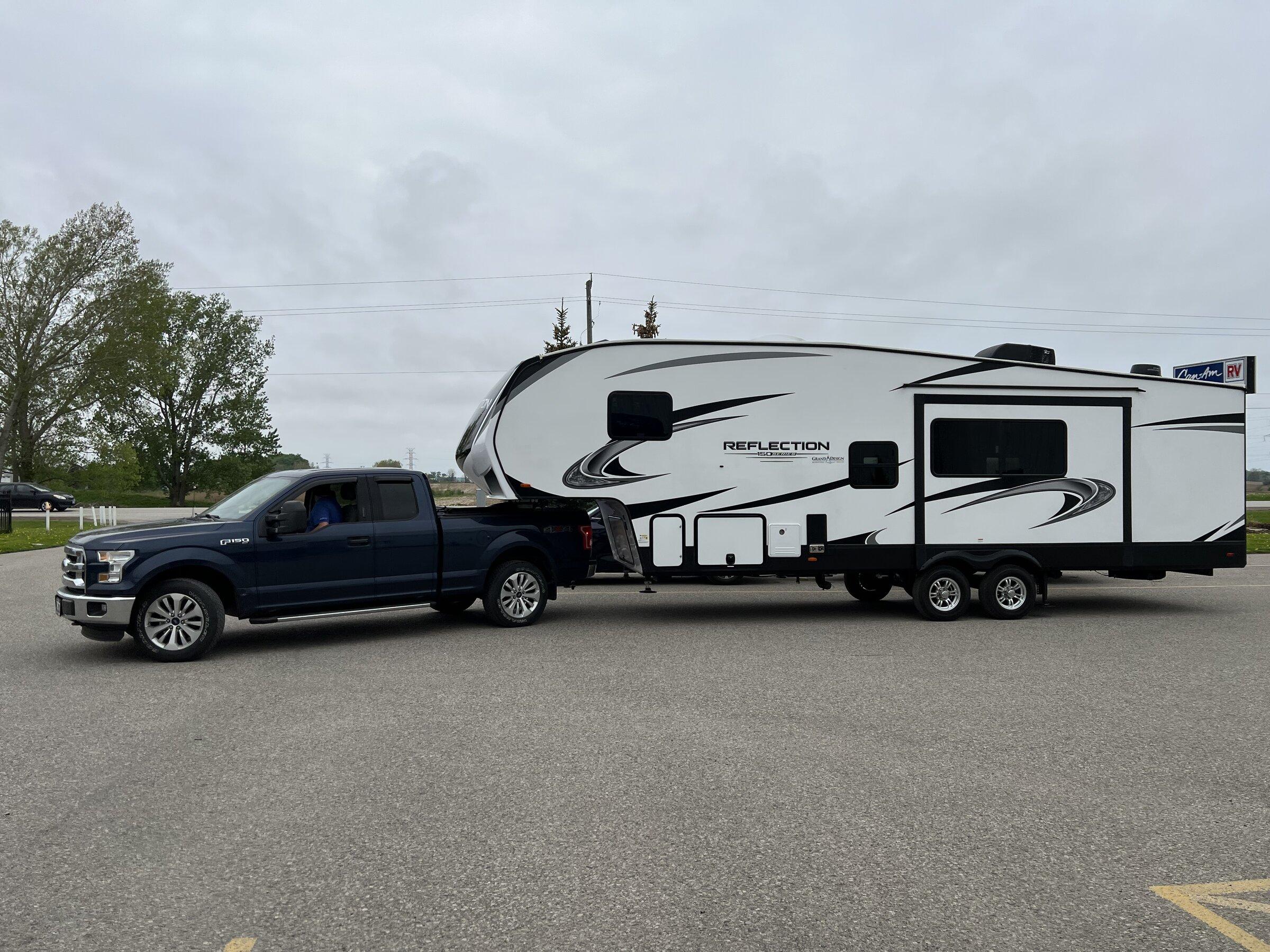

I’ll be towing the Reflection with my 2015 SuperCab 5.0L (Payload 2030 lbs) until whenever my Lightning is ready. That will give me a good chance to check out all the weights, etc. and see how it handles for comparison.

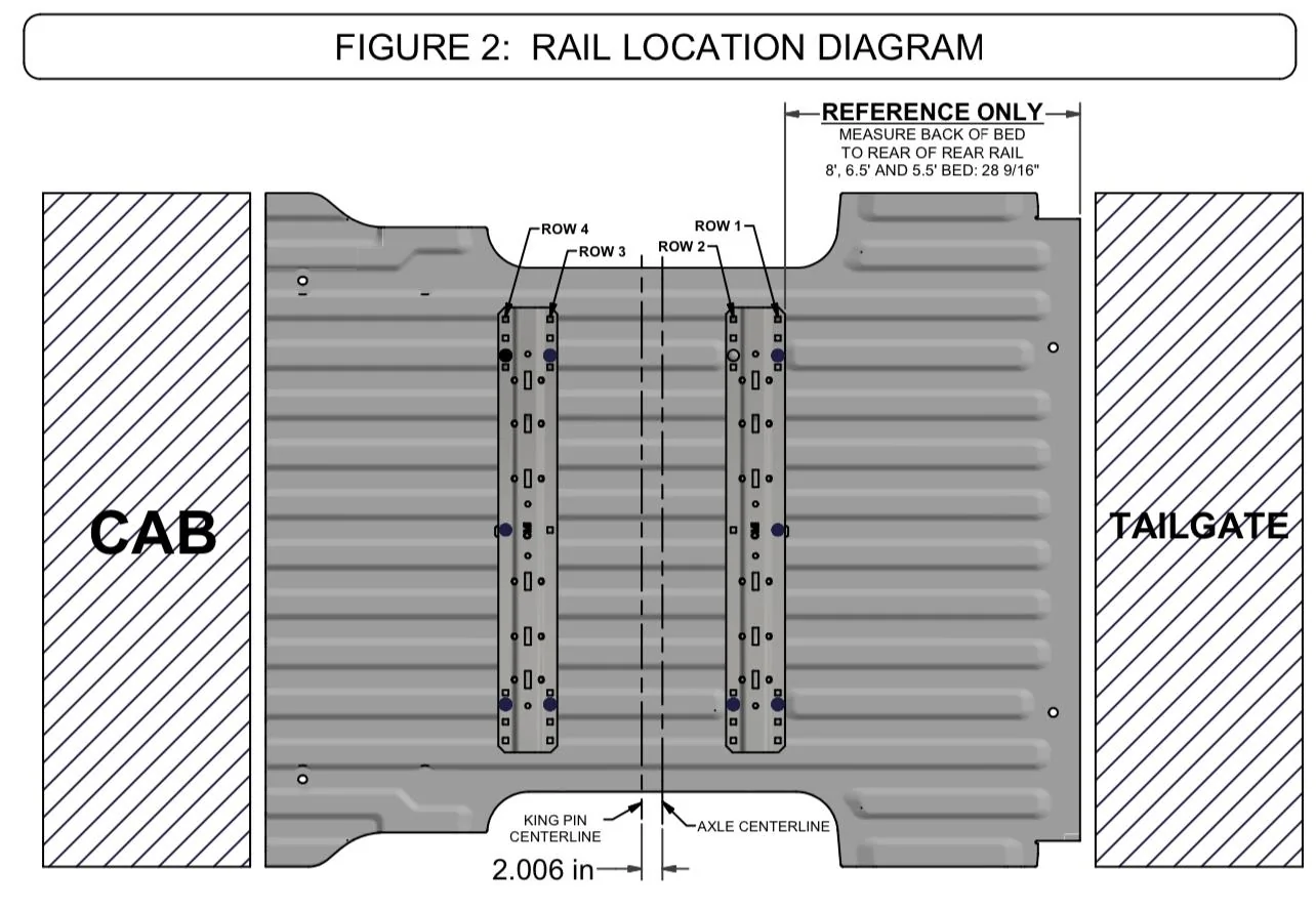

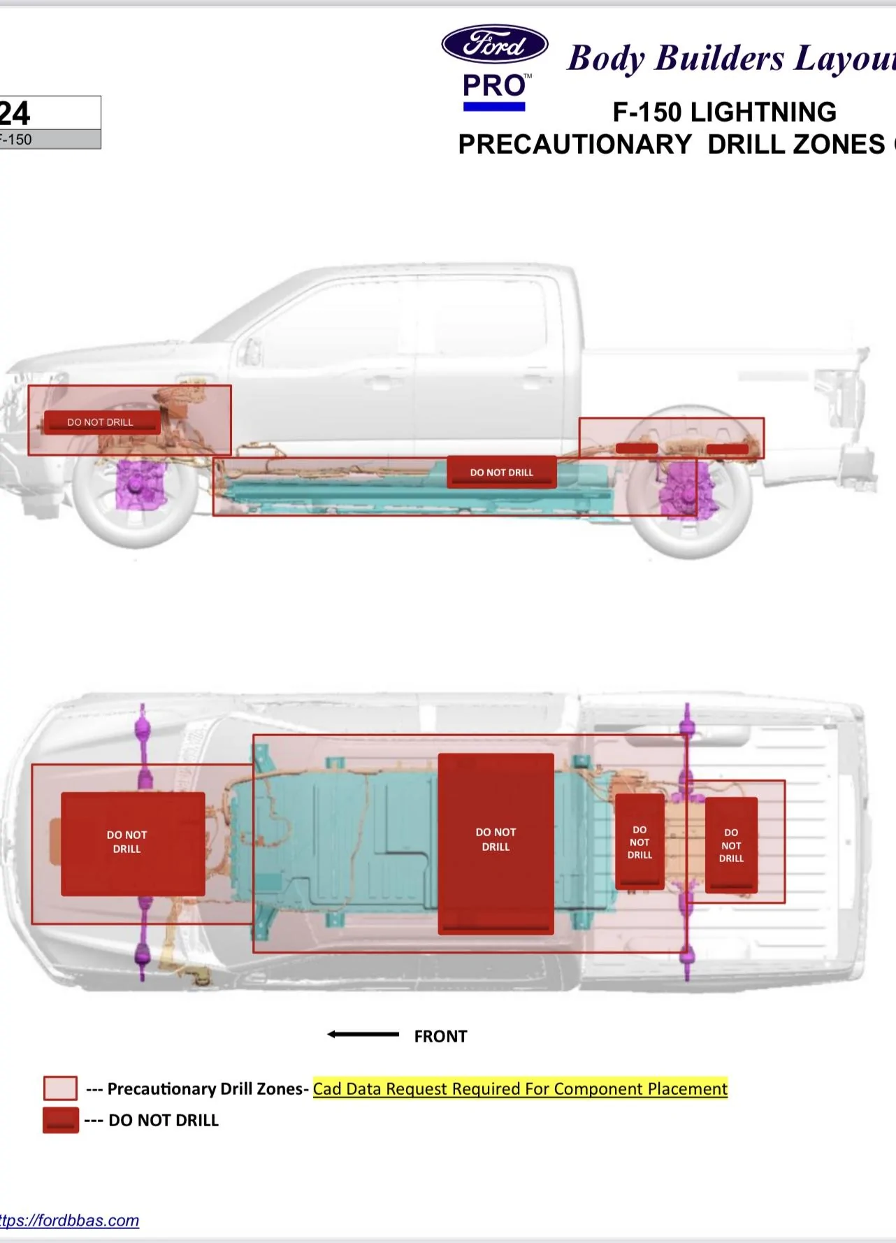

After much research I’m confident that a hitch can be safely installed one way or another. There may never be a set of “no drill” hitch plates available for the Lightning, but a universal kit possibly with some modification will work.
This 278BH has an empty weight of 8500 lbs, a GVWR of 10,195 lbs and is advertised with an empty pin weight of 1300 pounds. It’s designed to be half-ton towable, so no bedroom slide and the heavy appliances are at the back.
