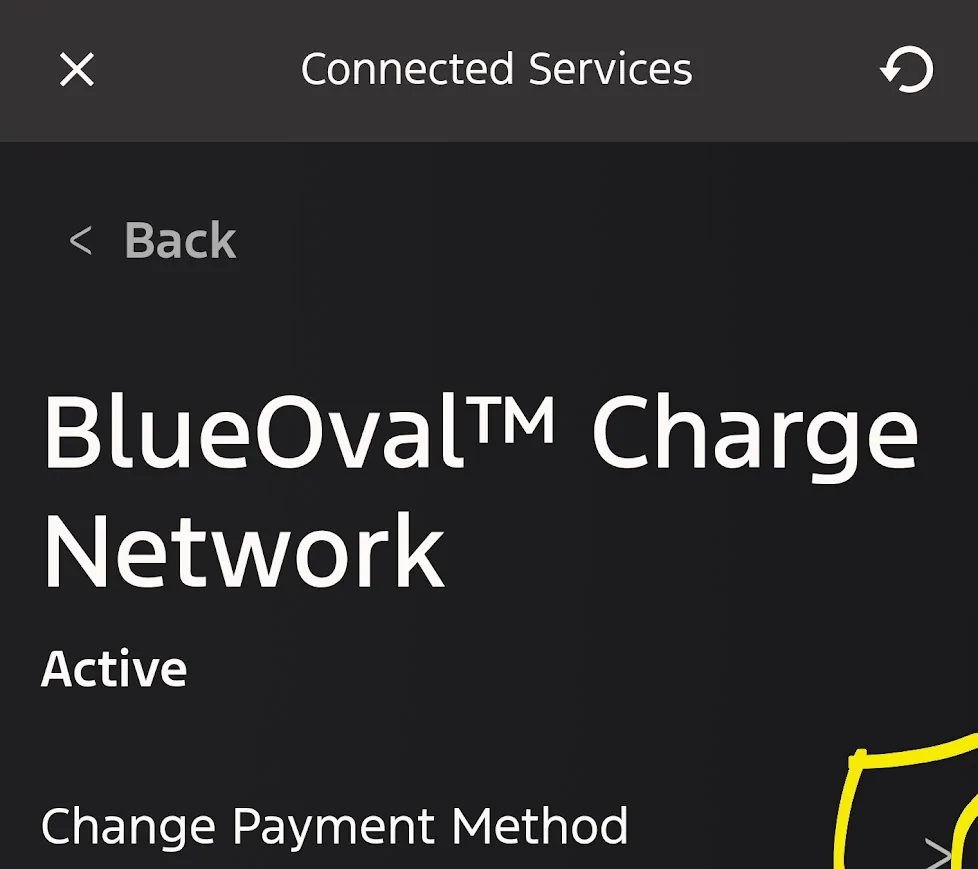

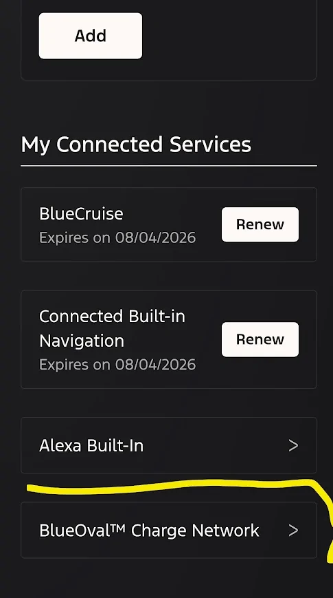

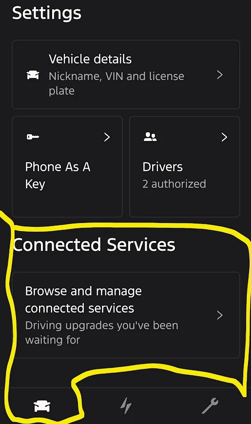

Not seeing where to update my payment info in ford pass. Am I just overlooking it or should I go to the full website and not the app?

Had to re-verify my email with Tesla… it did show an error on that account due to that verification need.
So that's why the first charge failed.
Website.
221
16,162
18,197
You should be able to adjust CC account in Ford App. (non-discounted rate)
