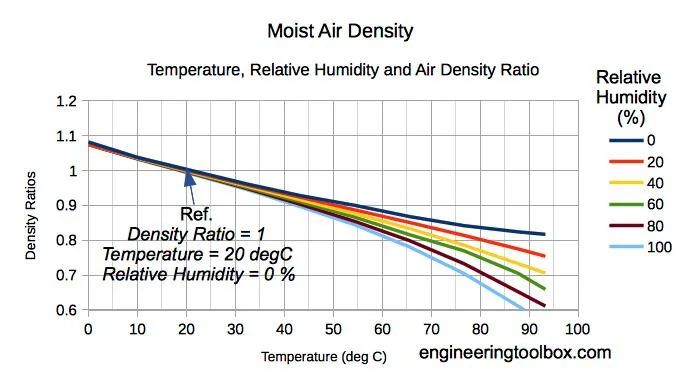

<nerd mode>
Actually, wetter air is less dense than drier air (see below), but having blobs of liquid water falling through said air is another matter!
I suspect that water on the road substantially increases rolling resistance as the tires have to push that water out of the way in order to move, adding to the range loss.
Source: The Engineering ToolBox (2004). Moist Air - Density vs. Water Content and Temperature.
Available at: https://www.engineeringtoolbox.com/density-air-d_680.html
</nerd mode>

<nerd mode>
</nerd mode>
I too was surprised by the way rain reduced the range of our Mach-E on one of our first road trips.
“Wetter air” is ambiguous. You are 100% correct regarding density vs relative humidity, but if by “wetter air” he means precipitation, the combination of liquid and gas will likely (depending on liquid/gas ratio) be effectively denser and negatively impact range.
