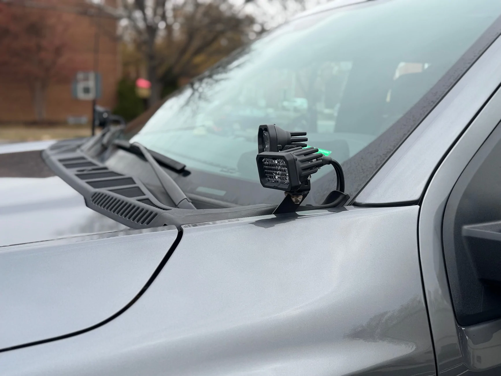

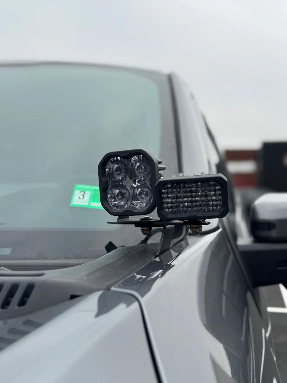

I’ve added Diode Dynamics LEDs to my 2023 Lariat for night driving in remote, unlit areas. They’re excellent, though I use them just a few times a month. I find the OEM headlights — with the Glare-Free Lighting option engaged — do a fine job in the fog and blowing sand and rain I encounter when driving in the Outer Banks of NC.

How did you wire up the lights?

Very simple connection to the 12v system and basic toggle switches installed in the first open space below and to the left of the steering column. I had to do some shopping around for the right combination and configuration of brackets and theft-deterrent nuts and bolts.
Where did you get the mounts? I'm a believer in amber fogs, not for better visibility from the truck, but for better visibility of the truck to approaching cars in the fog. I also like the idea of a rear fog, particularly for driving in the pea soup we get in some of our mountain passes in the winter.

BTT - The mounts came from F150 LEDs, with a bit of tweaking to make them a bit more tamper- and car wash-resistant. The folks at F150 LEDs were very easy to work with.
