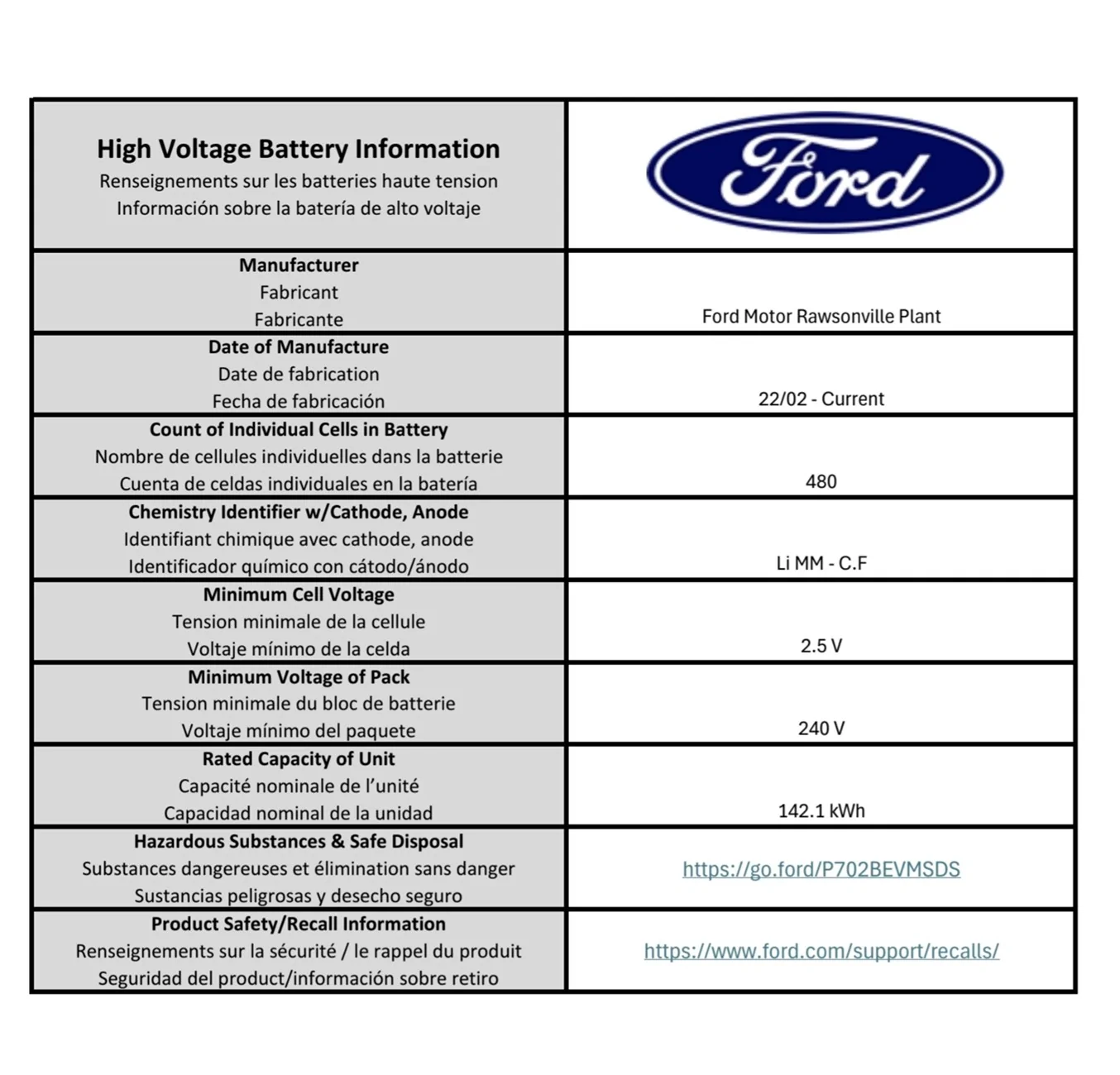

Thanks, nice chart. I didn't know what the "buffer" capacity was.
I suppose the difference between 123kWh and 142.1kWh is the "buffer" extra battery capacity for health so the battery does not get too close to actual 100% or actual 0% controlled by the BMS (battery management system).
Sort of like gross and net income. The "usable" capacity is the net.
PS: AI had told me this but hadn't seen it in writing from Ford.
"The F-150 Lightning Extended Range has a total battery capacity of approximately 146-148 kWh, with a net usable capacity of 131 kWh"
3 different HVB's, 98, 123 and 131kWh usable.
I remember having this conversation with a Ford rep at the NYIAT. He thought I had 2 heads when I told him that the F150L ER had a battery pack size of 143.4kWh with only 131kWh usable.

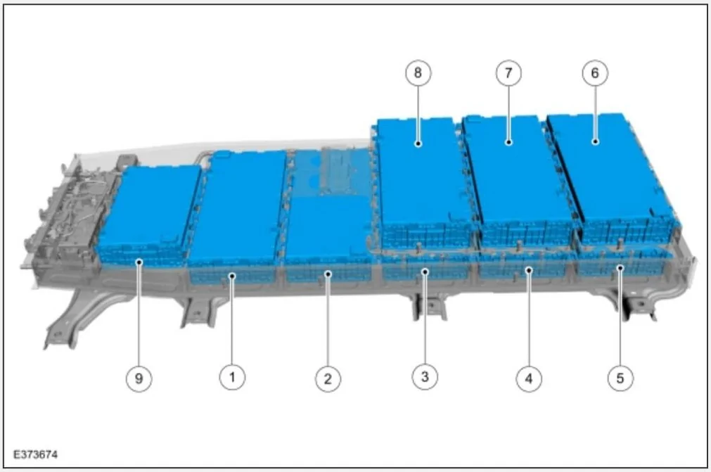

Interesting thread. I kind of wondered about this. So the new 123 kWh pack is the same chemistry and design, they just reduced number of cells slightly as a cost-cutting measure (along with the other laundry list of things they cut) for the Flash trim level this year.

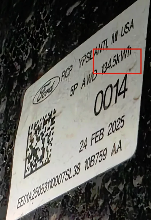

Yes same chemistry and design but reduced cell count. Here is a layout of the nine modules (Ford also refers to them as arrays):
Ford F-150 Lightning Footprint of 131Kwh battery vs 98 kw battery 1757368819271-g4

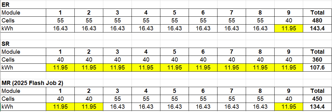

Note #1-8 are the same size and #9 is smaller in size. Here are how they are populated (small modules in yellow).
Ford F-150 Lightning Footprint of 131Kwh battery vs 98 kw battery 1757369287366-rj

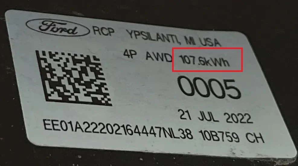

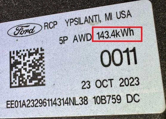

Each pouch cell has 0.29875 kWh. Note the total kWh shown is full capacity and what you will see on the battery label (examples below). As mentioned, there is a buffer and usable capacity is less, e.g. 131 kWh for the ER.
For the 2025 Job 2 Flash they replaced two 16.43 kWh modules with the the smaller 11.95 kWh ones.
Battery stickers:
Ford F-150 Lightning Footprint of 131Kwh battery vs 98 kw battery battery part label 107.6 kwh
Ford F-150 Lightning Footprint of 131Kwh battery vs 98 kw battery battery part label 143.3 kwh
Ford F-150 Lightning Footprint of 131Kwh battery vs 98 kw battery 1758508236167-ld

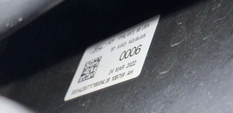

My 2022 Lariat ER has a sticker on the battery just below the drivers door. It says 143.3 kWh. Sorry for the photo quality, it’s really hard to take pictures in that location.
Ford F-150 Lightning Footprint of 131Kwh battery vs 98 kw battery 1757434729805-uq
Thanks, now I'll have to look for my sticker!
