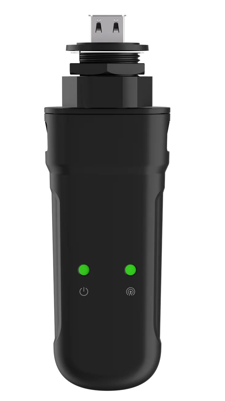

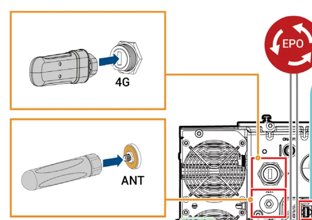

Is there some connectivity uptime requirement to maintain your warranty?
Yes, not me though,"I just work here" - It's a Sigenergy thing but they provide ample means to support folks.
You can run ethernet, your own Wireless dongle or their own Comm Module. It has a data they can provide with 3 years or 5 years' worth.
The hardware is so reliable that they believe as long as they have the ability to maintain it through firmware updates then they can resolve most issues.
Even still, without a stable internet connection they will maintain a 5-year warranty instead of 10. (from installation date)

yes. Wi-Fi or hardwired Ethernet required for normal operation and full warranty. Optional 4G cellular module (CommMod) available if site connectivity is shaky. Without an internet link, battery warranty drops from 10 years to 5.

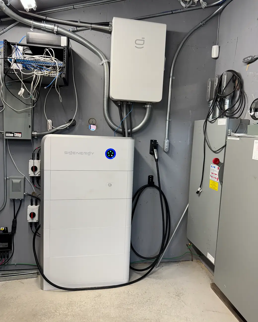

Add 2 more battery modules to this photo and you're at 45kWh!
