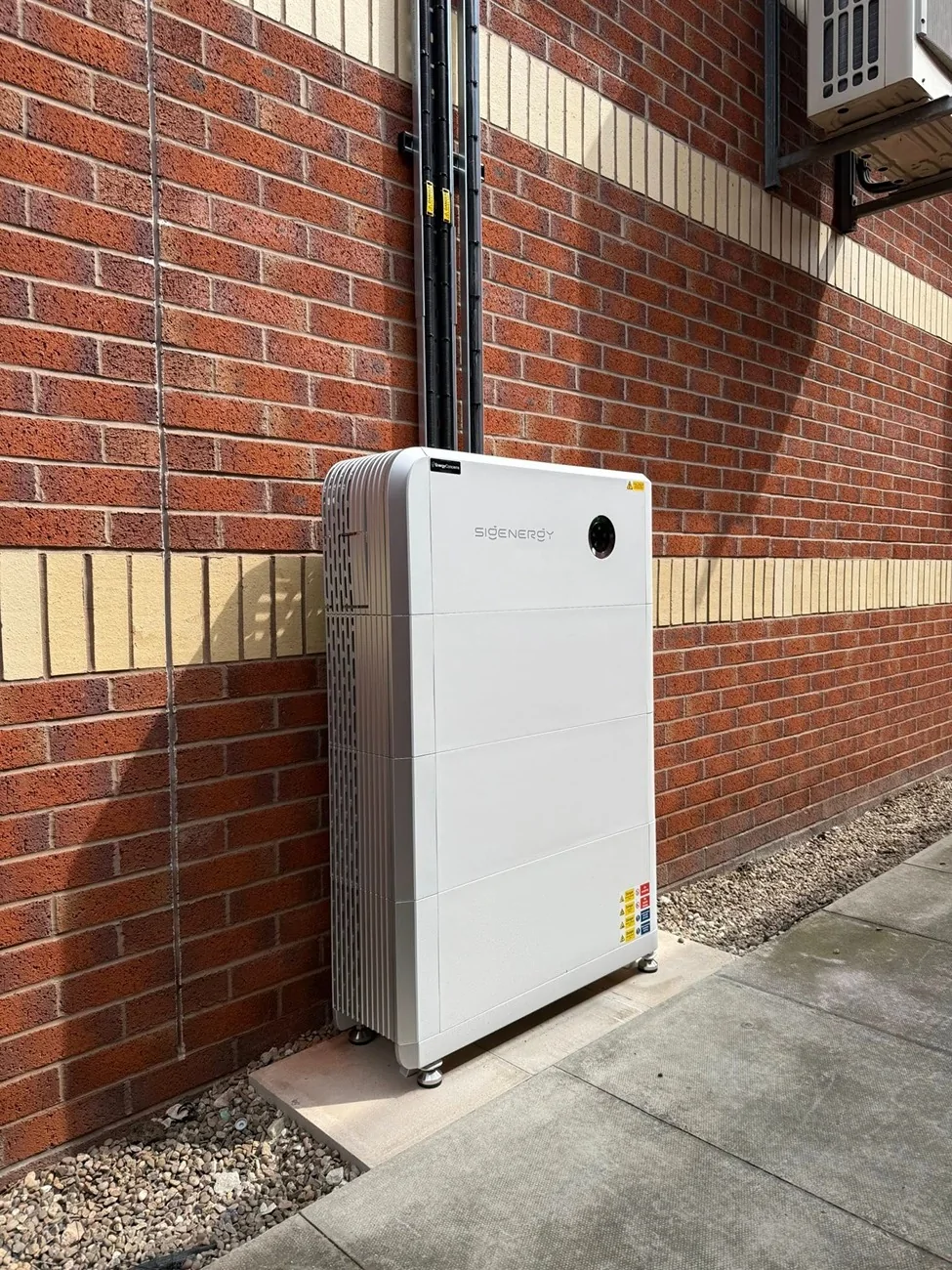

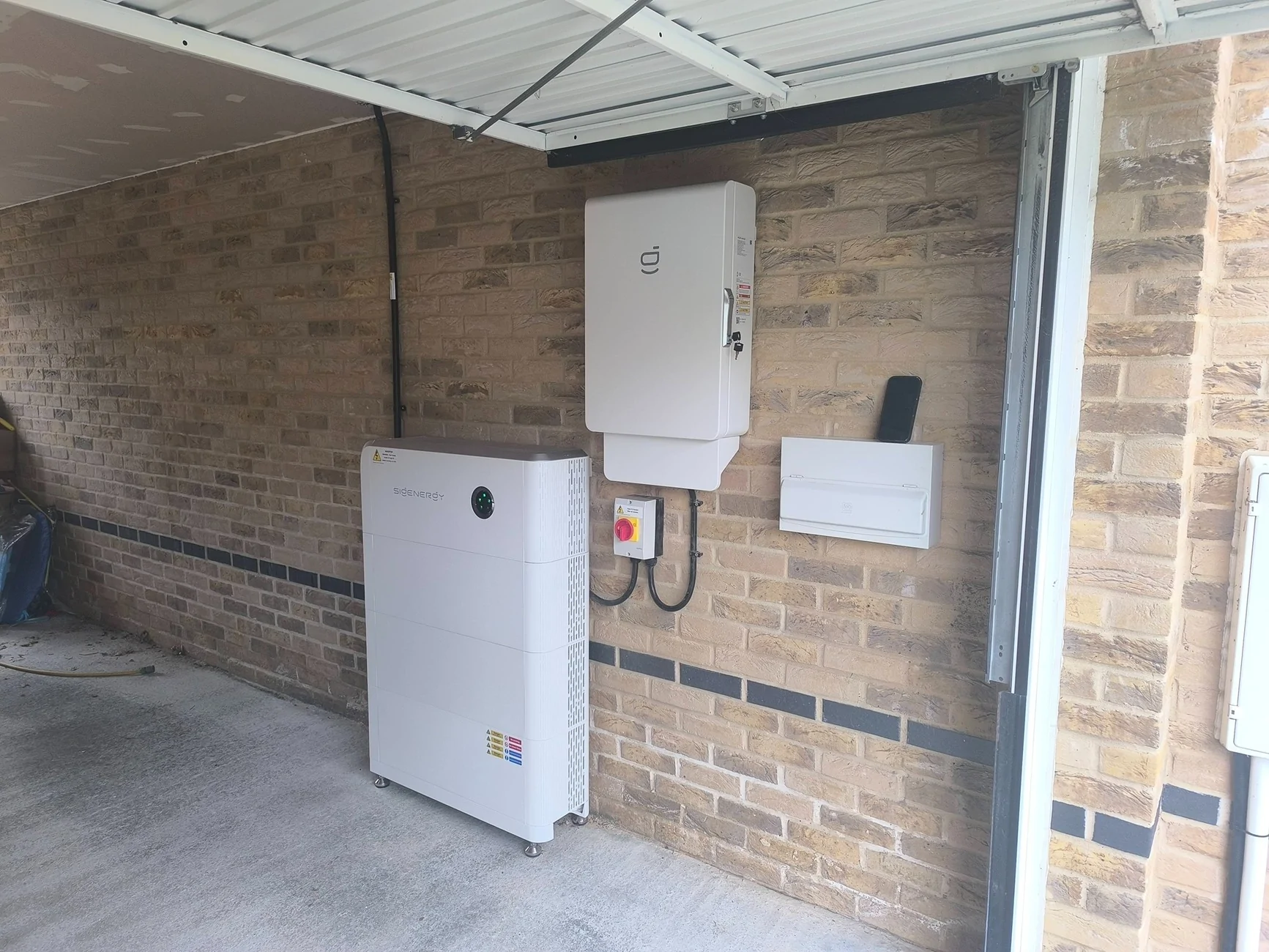

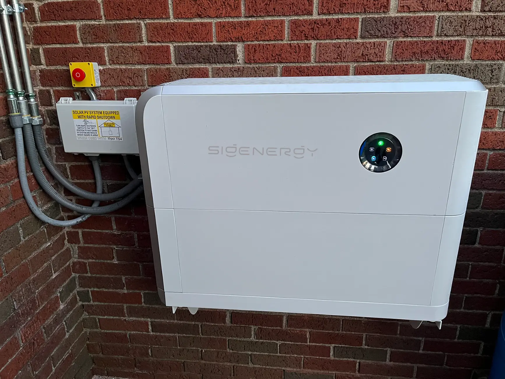

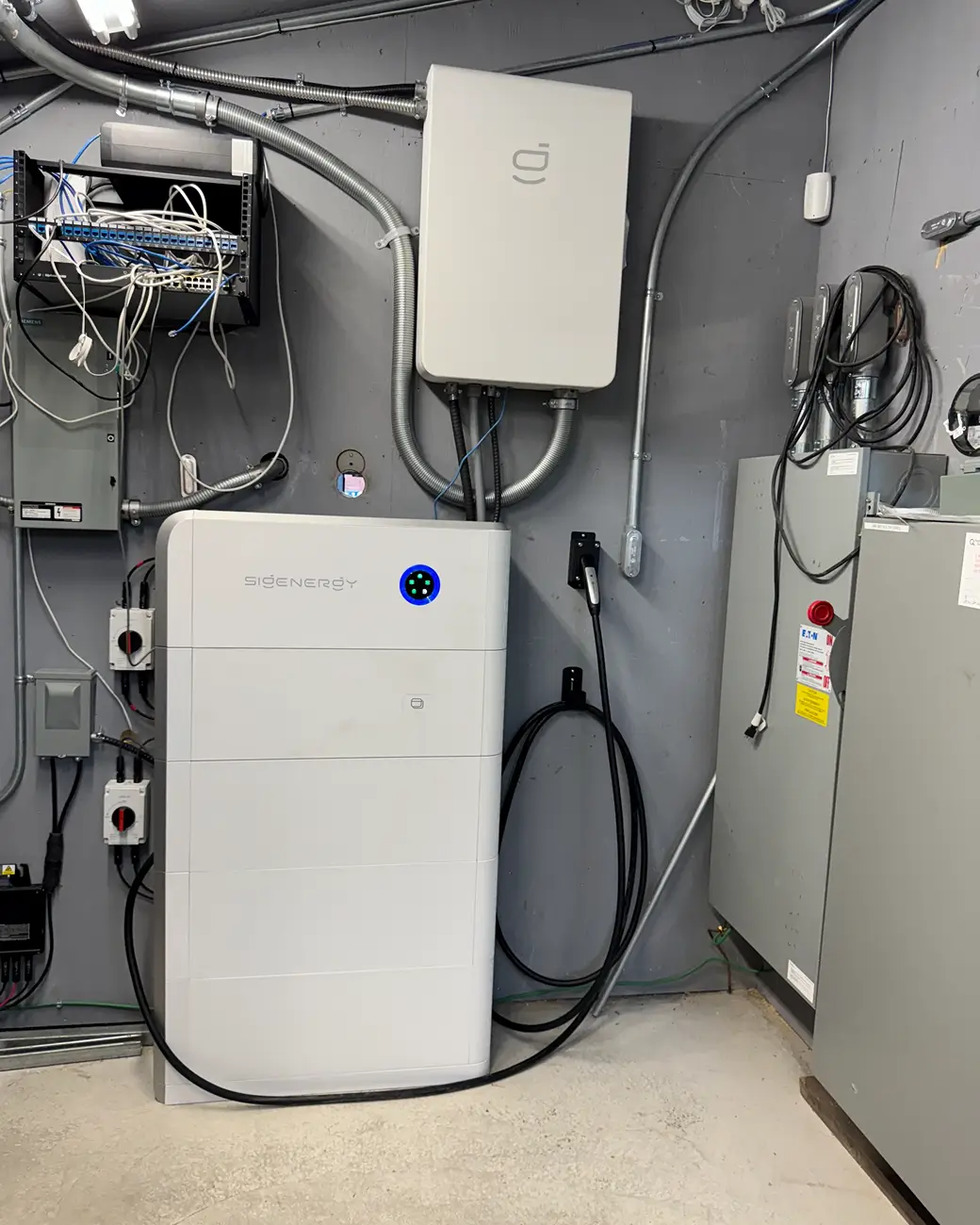

I’ve been interested in sigenergy because it works with other EV’s as well. I just could never conceptualize what the install would look like on my wall. Do you have a photo of the single stack all complete on one wall?

I’ve been interested in Sigenergy because it works with other EV’s as well. I just could never conceptualize what the install would look like on my wall. Do you have a photo of the single stack all complete on one wall?
No kidding about it being really flexible

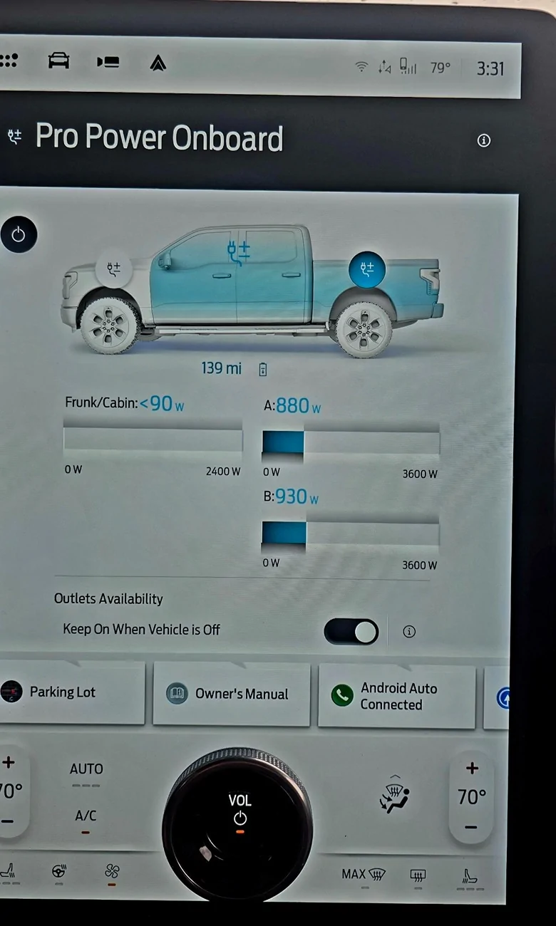

Are you speaking of the older strategy where you have to leave the truck on all the time for ppob to work? The 25 ym you don't have to leave the truck on to use ppob.
Real improvement! Still a different layer. Whenever PPOB is actively supplying load, the truck still runs cooling fans, pack thermal management, and electronics cooling to support the onboard inverter doing the DC-to-AC conversion. The 2025 wakes that stack automatically instead of asking the driver to keep the truck on, but the loads themselves don't disappear; they're still pulling from the pack whenever AC is flowing off the bed outlet. So the UX is cleaner. The energy budget around what the truck consumes to deliver PPOB hasn't changed.
Actually it has a button to slide to keep ppob on with truck off.
