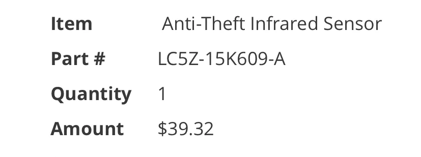

Ford F-150 Lightning Ford Perimeter Plus Security System 1734814176339-ag
this is all you should need part wise.

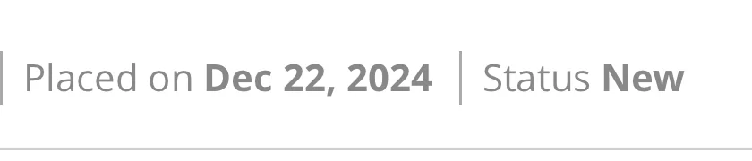

Thanks man. It’s ordered.
After I get it in and installed, hopefully easy enough on that part.
Then after that I will have to dust off my FORscan cable and all that. Guess I could maybe do FORscan part first..?
Looking for the correct and necessary FORscan settings now to have ready….
