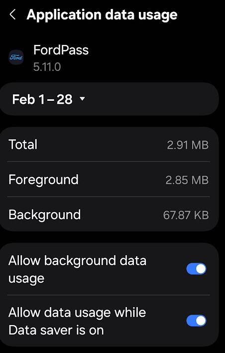

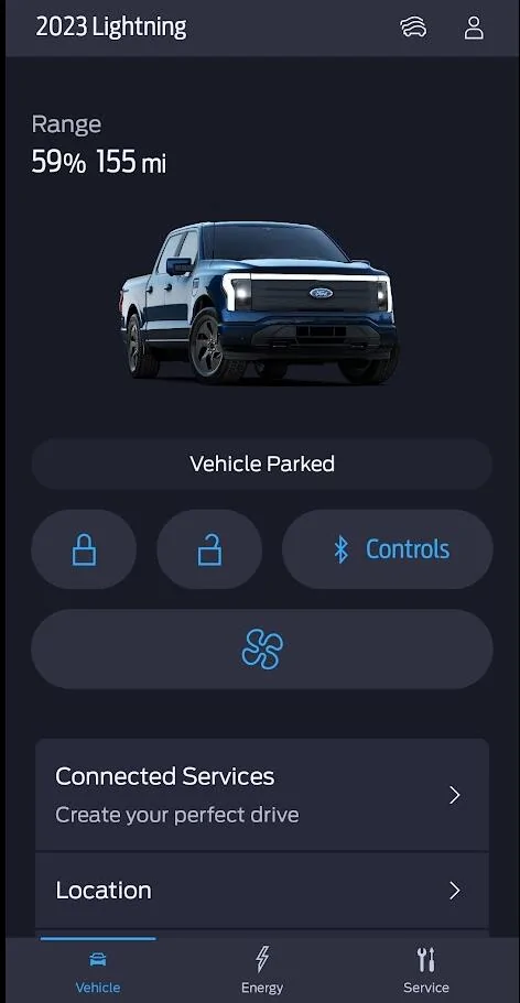

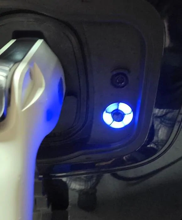

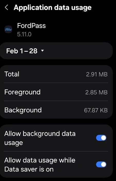

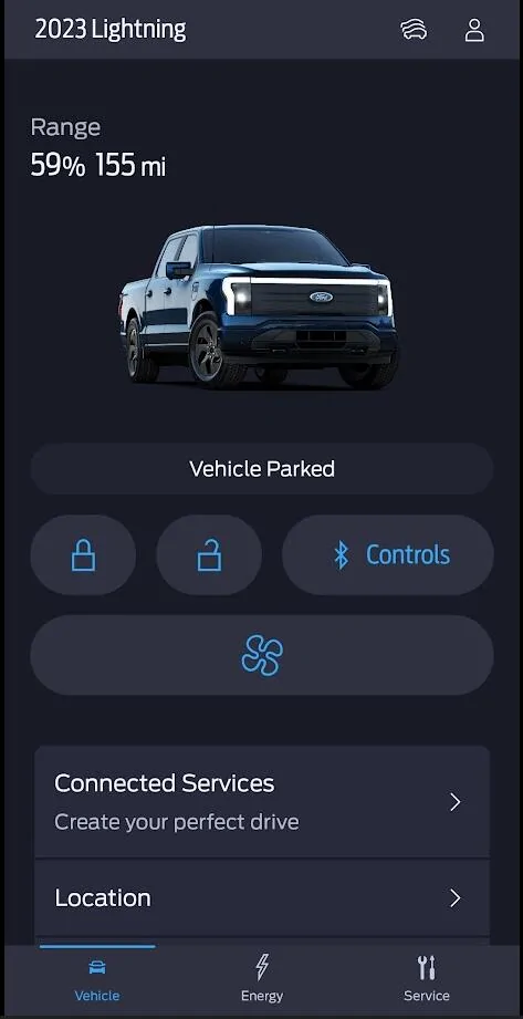

My FordPass app on my Samsung S25 Ultra will not display the current state charge or allow me to set it to 100%. The version of the FordPass app is 5.11.0. I'm able to remote start my 2023 F150 Lightning Lariat ER, remote open/close the frunk/tailgate, etc plus my phone is connected as 'Phone As a Key". Below are screenshots from my phone and pictures that I took to document what's going on. This is my 2nd Ford Lightning Lariat. The first one was a brand new 23' Lariat SR and I put 36,000 miles in one year then traded it in for a brand new 23' Lariat ER (which now has over 20,000 miles). I have a Emporia Level 2 EV Charger installed in my garage and I have been using it 99% of the time charging both trucks. This has never happen before.
Charge Information on my FordPass

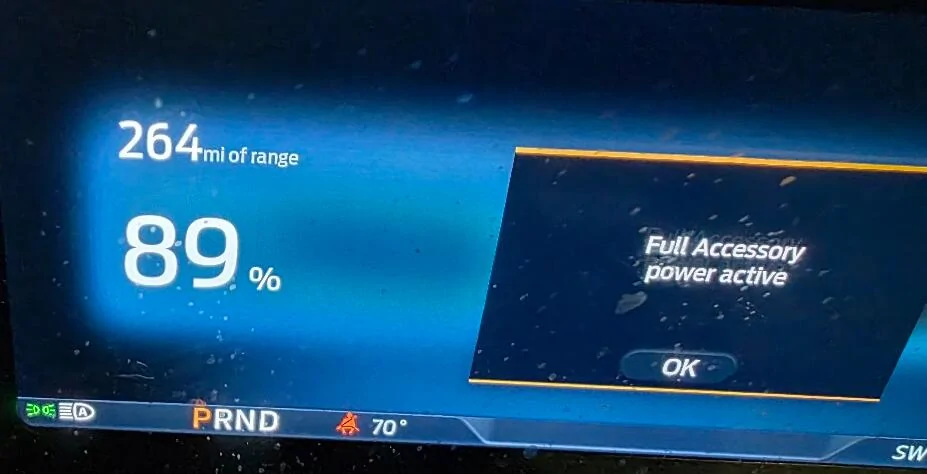

State of Charge in my Lightning
Ford F-150 Lightning FordPass NOT displaying the current state of charge and unable to set to 100% 1739018569518-hr
I had to go into my truck to set it to charge to 100%.

Currently charging to 100%

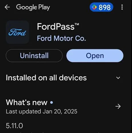

FordPass App Version - 5.11.0 - Last updated on 1/20/2025
Ford F-150 Lightning FordPass NOT displaying the current state of charge and unable to set to 100% 1739019555662-cx
I even cleared the FordPass App cache which still didn't help and I rebooted & shut off my phone.

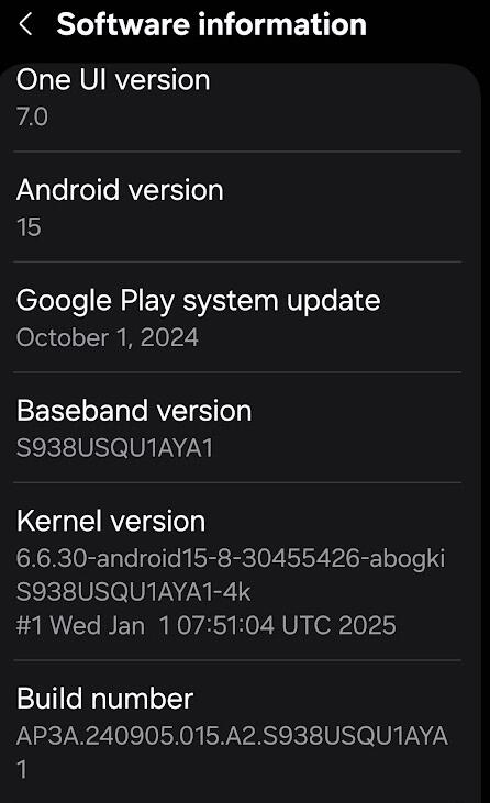

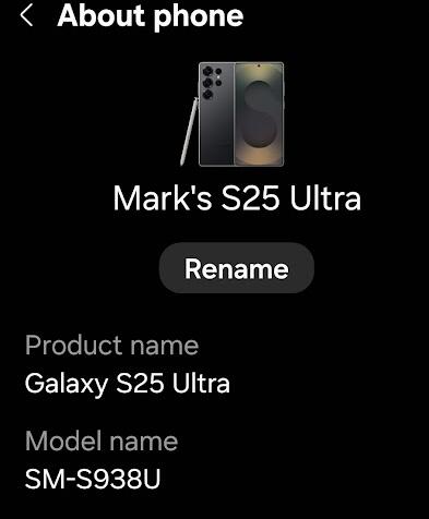

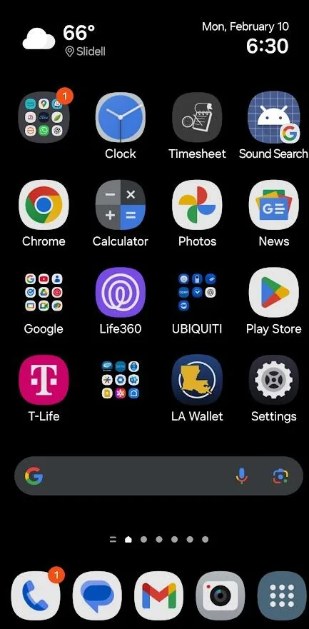

Here's my phone. Maybe it's a Samsung One UI version 7.0 or Android 15 issue.
Ford F-150 Lightning FordPass NOT displaying the current state of charge and unable to set to 100% 1739019881508-2k
S25 Ultra software specs.

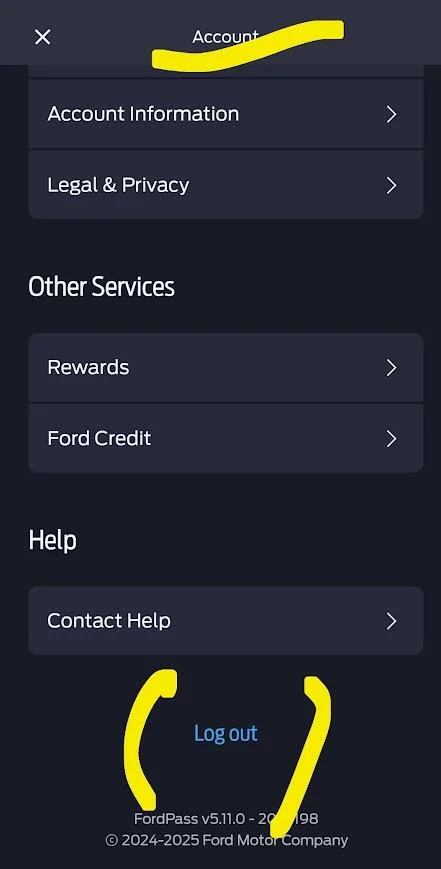

Also have you tried LOG OUT of Fordpass? Then log in again?
Try this first.

I didn't try logging out but I did uninstall the FordPass app and reinstall it. Afterwards, I had to log back in, and the same results - no state of charge updates.

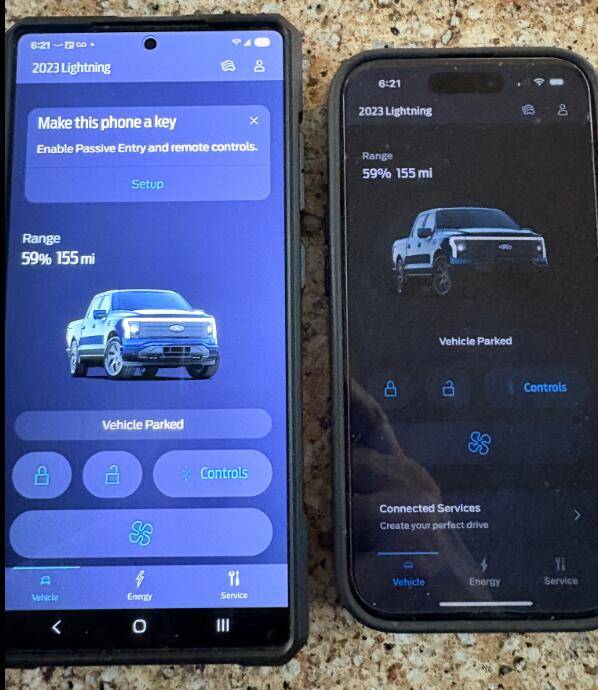

It's definitely not the FordPass app. Here's incorrect state of charge displayed on both an iPhone 15 and an android S25 Ultra. See below:
Ford F-150 Lightning FordPass NOT displaying the current state of charge and unable to set to 100% 1739276760484-xx
I'm on the way to the service department to get the upper ball joint nut/bolt replaced and to resolve/replace the TCU.
