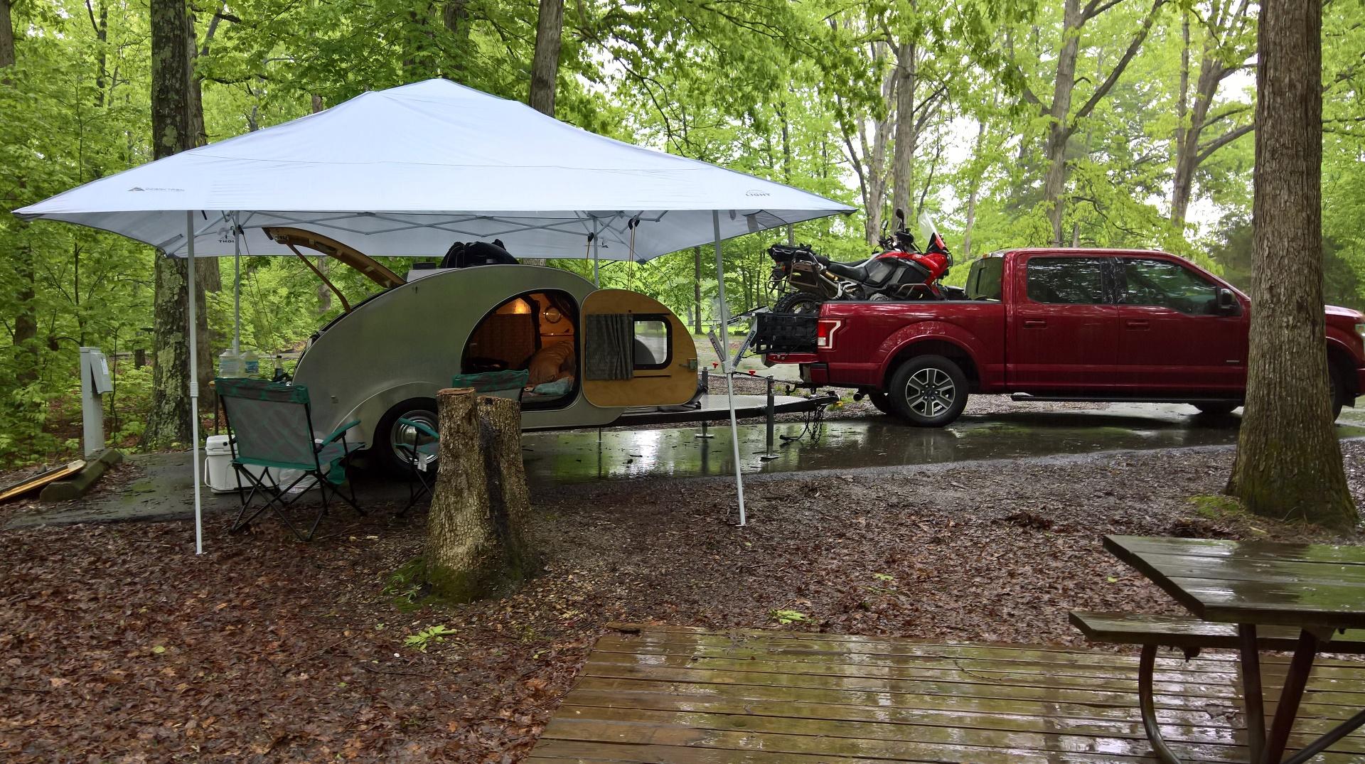

Just so you know, I have been a full-time RVer for several years and the Powerboost was a dream come true. It's magnificent for the lifestyle.
I have 4 different RV's and none of them are beyond the capabilities of the truck.
They range from tiny (teardrop) to small toy hauler (motorcycles) to a 30' but very light for its size. My permanent residence is ~22' and ultra light.
There's so many choices out there. You just gotta be reasonable and match up properly.

Agree!
A teardrop with a Powerboost is the boondockers dream machine. :)
Queensize, Air conditioned, and wonderful kitchen!
