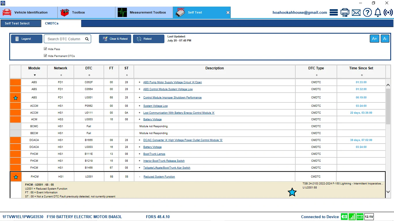

can you post a picture of the toolbox page showing all of the network modules?

Here is a screenshot of the toolbox.

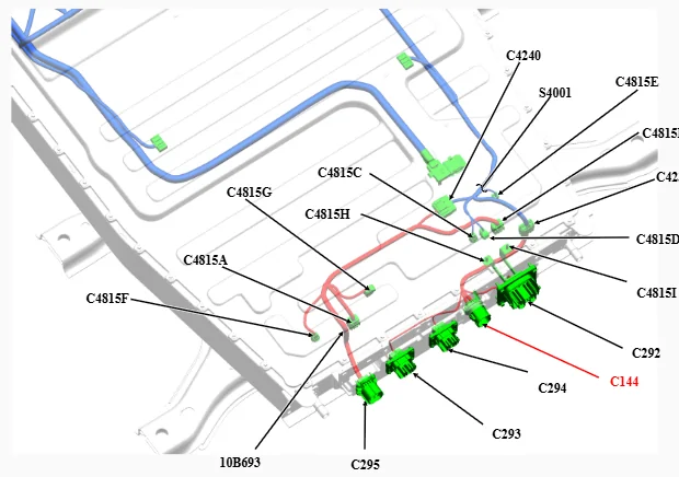

You need to check this connection. C144
THe two modules offline are in and out of this connector.
They are the last two on this chain. So if this connector has issues or the High speed can is not going in it will cuase these two to not be online and thus causing the issues you are having

I agree it looks like the module is unplugged. I take it C144 is on the battery itself?
Correct.. On the front of the battery
