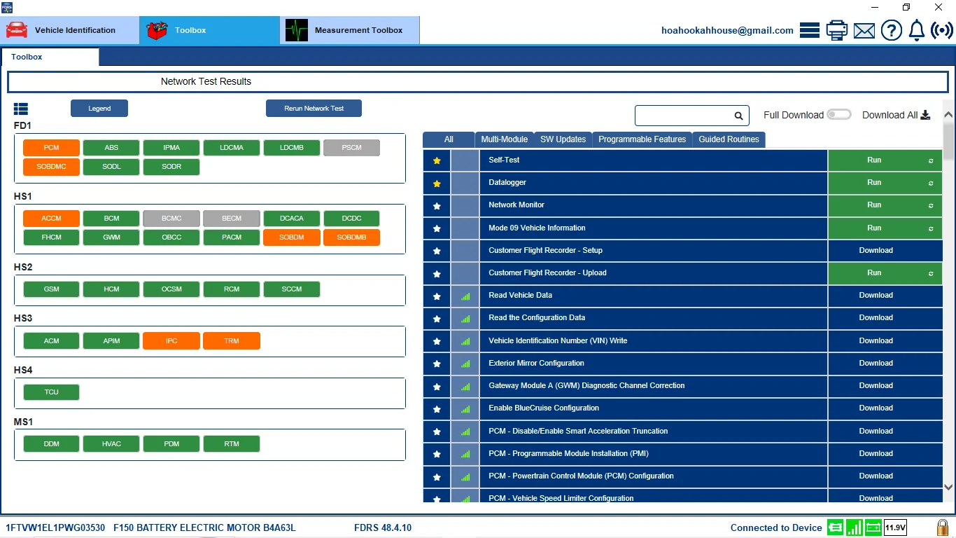

Update: not great. I was able to slide under the truck enough to take the skid plate off and disconnect the cable, sprayed it out with contact cleaner and CDA, re-seated and tapped it in to make sure it was well seated; re ran the network test but no improvement.

Here is a screenshot of the toolbox.
@Jesse-Infotainment
i notice his PSCM is also off Line. My PSCM is often grey in accessory mode. Could he have a power issue preventing those modules from waking up,? since it seems
the truck drove since the dealership touched that plug.

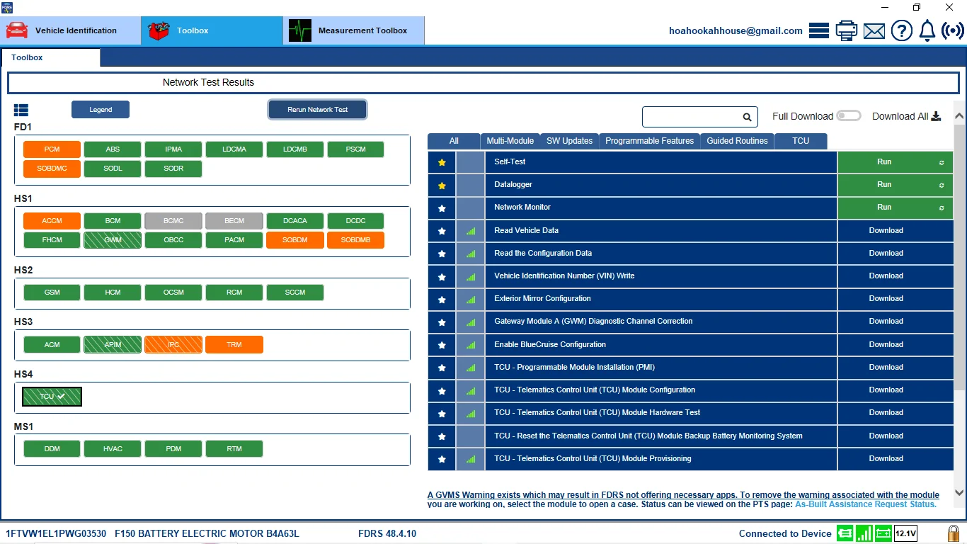

There are other times it is online, like this one:

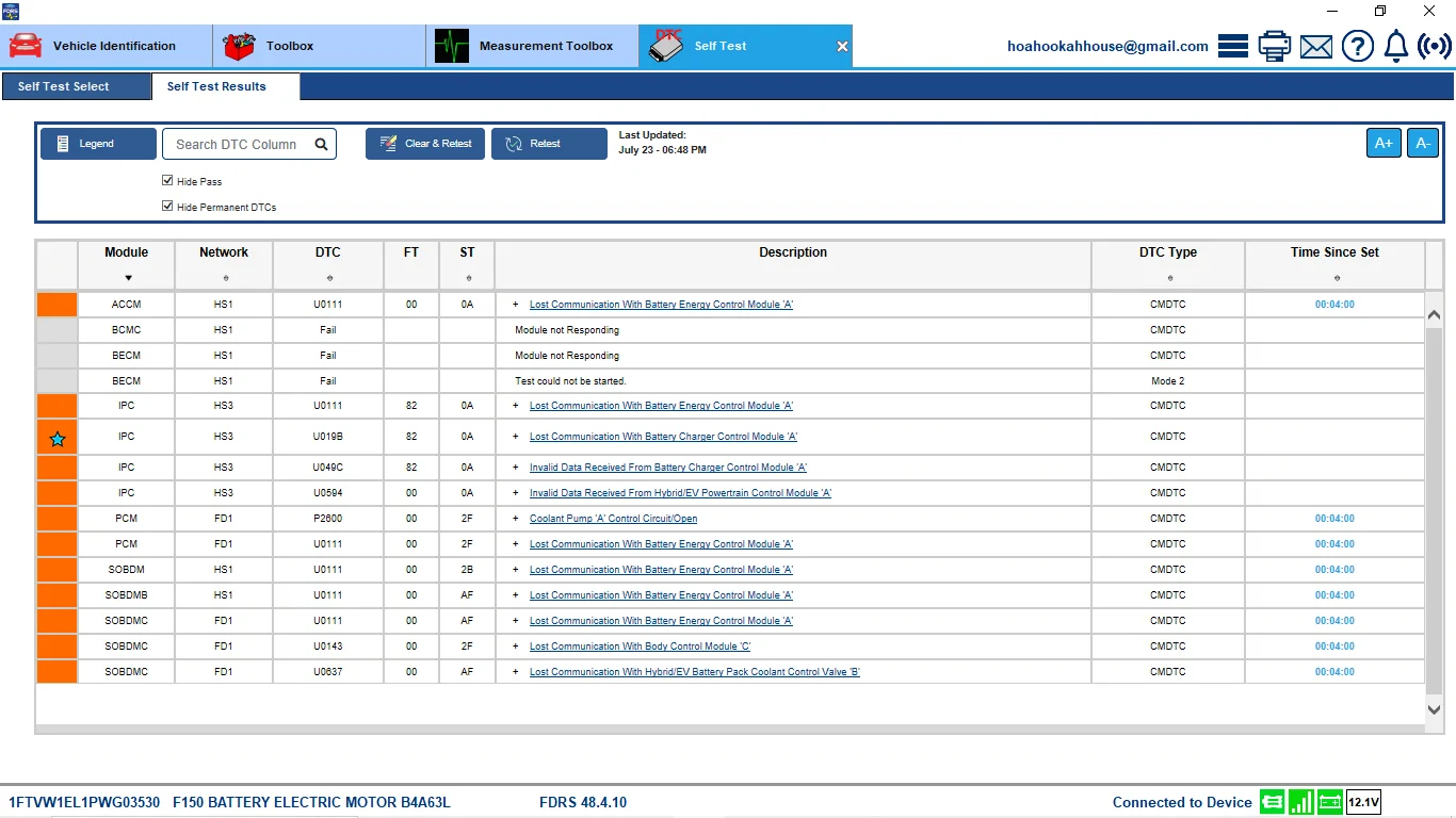

Are you resetting the DTCs when you connect FDRS up before doing anything else? Just curious.
Mar 22, 2023
F150 Lightning XLT
Yes, each time the new board looks like this: All the DTC's are related to loosing communication with the HV system.
Ford F-150 Lightning FRDS and the BECM that is offline: Fix#49 Screenshot (114)
Mike G
Jan 6, 2022
1,915
2,824
N. AL, USA
I’ve seen diagnostics in FDRS for bad cells. But this looks more like a bad BECM. I mean all the loss of comms going to that module is what strikes me. In order for you to know if you actually have a bad cell (or more than one) the BECM would have to be working. That’s what monitors and performs cell balancing. But it looks to me like the BECM itself is what could be the problem.

And I wonder if the BCMC also being offline has anything to do with this.

Just to be sure you may want to verify 15A fuse 146 is good inside the BCMC. That's according to diagnostics in the workshop manual. That's the one for the BECM.
But I've checked for a "fail" in the BCMC in the workshop manual and that's quite literally not mentioned at all. I wonder if the BCMC has gone bad? The BCMC would need to be functional to provide power to the BECM (fuse 146). This is weird.
