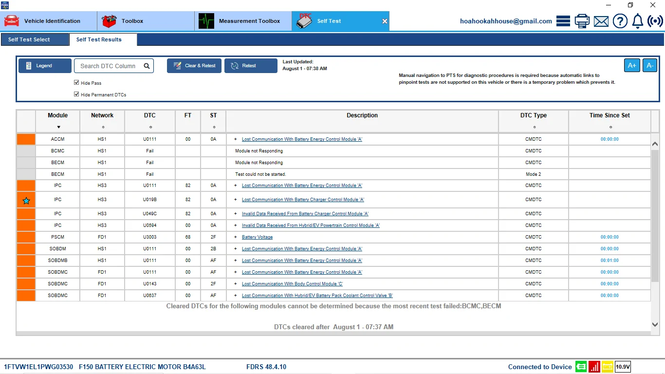

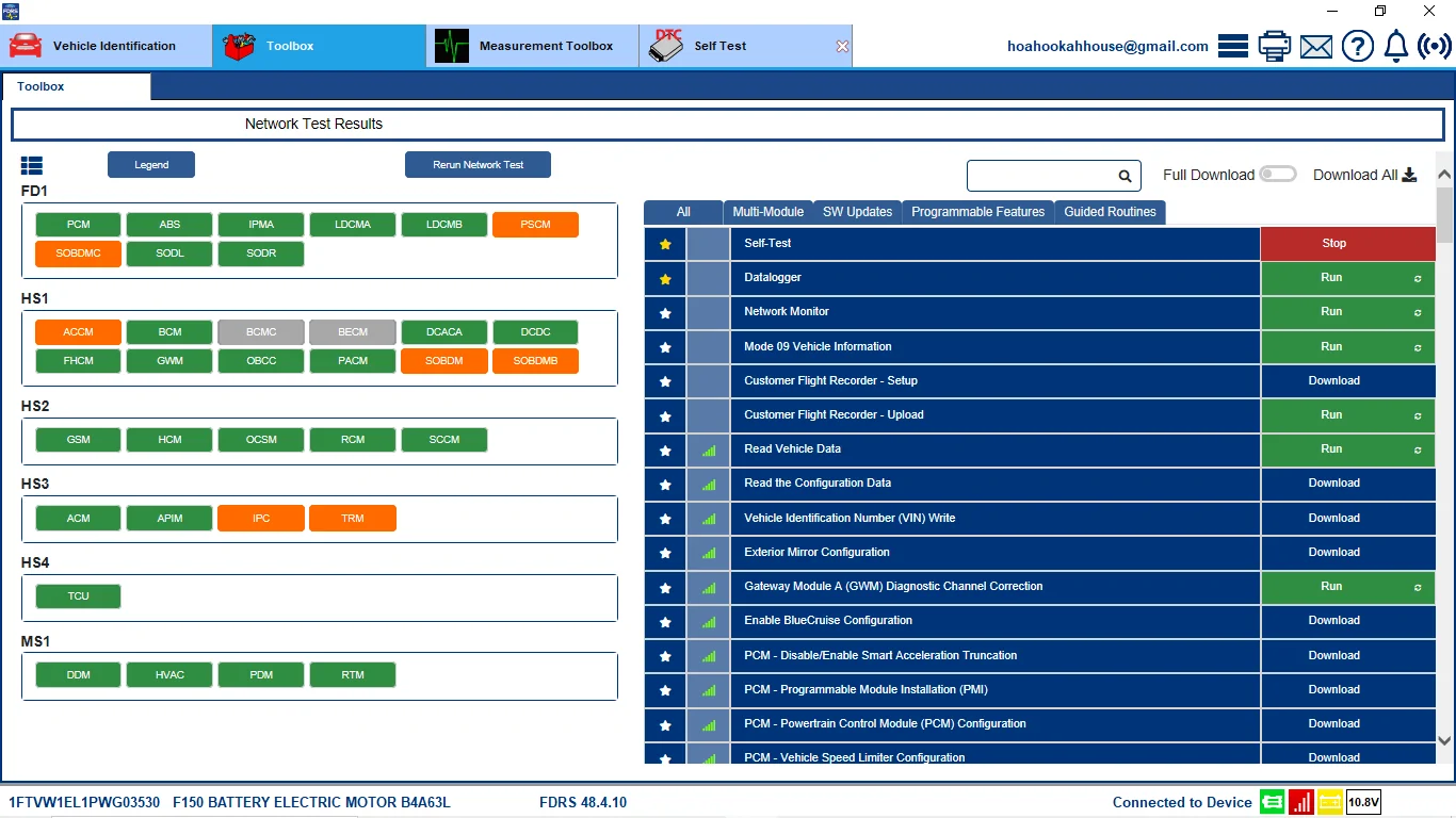

After replacing the battery pack the BCMC and the BECM still will not come back online, I cleared the codes and retest of course a few ties and nothing, I have verified the fuses are ok. I think there has to be a cable issue, there were some wire coating clippings on the top of the old battery pack. This is what the FDRS shows now.

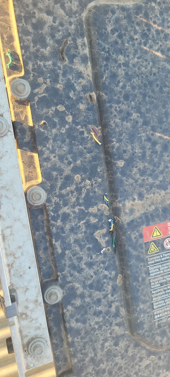

Inspect entire cable run from HVB to related module for animal damage.

I'd look for 12V coming out of the BCMC going to the BECM and work that angle.

The dealer didn't inspect the harness to diagnose that?
It looks like the OP is out for a few days for a medical procedure, he did share a few texts with me today. It sounds like the rodent damage happened because the vehicle sat for a quite a while as he argued with Ford about the repair costs. He is pursuing having the rodent damage repaired as an insurance claim since he has comprehensive coverage. I suspect it will be a few weeks before we get an update.
