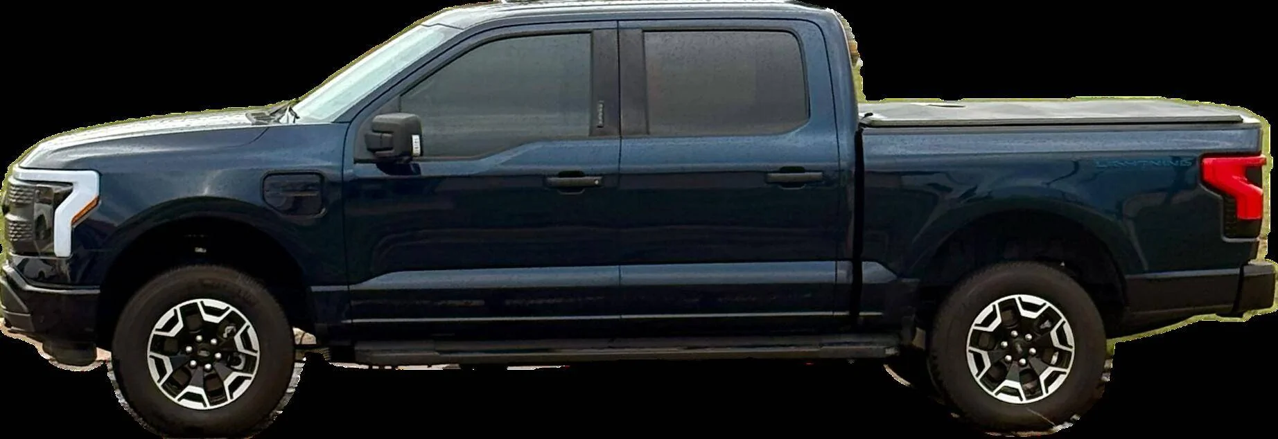

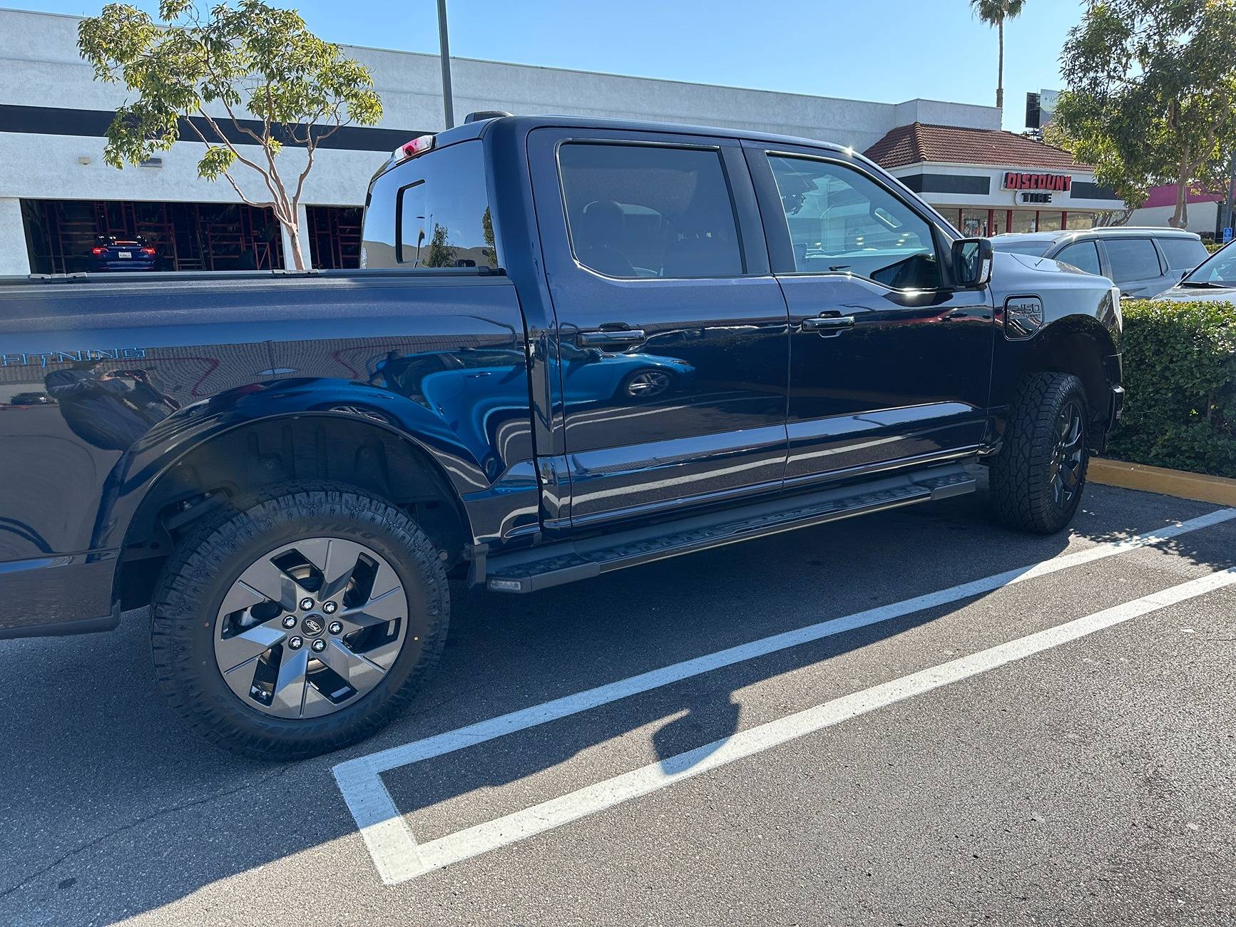

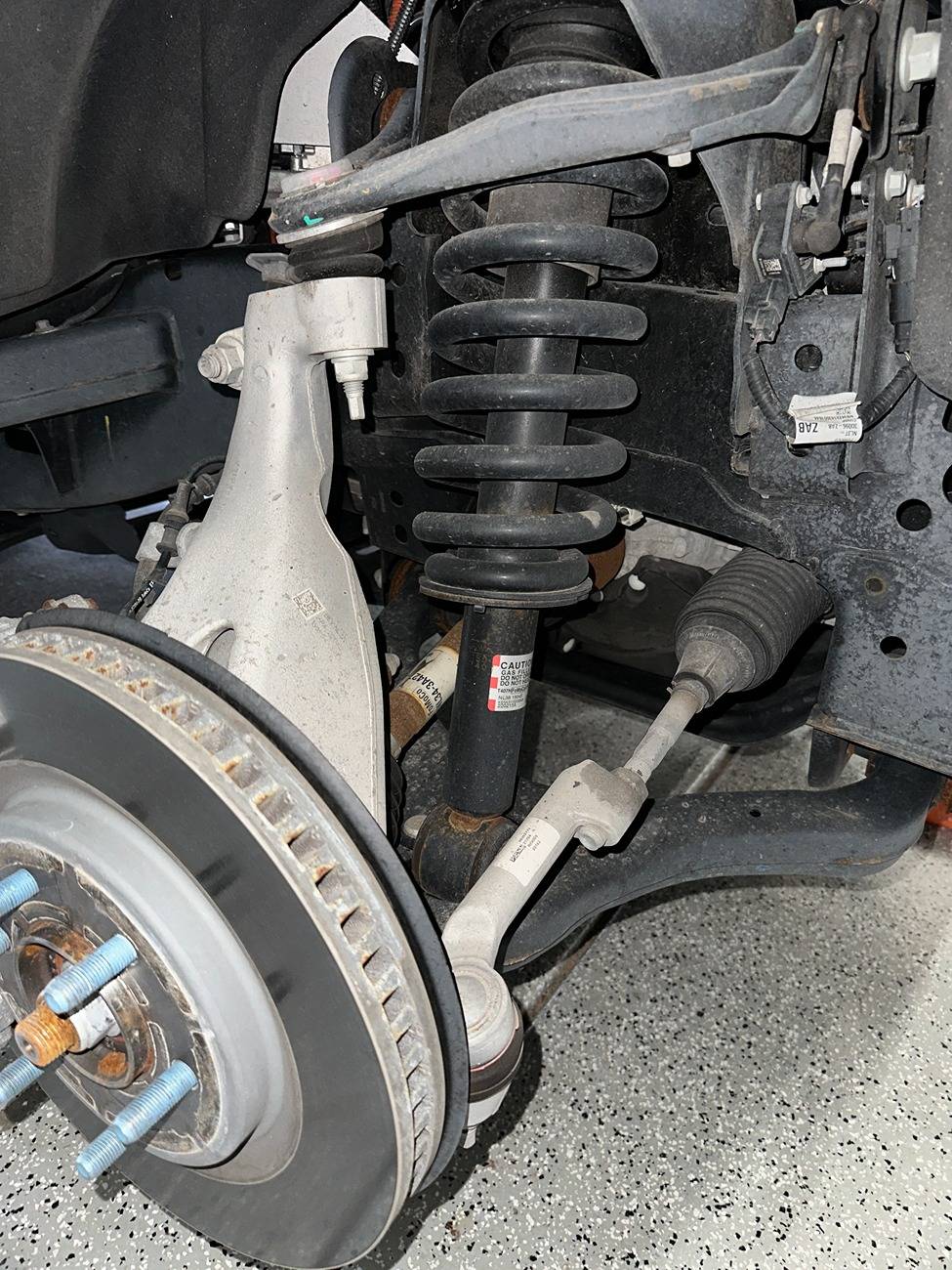

PRO-TRUCK Sport Shock (Front)
E60-35-061-01-10
Snap ring in highest position

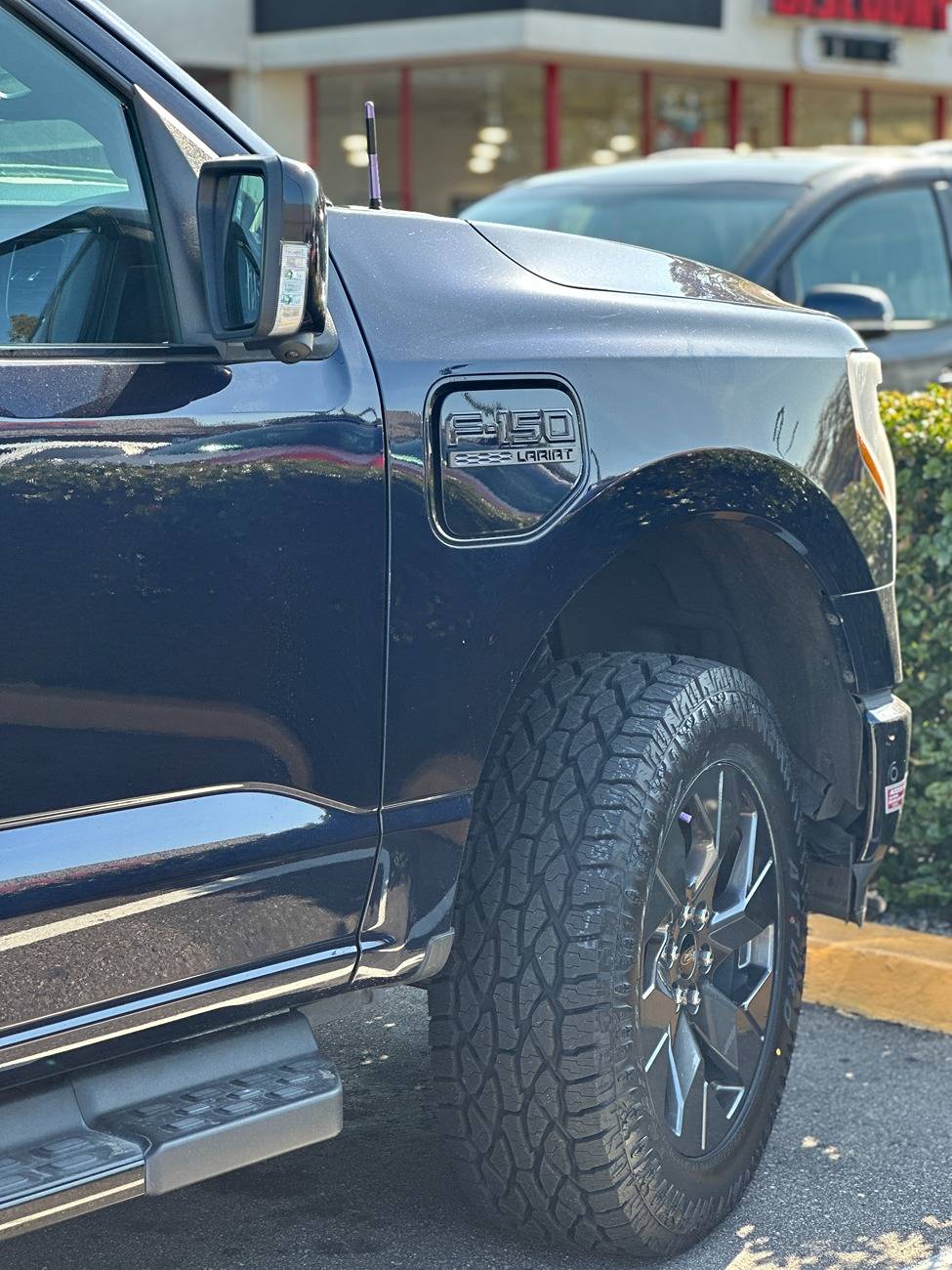

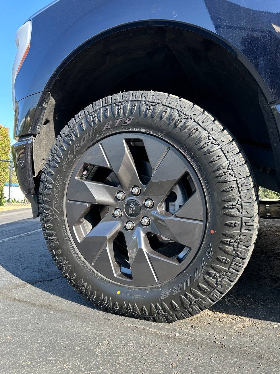

ATTURO TRAIL BLADE ATS
LT285 /60 R20 125Q E1 BSW

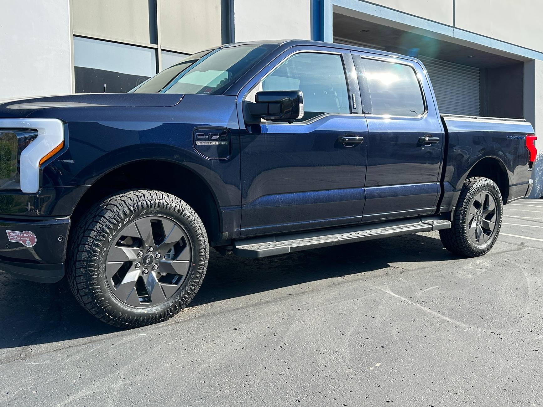

No issues with tire rub. Gives about 0.5" lift (1" greater diameter than stock 275/60R20)

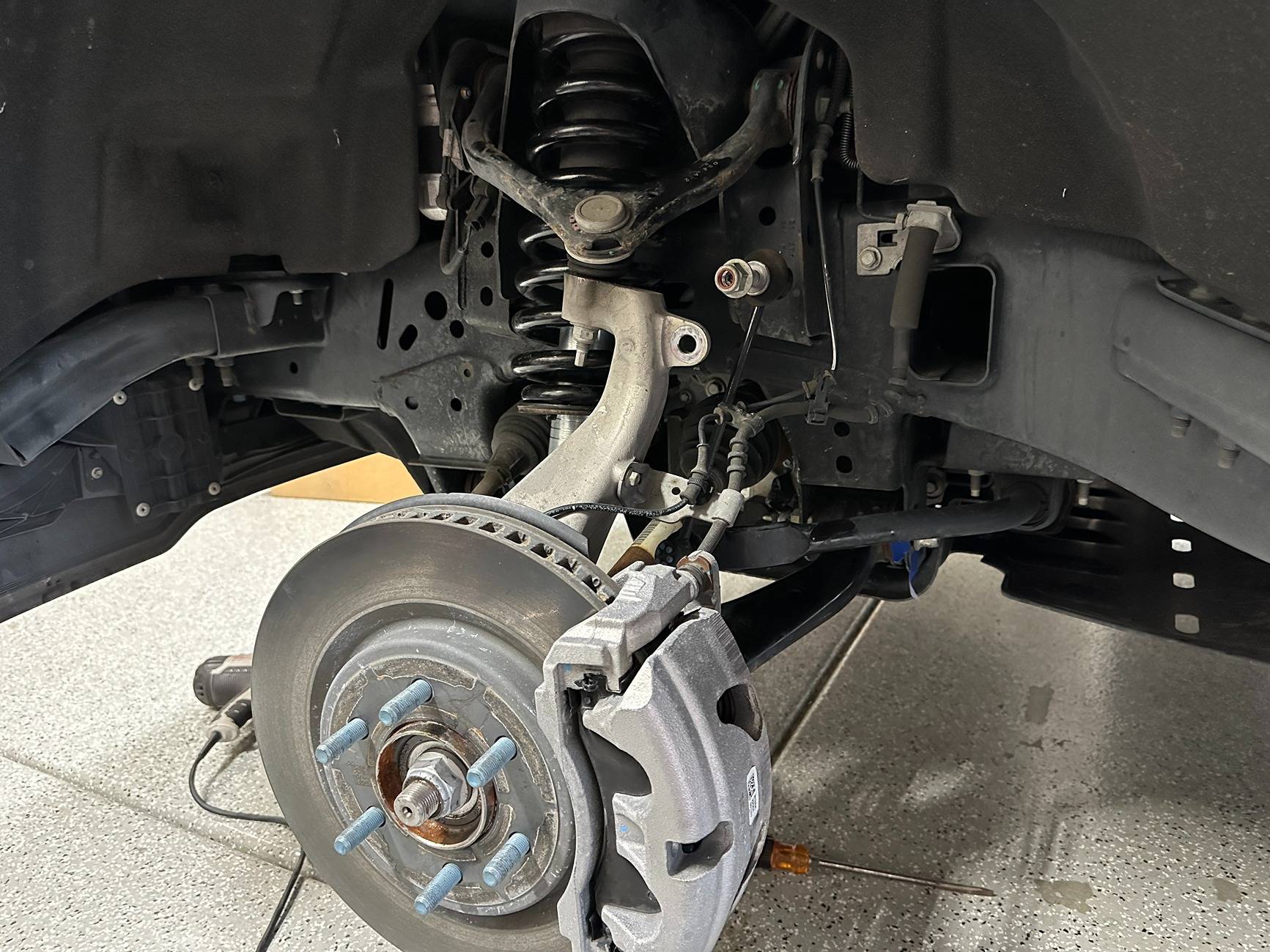

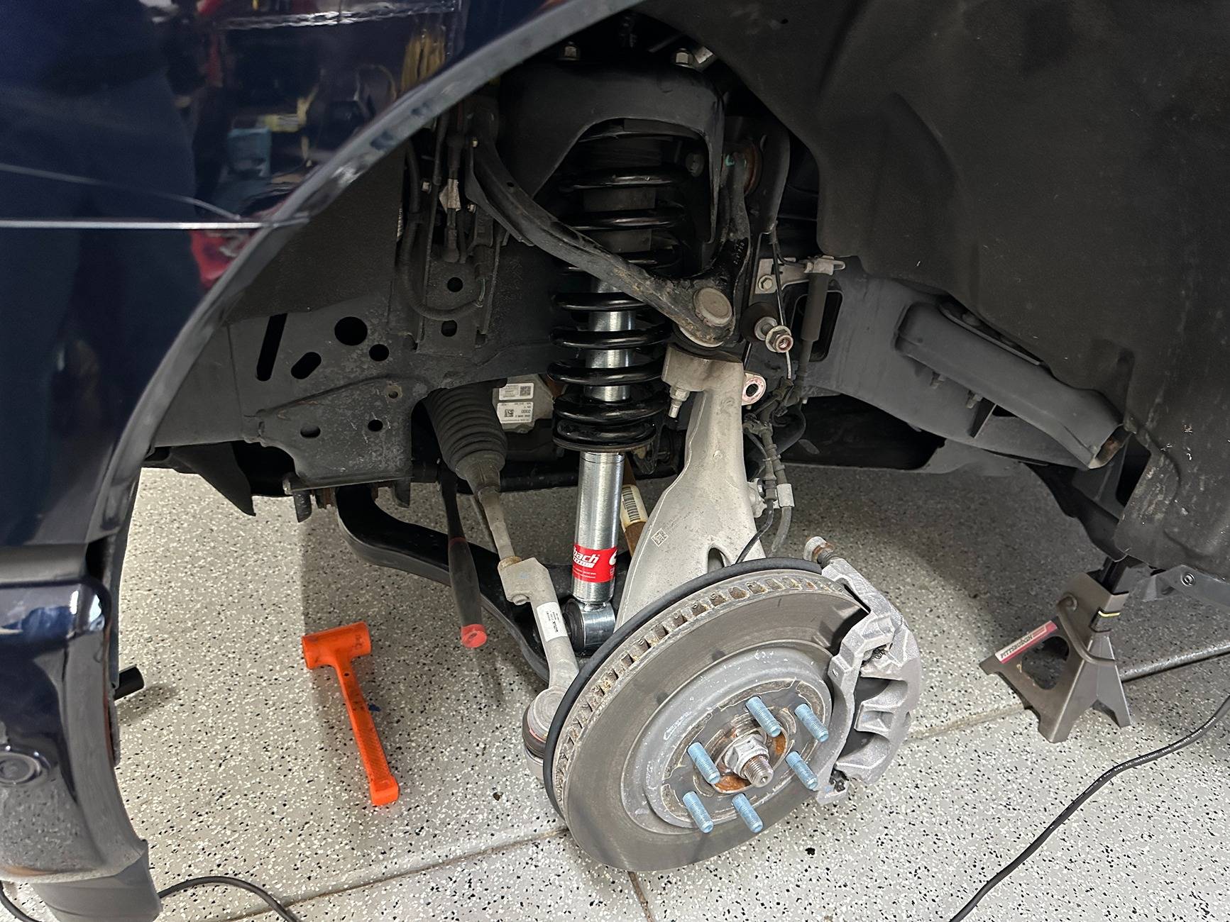

Aside from the terrifying spring compression, it was not a technically challenging project. Needed a thorough alignment afterwards because the lower control arms needed to be dropped from the frame, but it is a major improvement over the stock stance. I did not want to lift or level with a 'hat', this just raises the front by compressing the springs a little tighter. Between the tighter springs and improved shock dynamics, it is significantly stiffer and way less mushy than stock, like a new ride.

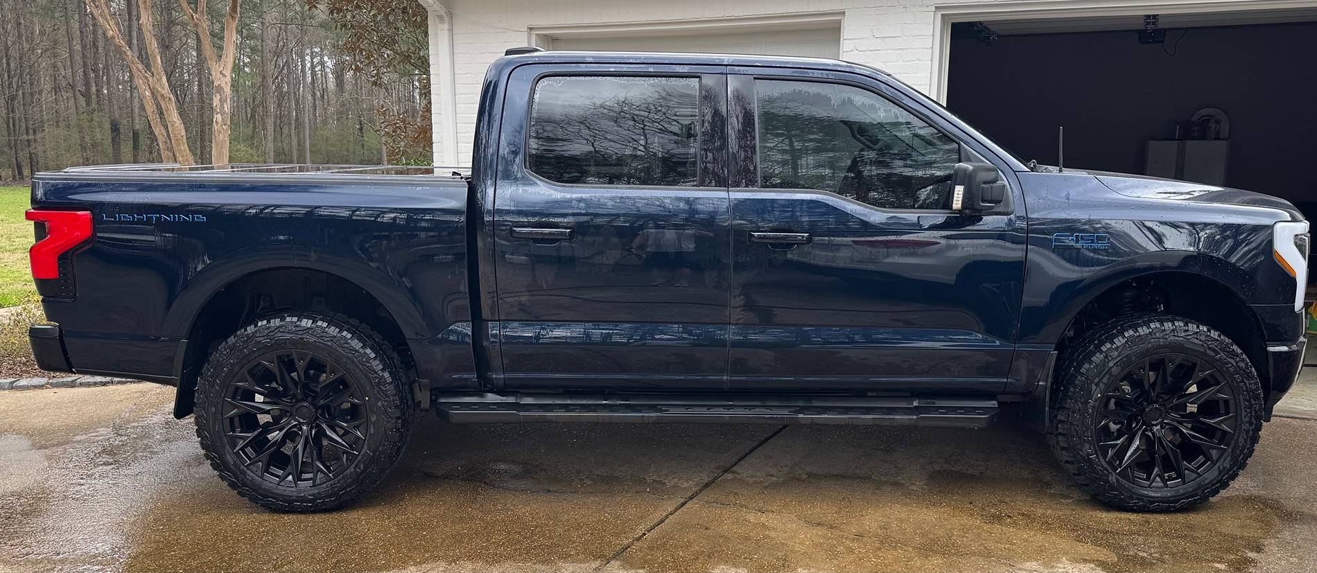

Did the same to mine with the Eibach pro truck front shocks set to the highest ring position (2.6” lift). Spring compression was a fun project. But it really took the floatyness out of the ride, and it’s a bit stiffer now, which I prefer. I have the back Eibach shocks too, but I’m not in hurry to do that. But doing the front makes a big difference.
Since I went with a larger rim and tire than the stock Flash 20in rims (installed 285/55R22) and the offset was different (-18 aftermarket vs -44 stock), I still had to do some trimming on front crash bars & fenders.

I decided on the Eibach system because all the new shocks do is tighten up the springs to push the truck up a little (raise up the lower spring attachment on the shock), there is no geometry changed like there would be with a strut 'hat'.
With the stock wheel and slightly larger tires, no rub, no mods. I wonder now if I could've fit 295s on there, but these feel great.
