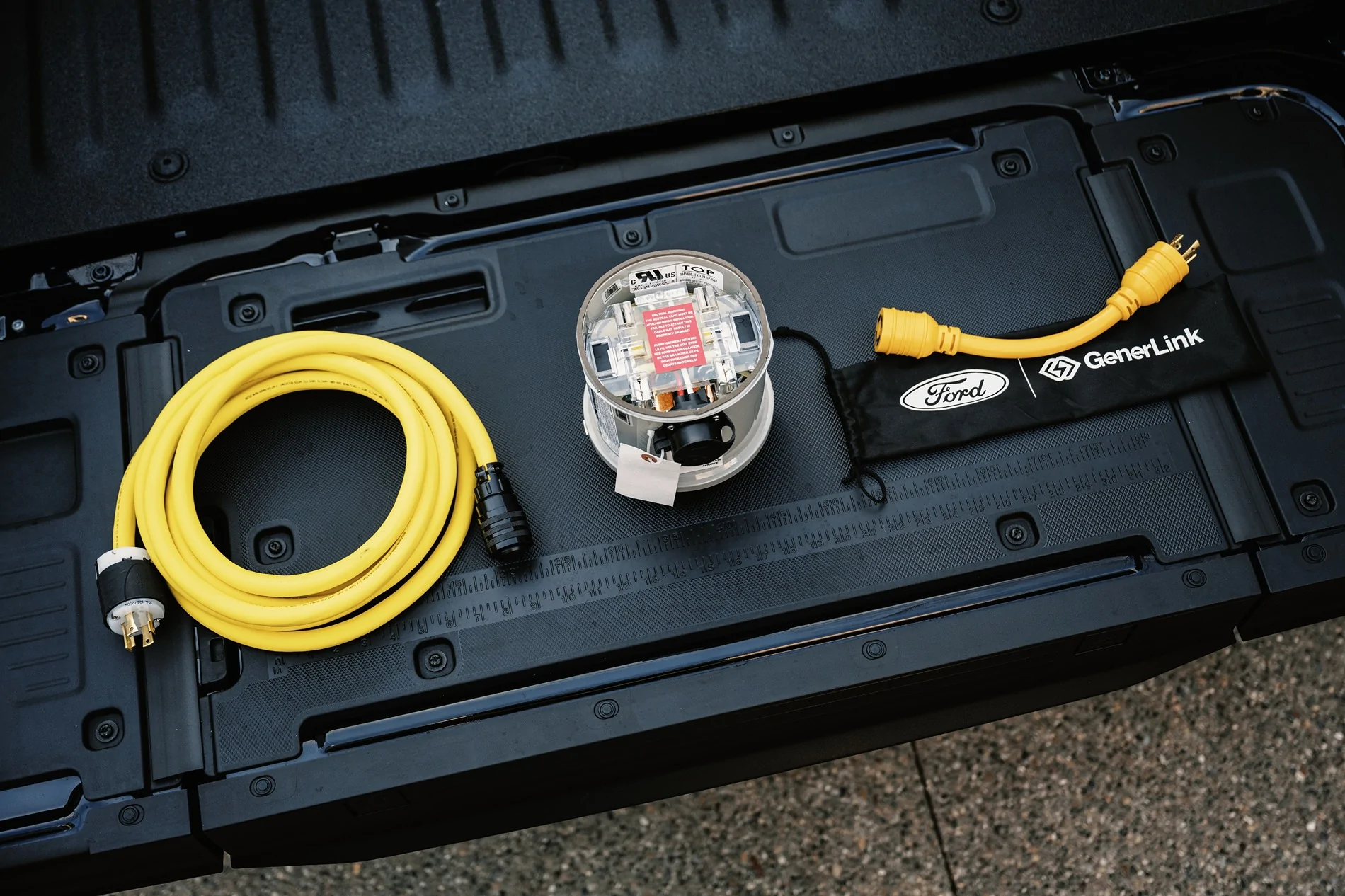

I am curious about this statement and the picture of the 12" cable.
"To solve that, we worked with Global Power Products to develop a 12-inch cable, the Ford Vehicle Connector, that ensures electricity has one connection between the vehicle and the home.
It's a small component with an outsized job, helping keep the system reliable and simple for our customers.
They make it sound like it was some grand electrical engineering feat. But I wonder if they simply disconnected the ground. Or is there some embedded electronic device that prevents the truck's GFCI from tripping while preserving ground.
If so, it would be nice for all the interlock folks if they could just order the 12" cable.

I just ordered mine yesterday. I had to call them to get the Ford adapter and they hit me for another $100 for that. I found a $100 off coupon online (inpower) so it was a wash. My electrician said it should be a one hour charge but we'll see in a week or two after it gets here.
Would you mind using an ohmmeter to check continuity on the 12-inch adapter cable to see if the ground is lifted? The ground is the one with a little hook.
