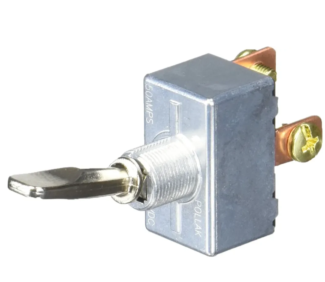

I used a 50 amp rated toggle switch installed in my Generator inlet box to be able to switch the ground either closed or open depending on the bond status of the power source I am using. Label box with a label maker.
Ford F-150 Lightning GenerLink Transfer Switch Compatible With 240V Pro Power Onboard Outlet -- Ford Announcement Screenshot_20260724-093512
Amazon link to toggle:
https://a.co/d/04iaWUxx
I agree that this isn't as safe as using a whip with a lifted ground but I like the functionality better. YMMV.
