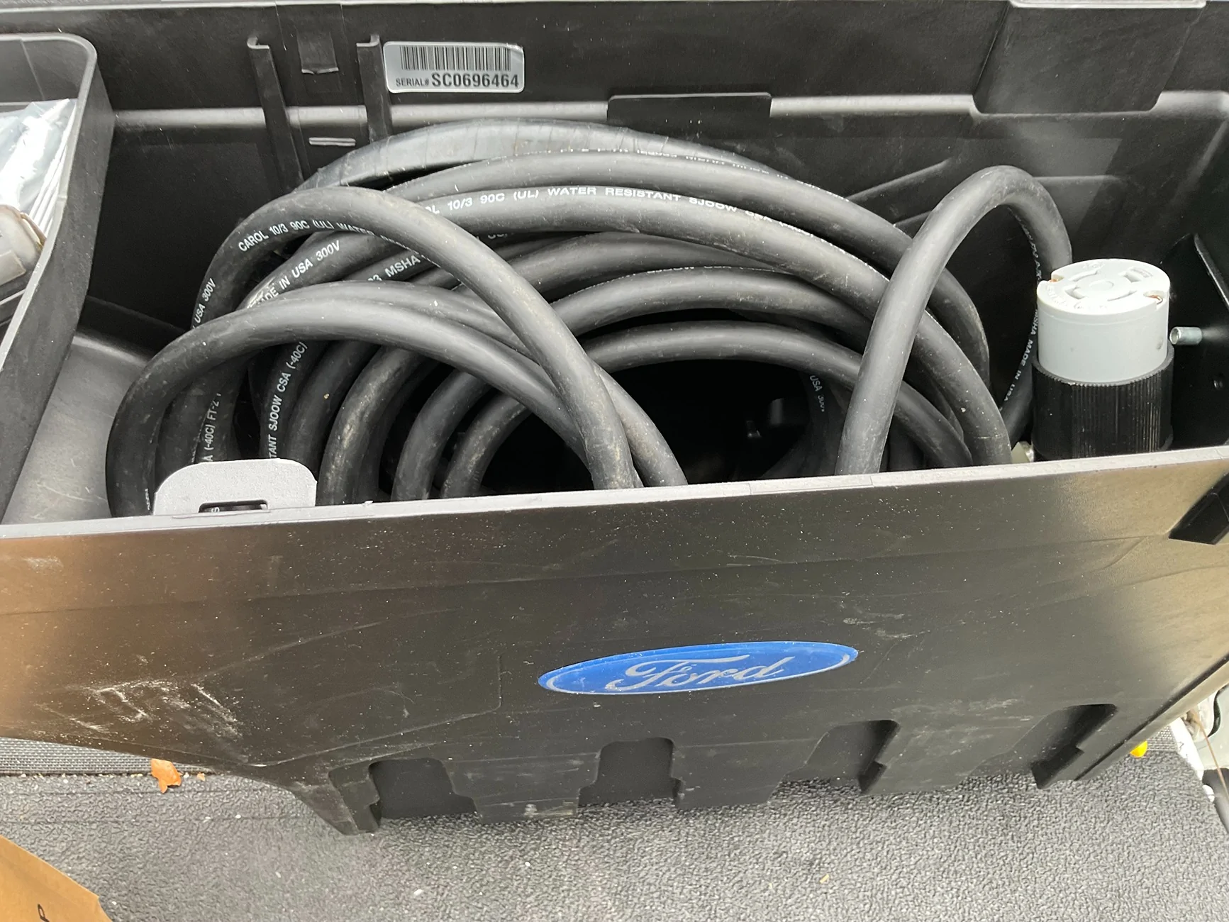

My custom cable lives in my Lightning in the swing out box. I have another standard cable looped over the gas generator.
The custom cable is a 10/3 SJOOW https://www.homedepot.com/p/Southwi...e-Portable-Power-SOOW-Cord-55809799/204632922 probably 40 feet long. Only 3 wires and very flexible.
In another thread, others suggested disconnecting the ground in the transfer switch so the house could be powered with the Lightning. That was a no-go for me in case I was away with my Lightning and the power went out. I would never forgive myself if my wife or adult child attempted to hook up the transfer switch (with the ground wire disconnected) to a gas generator.
I agree. That is why I refuse to modify the house generator inlet and interlock and have ground connected.
If I am not home and wife, adult child or neighbor needs to power the house with the gas generator they can’t miss the cable draped on the generator.
Here is a picture of my custom cable stored in the Ford swing out case in the back of my Lightning. I bought the case with Ford Points

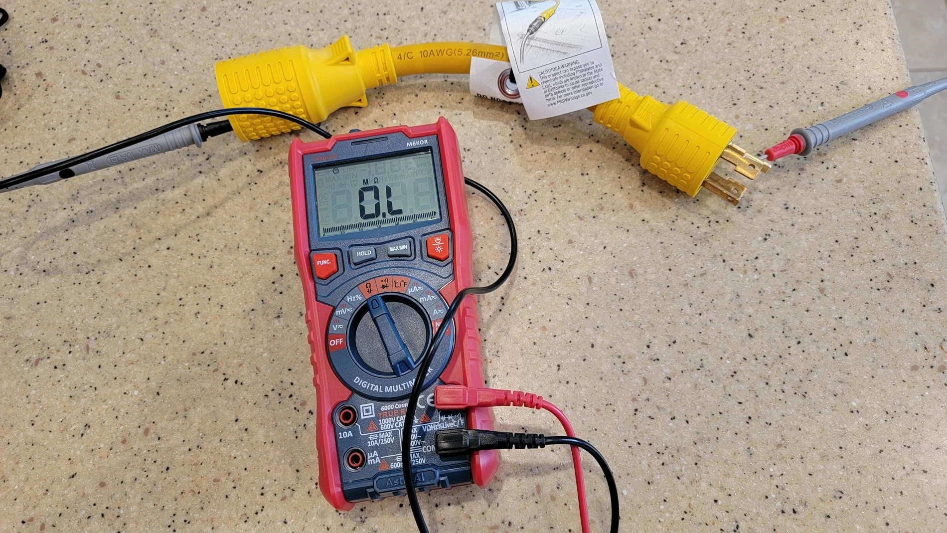

Received the cable today, as suspected the ground is lifted.
Ford F-150 Lightning GenerLink Transfer Switch Compatible With 240V Pro Power Onboard Outlet -- Ford Announcement 1000012136
116
7,461
10,273
$100 cable, or a $25 adapter. Your choice.
