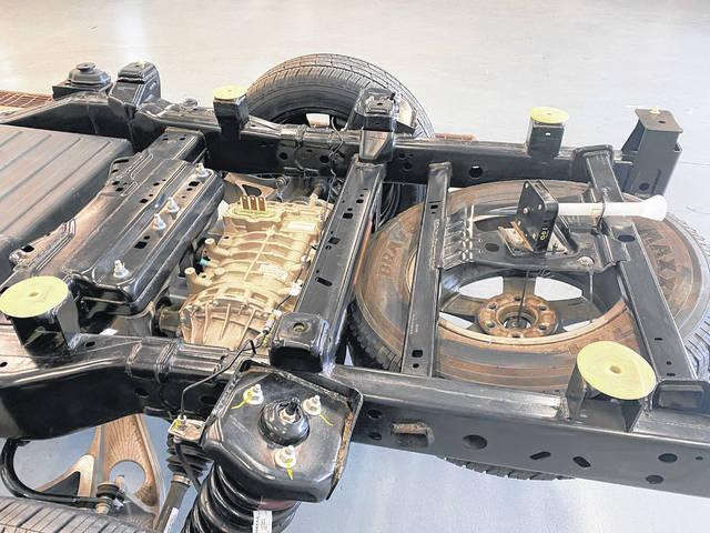

And based on this pic I believe it's possible to mount a gooseneck hitch on it. The base plate mounts to the frame rails and the ball extends into the bed. As long as the motor sits below the top of the frame rails, and the shock mounts don't interfere, it can be done.............IMHO
Someone just needs to get their truck to B&W Hitch

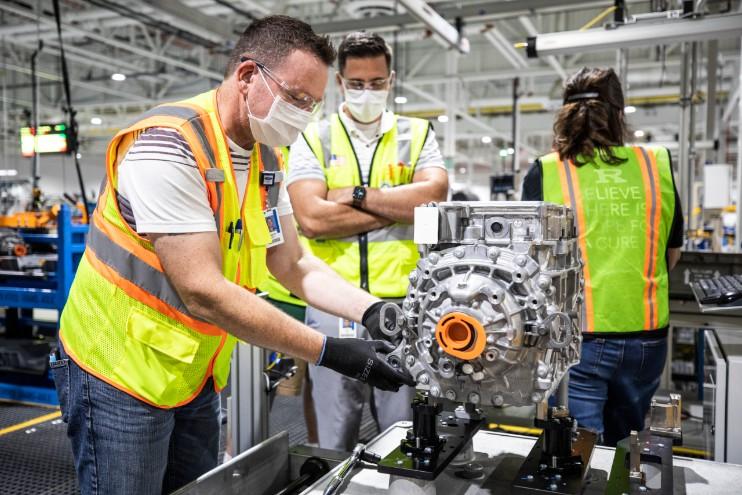

Here is the rear emotor by itself:

But there are additional electronics/ cooling that mount on top of it.
Ford F-150 Lightning Good luck everyone. Looks like I’m getting a Super Duty instead of a Lightning. cq5dam.web.881.495[1]
Ford F-150 Lightning Good luck everyone. Looks like I’m getting a Super Duty instead of a Lightning. ford-van-dyke-electric-powertrain-center-images[1]

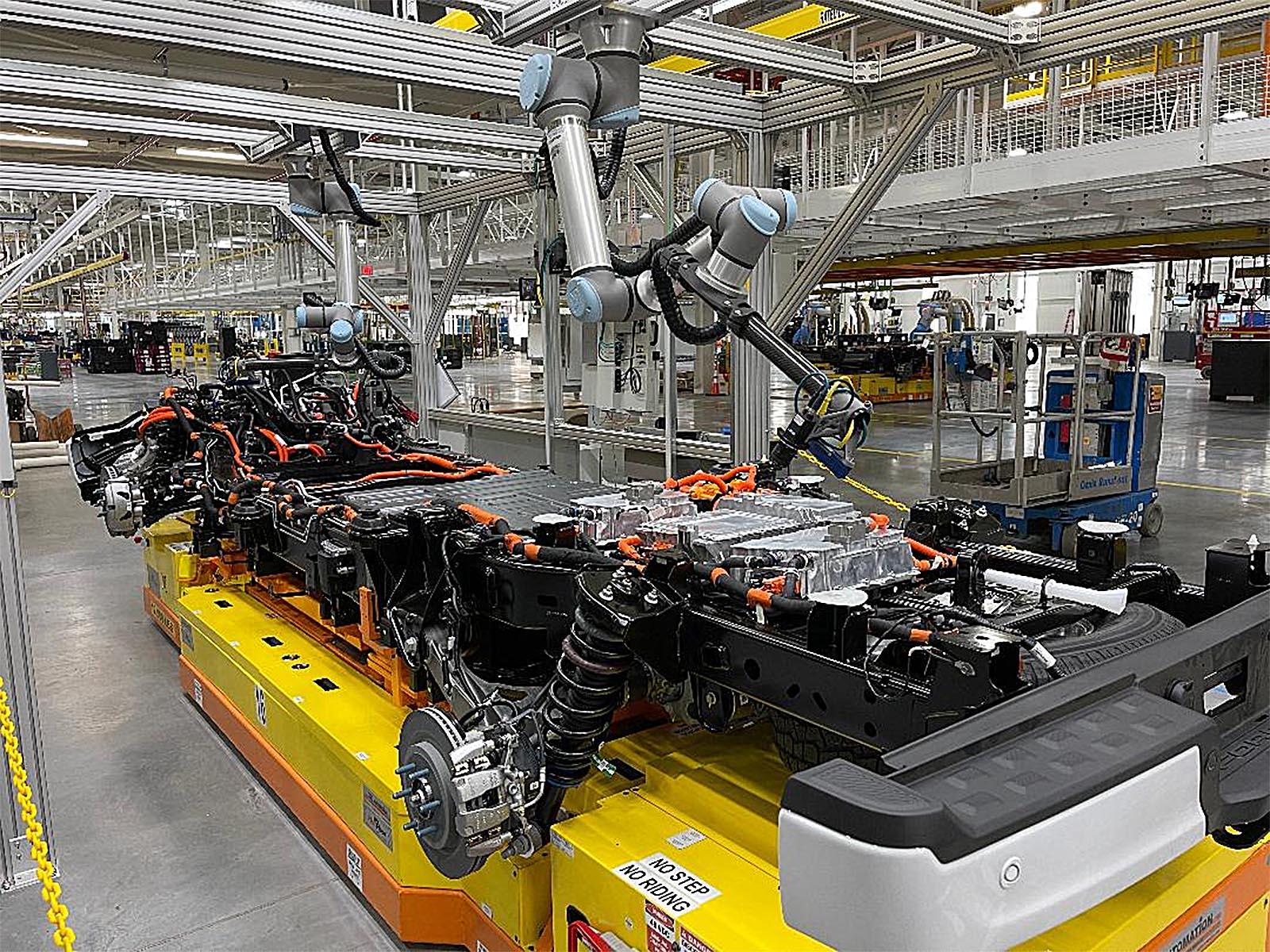

Parts of it sit above the frame rails.
