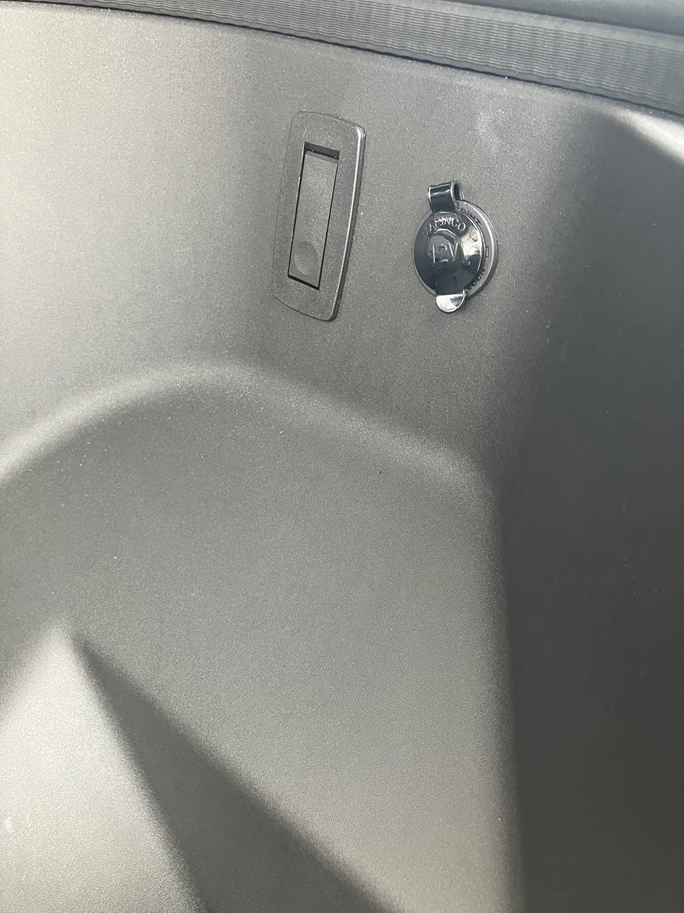

Hi:
I've searched and searched and I can't find anyone who has installed a 12V outlet in the frunk area. I'd like to install one for my 12V fridge.
I took a look at the fuse box in the frunk area, and all of the exposed terminals are constant 12V power. I'd like to avoid fuse taps in the fuse box if possible and I'd like a switched ignition tap to power a relay connected directly to the 12V battery, perhaps via a T-Tap. Ideally the delayed 12V line that powers the 12V outlets in the cab. I'm trying to avoid running a wire to the cab through the firewall if possible.
Any help or insight is appreciated. Pic for attention. :)

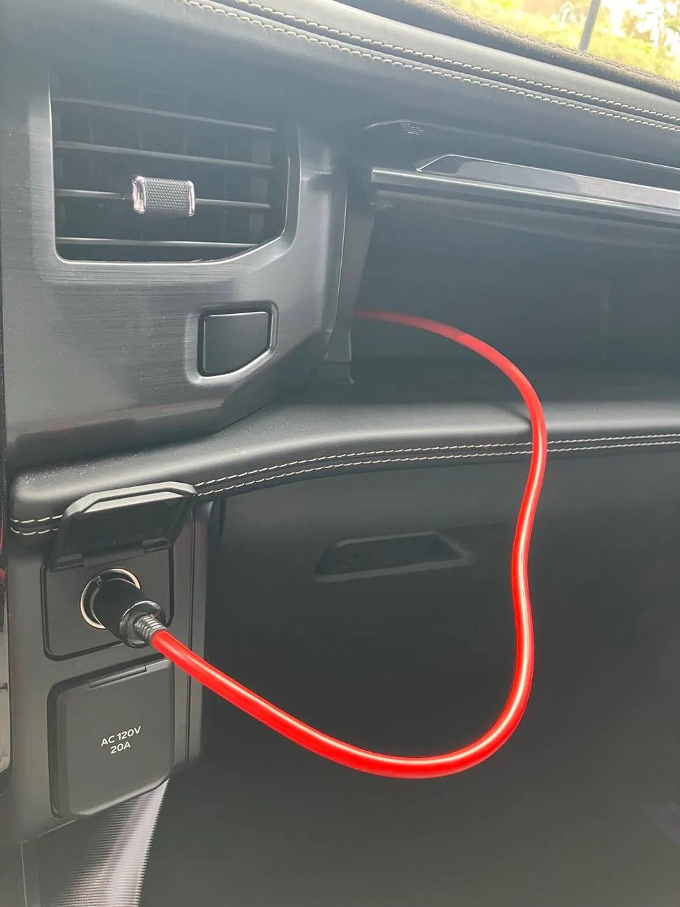

I’m powering my Ecoflow cooler in the frunk with this setup:
Ford F-150 Lightning Good place in frunk to get a switched ignition +12V tap? (Frunk 12V outlet installation) IMG_1408
Ford F-150 Lightning Good place in frunk to get a switched ignition +12V tap? (Frunk 12V outlet installation) IMG_1407
